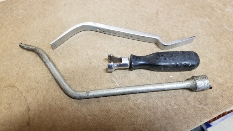

First 2 years wife and I were married (41 years this week), we were flat broke. I took in brake jobs about 3 weekends each month. 2-4 per weekend. I would have been lost without those SnapOn spring tools. I have spring pliers too but always found them worthless.
Well Happy Anniversary Mike. I have similar no name tools like those, they help for sure.
