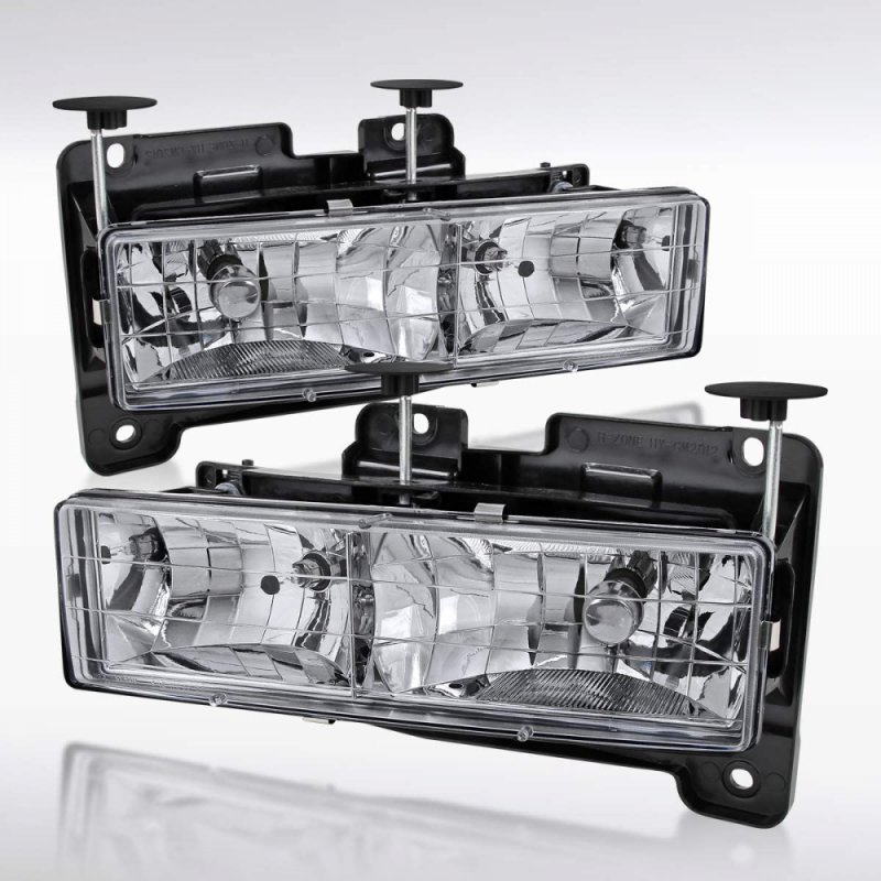

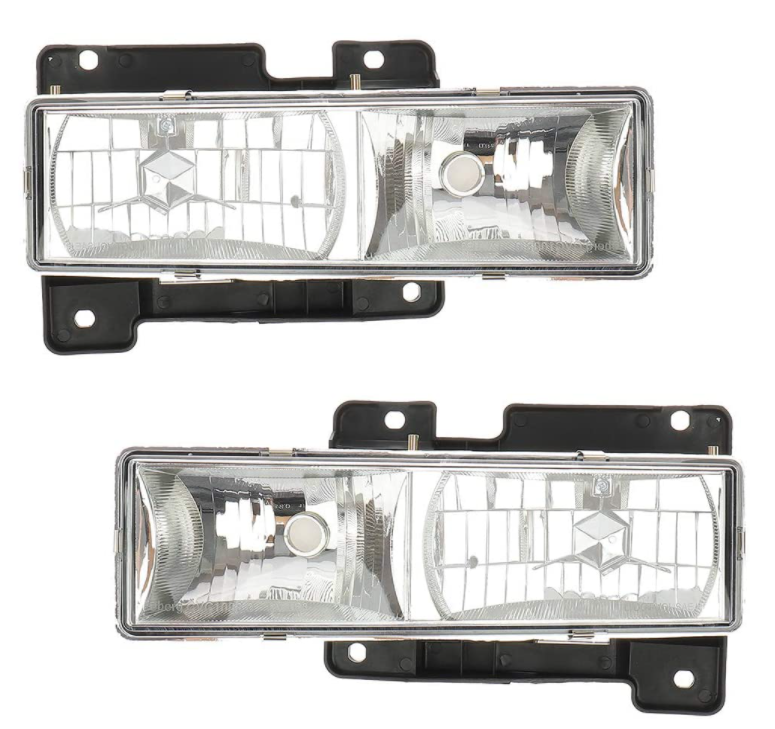

I have the glass lens style headlights. I bought them from LMC several years ago. I have not had any fitment issues with the grill. Certainly, I am not thrilled with the quality of the plastic that the brackets are made of. Its a little flimsy compared to the OE stuff. Fortunately, I have not had problems with them bouncing or anything. They have had halogen bulbs in them until recently.

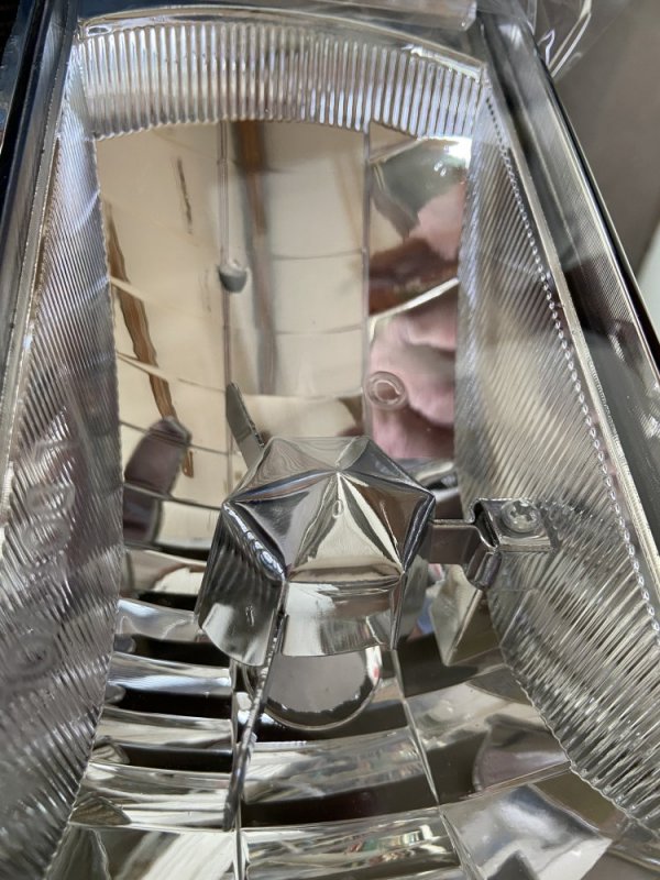

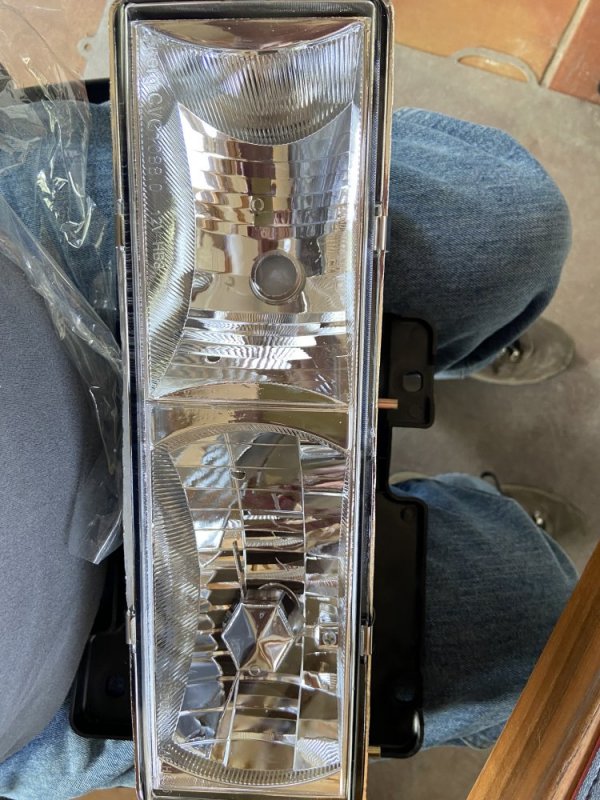

I have done a fair amount of reading and research into the aftermarket LED headlights over the last few years. I watched a lot of video reviews and comparisons. The Hikari LED lights have some of the best reviews and they do not glare oncoming traffic. I bought a few sets for different vehicles I have currently or owned in the past. I am very happy with them, so I bought a set for the glass lens housings in my gmt400. They have a very distinct cut-off line and they are a white color, not yellow or blue. They also develop a lot less heat than halogen or HID.
I looked into HID conversions on many occasions for different vehicles because of my dissatisfaction of halogen. Its not easy to find a headlight housing that works well with HID for the GMT400. Typically HID use a projector style housing. Like BigT has noted you need a reflector cup if they don't use a projector. Even these style will not always prevent the glare to traffic in the opposing direction.
