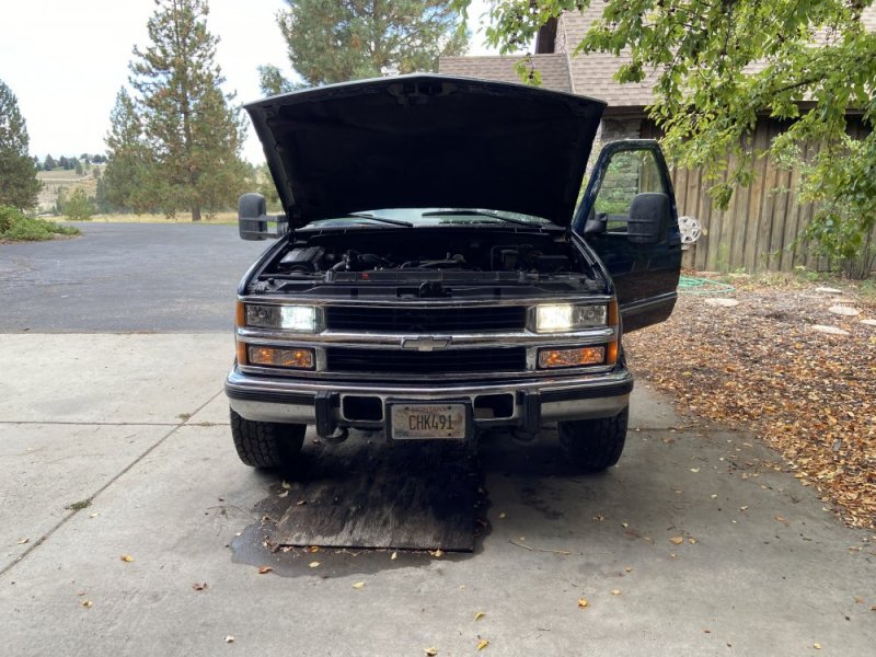

Have not disconnected DRL. Have not swapped bulbs. At this point, I am afraid to touch anything as it has only made it worse….and I was following ALL the INSTRUCTIONS from here.
OK so I eliminated the suspect 3-way splices and used heat shrink crimp splices. Did one at a time so as to not mix anything up. Also change the crimped ground ring terminal from the relay on the driver’s side (passenger side ring terminal were changed previously). No Change in the color of the passenger side low and the lights went crazy on me. For a bit, the High beam setting would just have the Lows on and the Low setting would have all 4 on. Then the lows would not shut off when the light switch is off. I backed off the negative battery post bolts on the driver’s side and the All 4 on High at Low beam setting went off. Now I no longer have All 4 on High, just Lows or Highs. I should have left well enough alone. WTF is going on?
