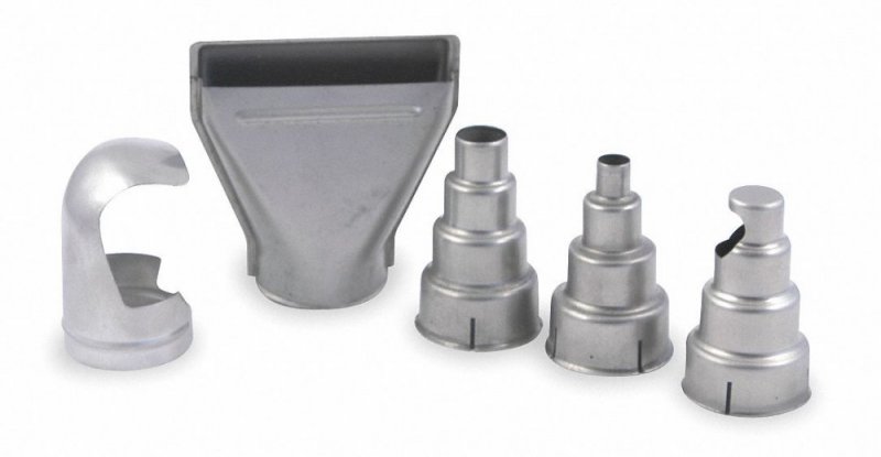

What heat gun tip are you using on your heat gun when using solder splices? They use them at work when making our lights and when they do they use the hooked tip so it envelops the splice, which would make it more of an oven situation at that point I suppose and you could probably get away with a lower temperature setting on the gun.
In the picture below, it would be the tip on the left.

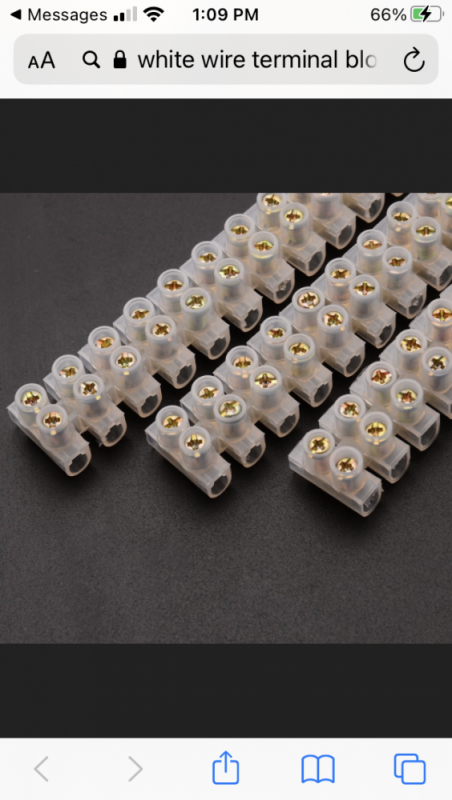

I sometimes use these. On one side run jumpers from one terminal to the next, then on the other side wires can be connected to go to different appliances from the same circuit.
I don't have that tip.

I have the electric heat gun and all the other tips, just not the tip referred to.

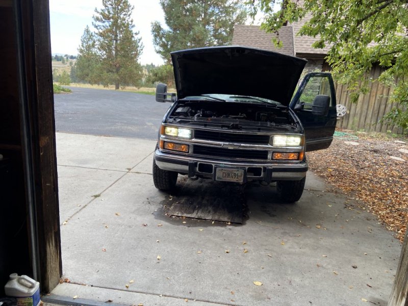

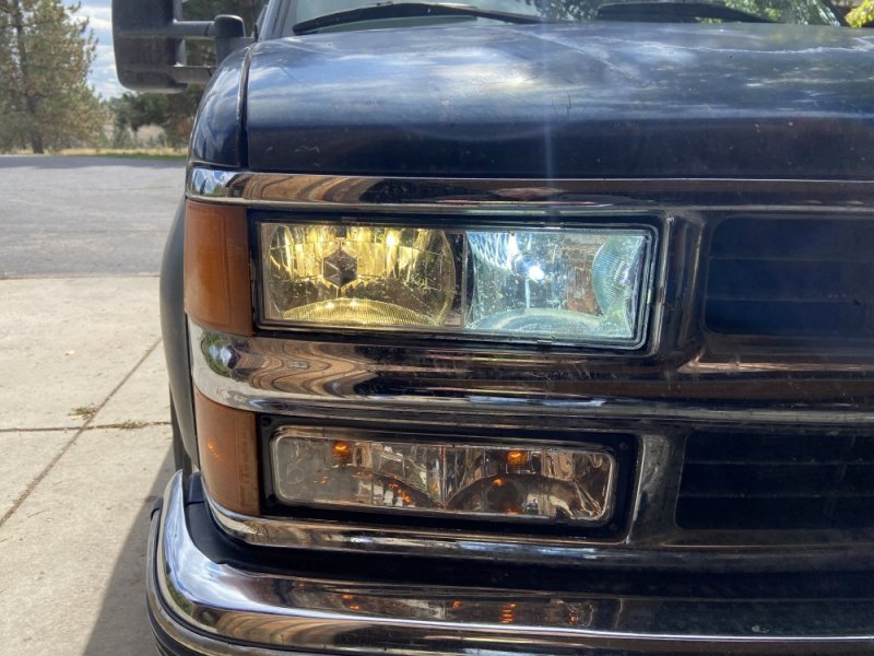

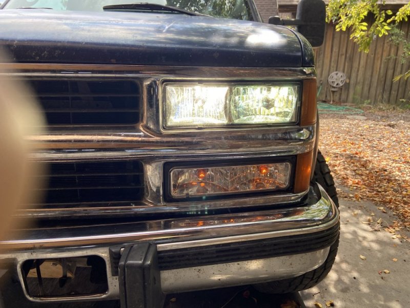

OK so I eliminated the suspect 3-way splices and used heat shrink crimp splices. Did one at a time so as to not mix anything up. Also change the crimped ground ring terminal from the relay on the driver’s side (passenger side ring terminal were changed previously). No Change in the color of the passenger side low and the lights went crazy on me. For a bit, the High beam setting would just have the Lows on and the Low setting would have all 4 on. Then the lows would not shut off when the light switch is off. I backed off the negative battery post bolts on the driver’s side and the All 4 on High at Low beam setting went off. Now I no longer have All 4 on High, just Lows or Highs. I should have left well enough alone. WTF is going on?
Sounds very similar to this guy’s problems:
Do I need new relays?
