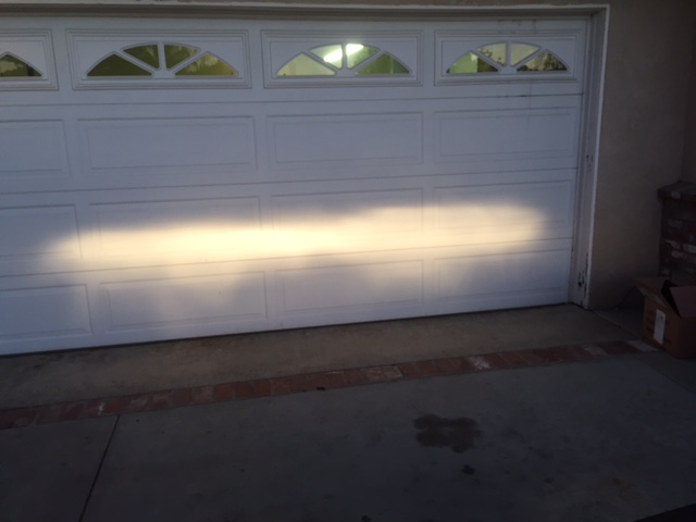

OK I ordered a set of these for my son Colby, because the housings on his '94 were basically yellowed over and produced such a worthless light spread it was like driving without lights.

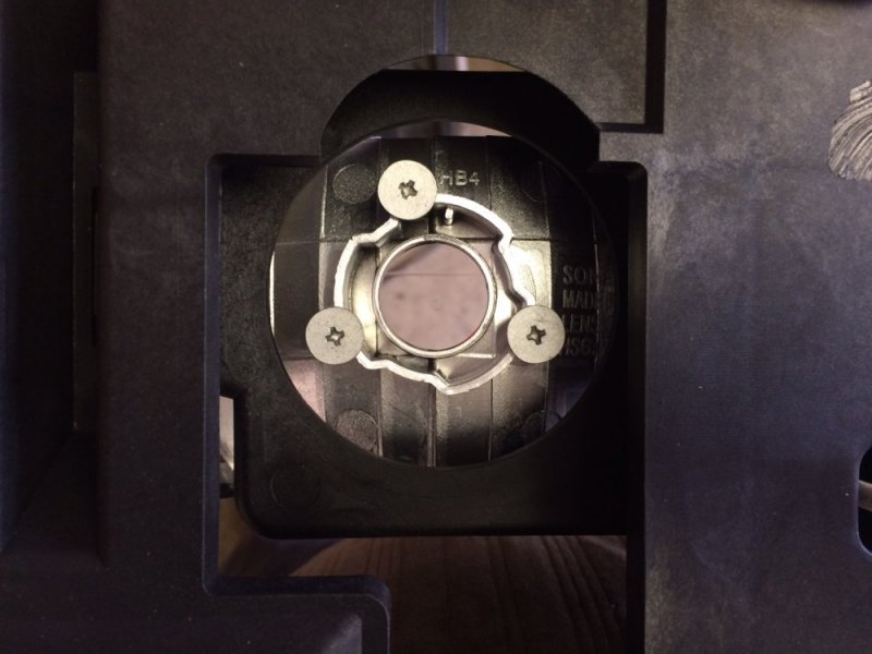

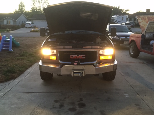

The lights arrived and I am very encouraged by what I see. The most important thing is the design of the deflector cup on the LO beam. Bad designs have a flimsy cup attached to the roof of the housing. Heat from the bulb eventually causes these to droop down. Better designs have the deflector cup attached to the rear wall/mirror of the housing. Even better, in this design the bracket metal is positioned vertically making it very unlikely for the deflector cup to droop down in the face of bulb heat. There's not as many vertical hatching lines, but I can live with that. They came with halogen bulbs in them, but we have a HID kit ordered. I will do the "Matuva Mod" so the housing sits flush with the grill.
