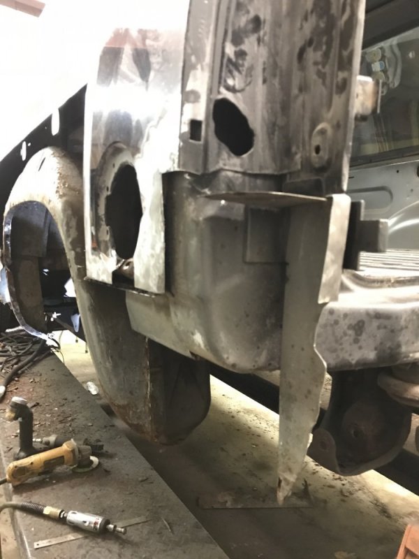

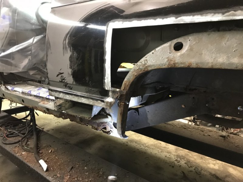

You might as well tub the wheel wells now![]()
That's why it's called the Rust Belt, Nate. We have it just as bad out here on the Plains.
Rust free bodies are becoming rare.
They get crushed here weekly. Many with no rust.
