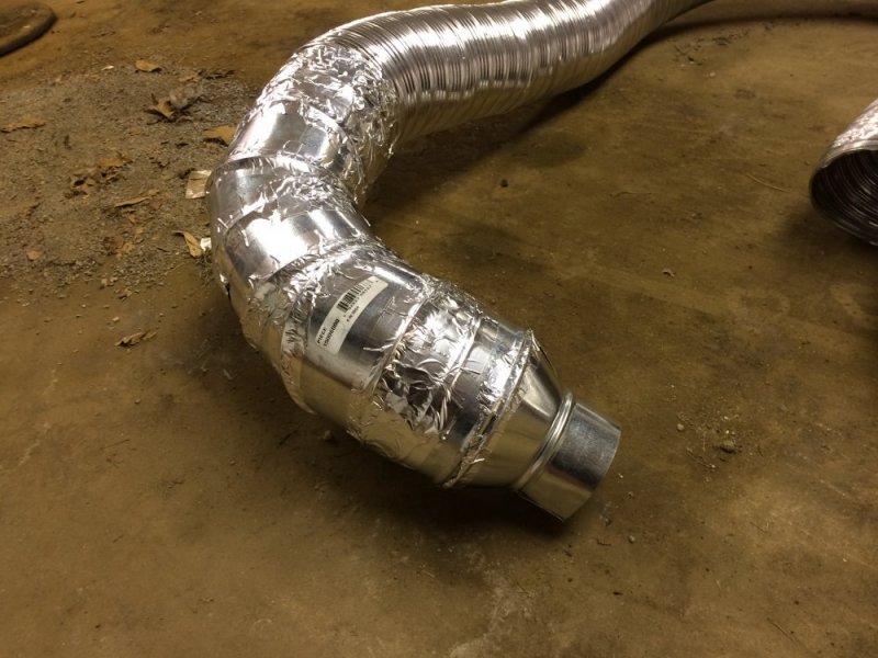

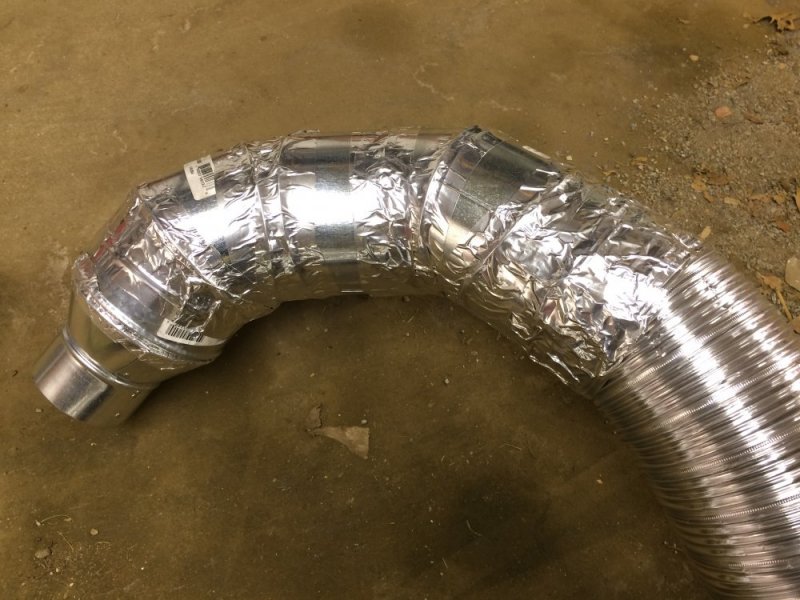

In preparation for the next dyno trip I made a new elbow assembly for the exhaust vent hose. This should be more durable than just the flex tube at the bend. IMG_7542.JPGIMG_7543.JPG
I think I'd have considered hard pipe. You can get 30 ga in 5&10' lengths.
Yeah that would definitely be more durable. When I was coming up with my plan I was looking for something readily available and something I could throw in the back of the Tahoe. Like last time I went, I had 2 people with me, so I needed the back seat to be folded up. So that only left me with the little bit of space behind the seat for carrying something. I'll see how this holds up. If it fails again then I guess I need to invest in real exhaust vent hose...which wouldn't really be a terrible investment since I could use it in the barn at home to exhaust the gases if I need to run the engine with doors closed.
Aluminum flexible dryer vent duct should work just fine, Nate. After all, it carries away the heat and exhaust from gas dryers with no problem and I bet that is just as hot or hotter than your exhaust out the tail pipe is.
Should be fine. Use pot holders after any runs if you need to move it.
If my dryer hit 1550 degrees F my EGT's get to now and then I am sure the Fire Department would be involved...
I'm not worried about it being durable enough in regards to the temperature, I'm mostly concerned with it coming apart at the crimped seams from the force of the exhaust flowing through it....or just from excessive handling. If it comes apart, it's not a big deal because the operator wasn't so concerned about it, but I'd still rather get the exhaust outside for him rather than lingering in the cell. At least if it comes apart this time the semi-rigid elbow shoot shoot the exhaust towards the door rather than the wall.
Your exhaust coming out of it is no more powerful than my drier. Besides, that's what your high-speed aluminum duct tape is for, anyway!
Oh dang!! Did you just compare my truck to your drier?? You better have one badass drier, dude!! :p
