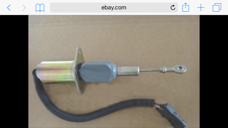

I've been wanting to put in a cummins shut off solenoid (I have 1 from using as know good still in my box) on the turbo master that by applying power to the solenoid it will pull the wate gate open. Simple distance adjustment will allow pressure setting. The solenoid handles thousands of on/off cycles and is constant duty so it wont hurt anything to be on for hours on long drives.
This is like the one I have- just stole pic from ebay
If you have vacuum control the one Leroy posted is great. If mechanical only, a variable throw solenoid controlled by a rheostat on the dash would work.
They work well, but have very little actual pull to them. Also of note, it's a 2 stage solenoid. You have a pull and a hold side to it(hence the 3 wires). The pull side needs about 45-50 amps of current to pull it closed, and the hold side only needs about 7-8 iirc. If it doesnt pull all the way in, it will self destruct itselk or best case scenario release. If you pull one apart, there is a mechanical button down inside that the plunger must release to change the coil from pull to hold, if it doesnt switch the get very hot and burn up.I've been wanting to put in a cummins shut off solenoid (I have 1 from using as know good still in my box) on the turbo master that by applying power to the solenoid it will pull the wate gate open. Simple distance adjustment will allow pressure setting. The solenoid handles thousands of on/off cycles and is constant duty so it wont hurt anything to be on for hours on long drives.
