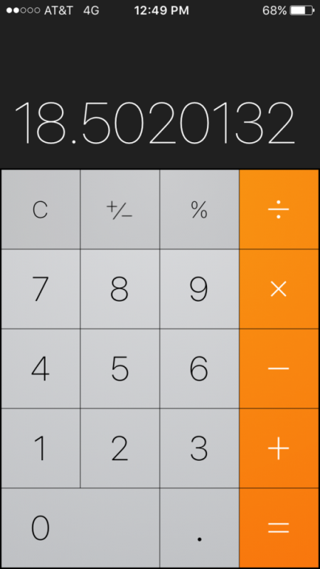

Ok I drove home today and I have some mileage updates. I filled up more frequently so I could keep the segment with the hills out of the mix.
First leg: St. Ignace, MI to Grayling, MI. 91.45 miles and 5.217 gallons. 17.53mpg.
Second leg: Grayling to Marshall, MI. 194.10 miles and 10.525 gallons. 18.44mpg.
So it wasn't any better, but does show that the elevation was hurting me. I even left the AC off until about halfway through the second segment. I thought it would be better just from the gravitational advantage of driving from North to South! :D;)
I know I could get better if I slowed down (I still had the cruise set at 75mph) but I wasn't really interested in that. The next time I get tires I think I'll go 265/75 (I'm running 265/70s right now) to slow the engine down a little (I was spinning 2350 at 75). Really though, a 6000 pound truck booking along at 75 and still getting 18.5mpg isn't anything to scoff at. My 300 straight 6 in a 4700 pound truck struggles to get 15 on the highway.
