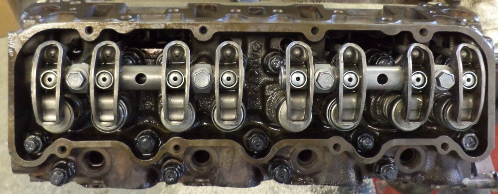

While you’re up spending, get yourself some of those Harlan Sharp rockers. They look real cool.

Harlan Sharp rockers: I'm pretty sure my rockers will get transferred over.

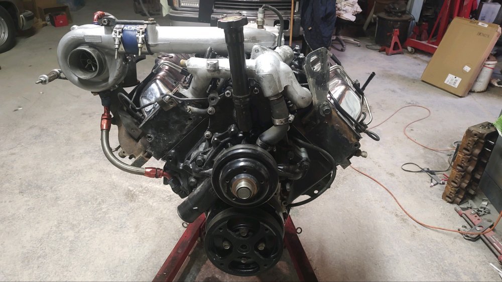

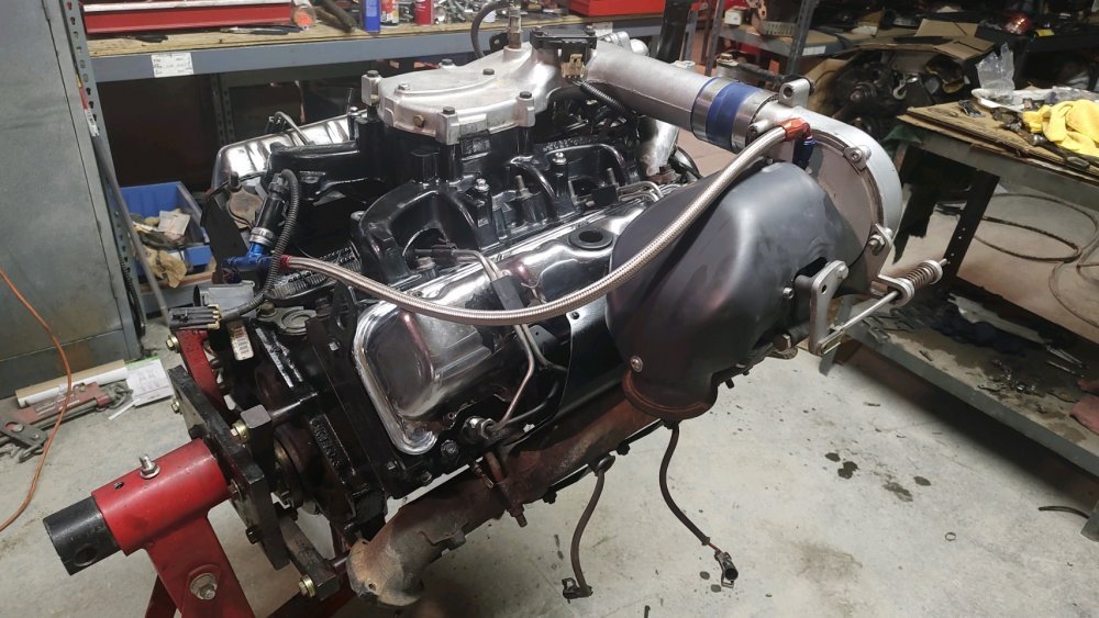

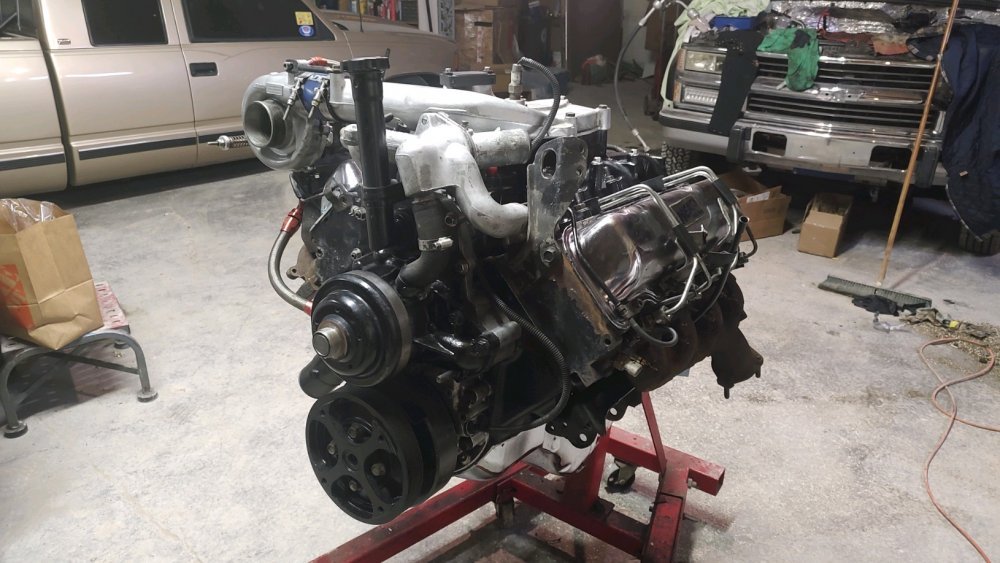

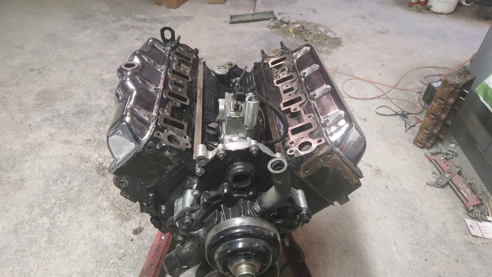

Why black?
I'm still green.

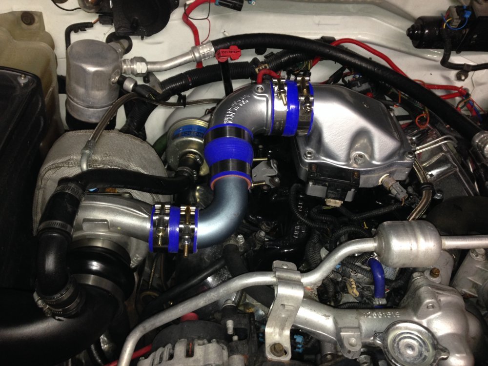

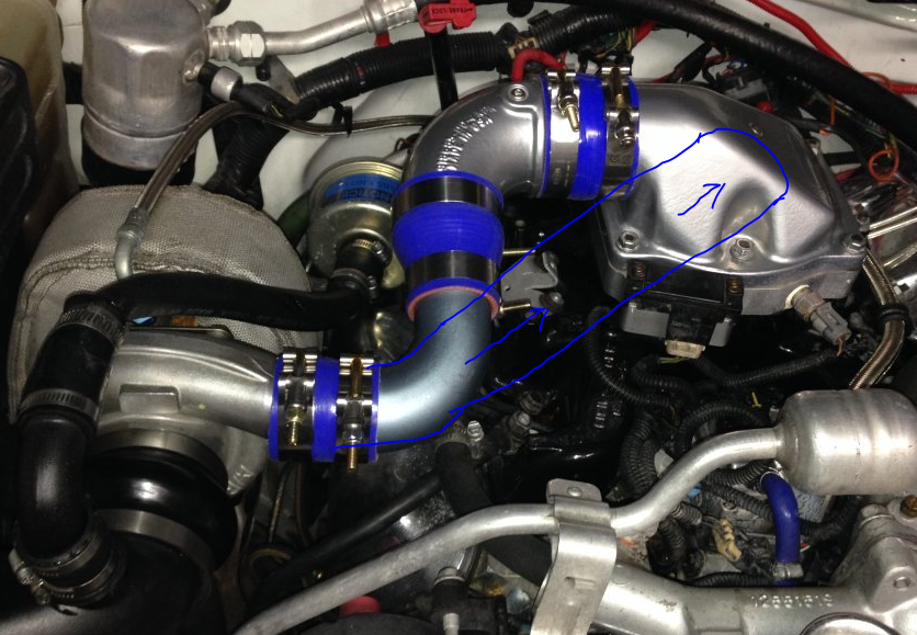

No clue but, I’m not complaining. I didn’t know he was going to paint it at all. Looks better than the pealing Silver Blue whatever that was barely hanging on when it was pulled even if the heads don’t get touched up. The OEM upper intake unit is on . He was never a fan of the upper intake mod Jammie came up with on the original build that I also used (Cummins “hat” w/ a couple of 90* bends to the turbo).
You would think that one would have been designed/fabricated with the inlet facing forward and a single, long-radius, sweeping 90° bend from the turbo to the inlet to promote maximum smooth flow into the intake manifold.
