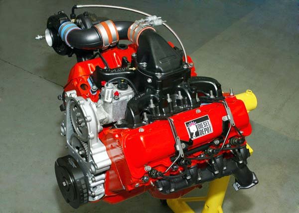

Short history on the motor. Diesel Depot built the motor for 635 with the ‘help’ of ideas and advice of Ian, another former member here, for an attempt to build a 500 hp motor. Thread may still be in the archives…MaxxTorque still has the article “The Best Ever 6.5 Chevy Diesel Rebuild (Vol 1, issue 3) but it requires a membership to get the whole thing. I don’t know if they’re even around to approve new members….

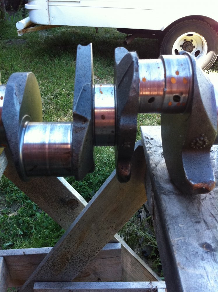

Anyhoo, the build started with a 660, 6.2 NA block. Supposed to have a forged crank but, that along with the Clevite bearings didn’t happen which is how I got it. King bearings used instead failed and the crank was taken out in less than 25K miles (picture below). Still, the intake and exhaust runners along with the manifolds were extrude honed (ported and polished?) and ceramic coatings applied to piston tops and valves and heads (visible in the earlier pic.). Against his advice, I bought the remains off Ted, retained the good stuff (except apparently the valves weren’t good) replaced pistons w/30 over Mahle, rods and rod bearings, Scat Crank turned down for 2 piece rear main, studded the mains, heads and, for grins, the HT-4 Cam etc. etc. and twisted Bill’s arm into doing the work… so much for short story but, those who know me…know.

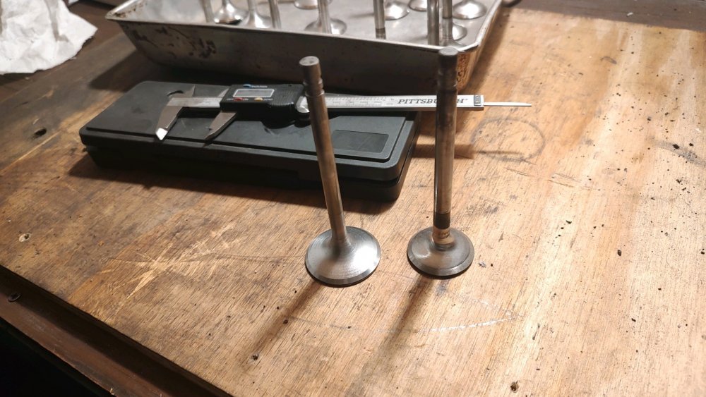

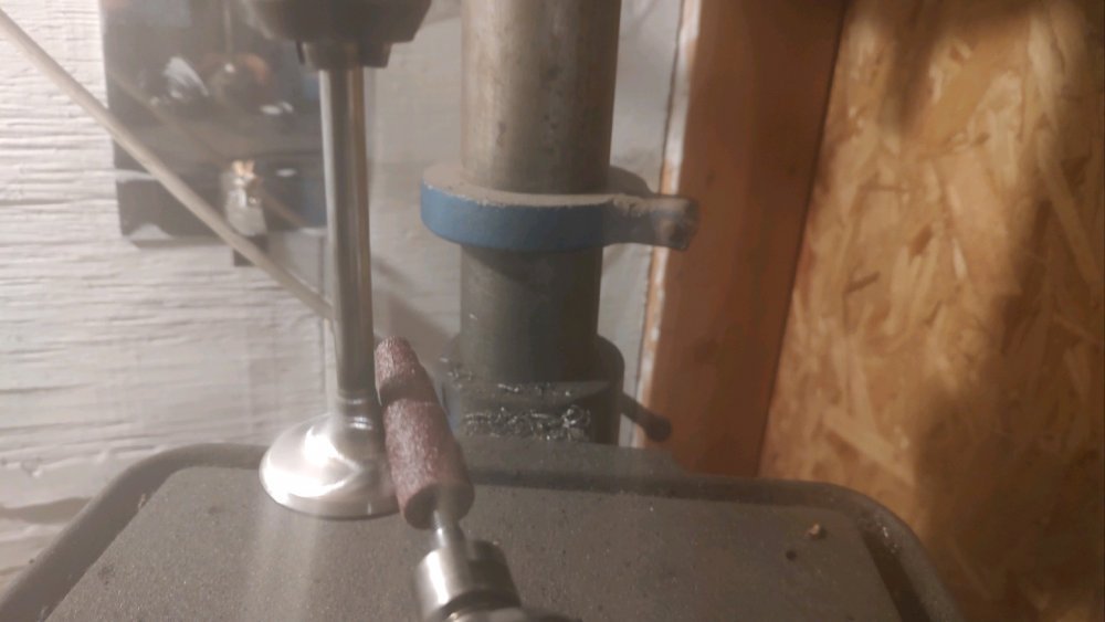

OEM Valves are profiled and ready for the heads to get resurfaced (next week).

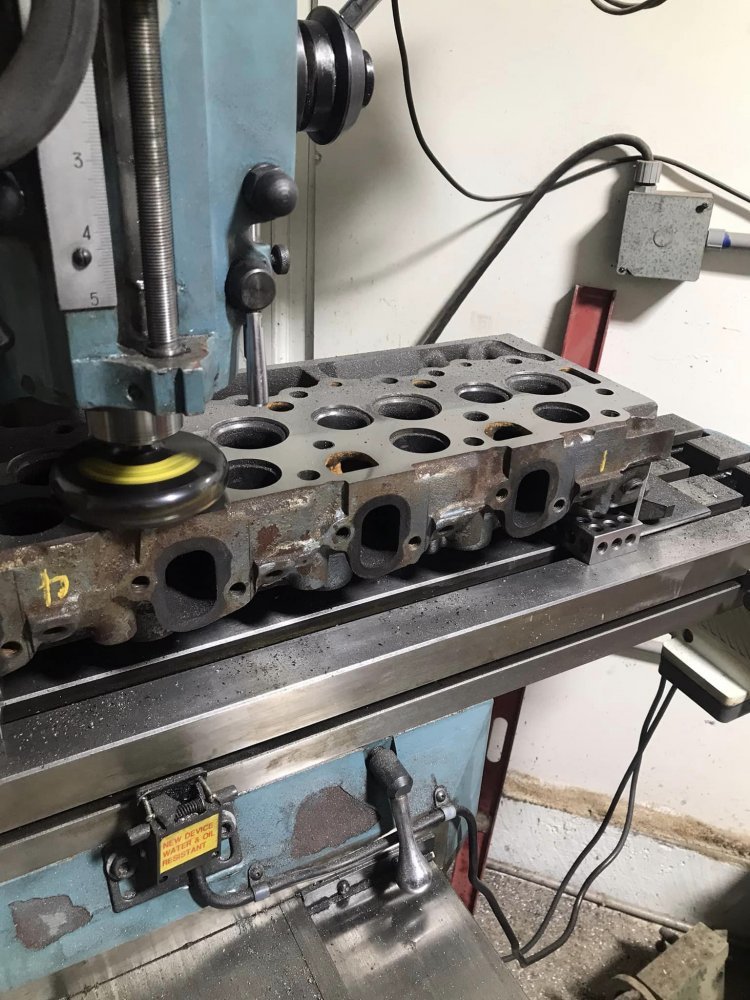

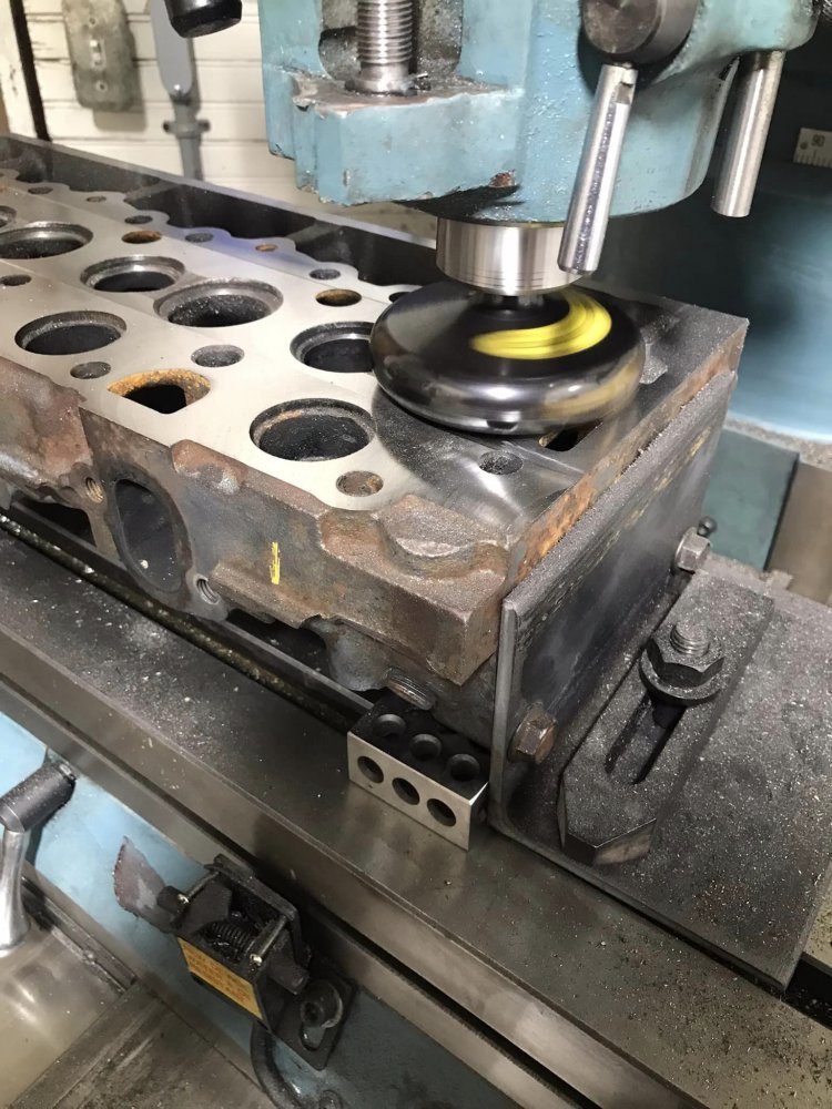

Heads got the 'fly cutter wheel' treatment at Chris Mursick's Welding (and Machine Works) in Okanogan. Turned out great and saved a 7hr round trip drive to Yakima.

Chris is great people, a brother Army Veteran and holds many SCTA land speed records in VW's and is currently running a 1.8L VW Diesel in his Messerschmitt themed streamliner. 2021 on his first run with a VW Gasser flat 4 he was passing 110mph in first gear when he passed the first mile marker but aborted the run. Got rained out this year so the maiden voyage with the diesel will probably be at El Mirage in May. Hope Bill will run his truck there as well...aaaannnd I digress...again. Those who know me, know....
Nice to see the shop removed the precups before resurfacing the head👍
I’ve come across some places that leave the precups in place.Hard to get good work performed nowadays but some machine shops are still dedicated in doing the job correctly.It’s just a matter of weeding them out.
Wouldn't that then leave the precup sticking up a couple of thousandths above the head surface when reinstalled and lead to possible head gasket sealing issues after assembly, since half the precup is in the cylinder and the other half is over the block? Or am I missing something?
Yes, PreCups were removed prior to surfacing.
Bill is edumacating Chris on IDI vs. DI and the subtleties. Like me, Chris confesses he suffers a bit from information overload at times, and just has to do what the customer wants.
Precups... those will be machined / surfaced to ensure correct specs now that the heads are a thousandth-ish different.

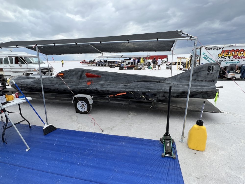

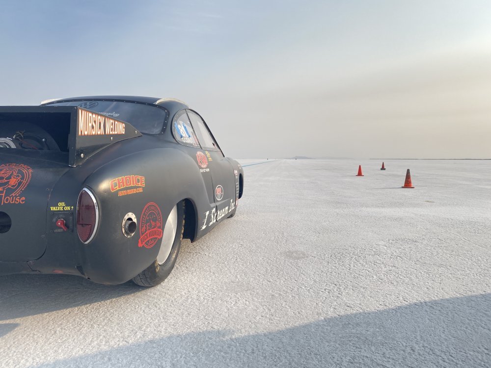

Here's a couple more eye candy shots of Chris' Karman Gia LSRsIMG_4492.JPGIMG_4308.JPG
