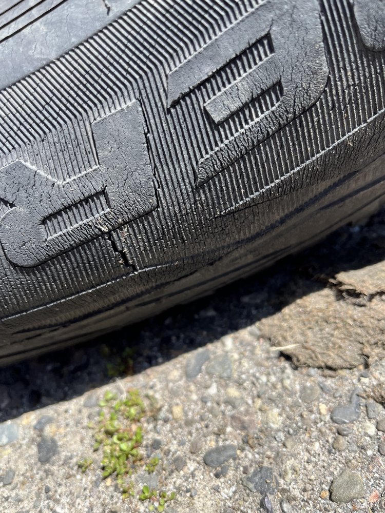

Tires are date coded 2013 so they’ll be getting replaced soon. Thinking of ditching the big truck look and moving back to OEM-ish sizes around 265 70 16. Will have to get rid of the fender flares if I do. Decisions decisions.
Called it on the date aged tires. Same deal on Colby’s. Gotta replace before I do any long distance in the heat.
When I talked to Les Schwab guys yesterday they wanted to sell me new tires. “Oh, I wouldn’t want to drive 12 hours on these.” Yeah, ok, thanks. It’s 4:00, they close in 30 min and don’t have the brand I want. These tires have the same rolling resistance as an octagon and guess which brand they do have?

We have tires far older than that in our family. Believe it or not, they're fine. If a tire has to be replaced due to an expiration date, then perhaps another manufacturer is in order.
For what it's worth, the stance on your truck is correct. I'm with Les - don't change a thing. As soon as I'm able to justify what is needed for mine to not rub with 16x10s, they'll go back on - like it was 20 years ago (well, 16.5s then. 16x10s were afterward...).
I have bad luck with age dated tires. Usually they give it up in the heat, but I've had a tire go in the all up in MT. Trailer tires are the worst. Can't go much more than 5 years on them.
A couple years back I called the manager at Goodyear who handles all tires for the military. I was asking if there is any chance on them bringing back the GS-A for ires that was originally for the hmmwv. He said no, and that they knew it out performed the MT (Mud Terrain) in every single aspect except mud- but they don’t look like aggressive off road tires so the decision makers in the gubmint decided only MT from then on. SMH
The MTR they stopped making because the side knobbys would crack being stored outside in the southwest for 10 years, then would get installed and crack around those knobbys at year 3 on the rig.
ANYWAYS- one of the specifications of tires sold to the military is it has to have a 10 year shelf life before mounting then a 5 year life on the rig. He said it’s a lot more sulfur and a little kore other stuff in the mix to do it. He said on those 16.5 tires, fine cracking is considered ok, but when it is wide enough to slip a piece of paper in, or is longer than 12”, then chuck it. But normal tires he didn’t say.
So if it is old military tires you are running, 15 years from the DOT date code.
He said 7 years on normal tires from DOT date code is ok.
When I asked about trailer tires, he said ones that are labeled as trailer tires- they have more sulfur than normal tires and thats why they are a little more. They are good for 10 years from the DOT date code.

Age dated tires. These side walls are showing signs of going. The tires on my old Burb, at time of purchase, were over 20 years old and felt like plastic to the touch and handled poorly. I was nursing it home from WA (sound familiar) when in a rainstorm they gave up, hydroplaned and I flat spun 270 degrees on I-84…Pulled into the nearest Les Schwab and finished the trip on tires that were round, rubber, and handled great.
Otherwise, I agree that the tires should be judged based on condition. Still, I can see an insurance company denying a claim because one could have avoided control loss with tires less than 10 years.
Made it home tonight, safe and sound and I’m getting new tires and wheels in the morning. The Dick Cepeks will go in the storage room and await new shoes once I get towards the end of the 2 page TTD now list.
