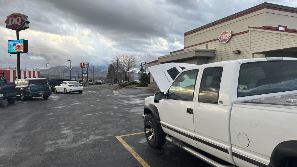

After a day’s delay because of flight cancelation I arrived in Spokane last night and got to Wenatchee WA by bus this afternoon. Bill met me there and as the bus pulled around the corner I saw the truck parked along side the street and I started to grin. I handed me the keys and it lit off with no smoke. Idles with a smooth diesely 6.5 happy rattle, accurately crisply with no smoke. Accelerates HARD with no smoke. Accelerates gently from 55 to 65 mph, up grades with no downshift and no smoke. One thing that didn’t get fixed is it still can’t pass a Dairy Queen without stopping. What can I say, I got a sweet tooth.
No, no real issues motor wise. Now it just rolls down the road like it should. Which it hasn’t done that in years. Lesson reinforced. If you don’t take time to do it right the first time, you’ll certainly be forced to take time to fix it and make it right later.
So very thankful to Bill for doing the work to make it right. Thank you all for hanging in there with suggestions, encouragement, general banter and friendship. Much needed and greatly appreciated.
