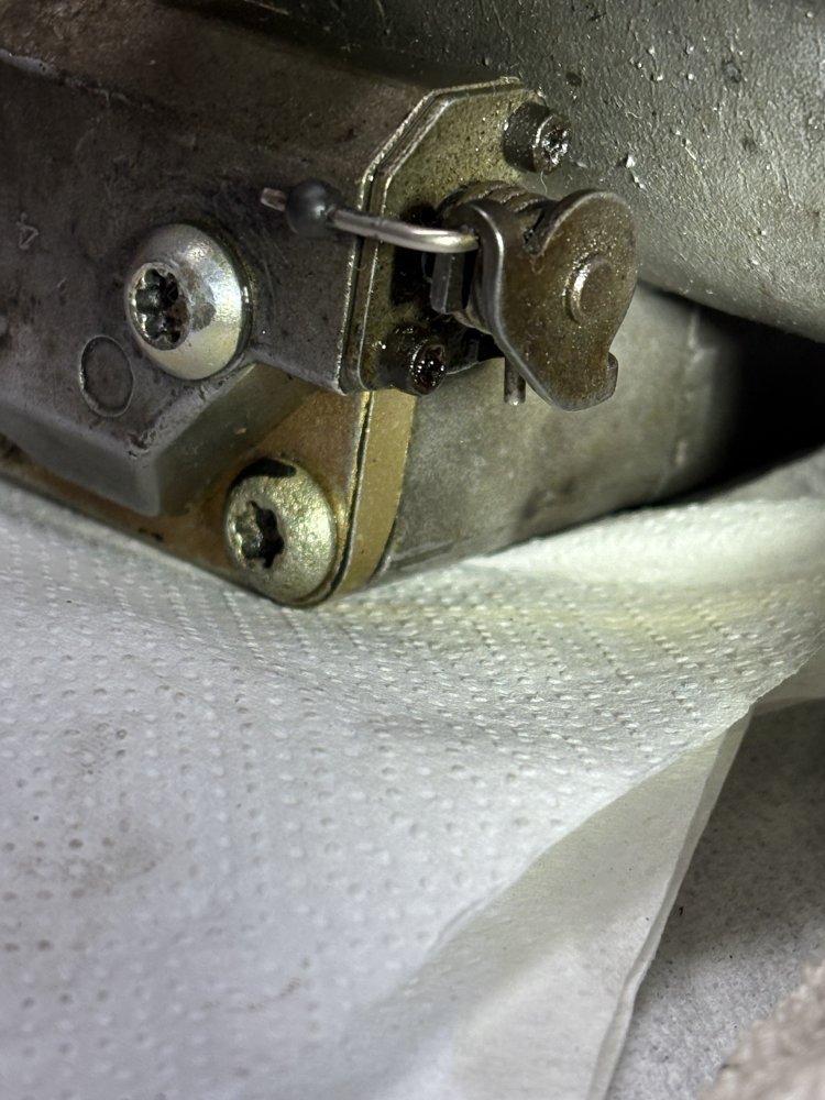

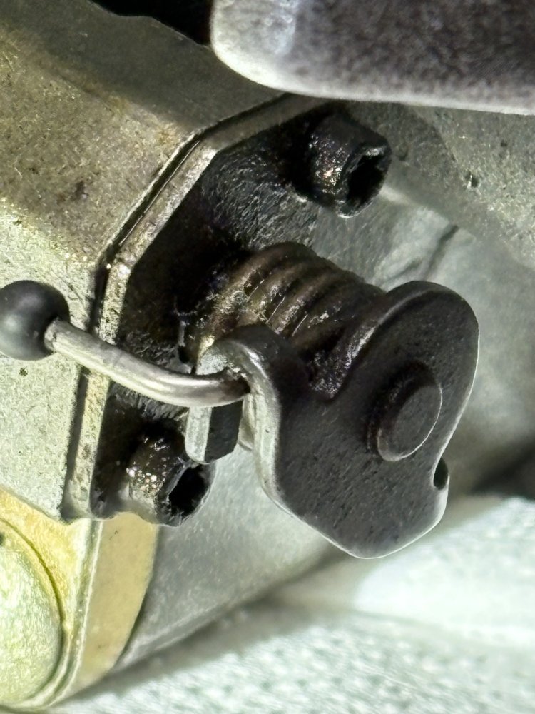

Happy New Year to all….update reinstalled IP , fuel lines, lower intake and cranked it up and it appears to be leaking more…can’t really see exactly where so pulled it back out again and it looks like the new key shaped seal is holding, but looks like the linkage that the stepper motor attaches to is where it is leaking from…so the kit should contain the seals and gaskets, but question whether the linkage should move freely..seems like I can’t move it with my fingers or is it that tight it will only move when the stepper motor engages?

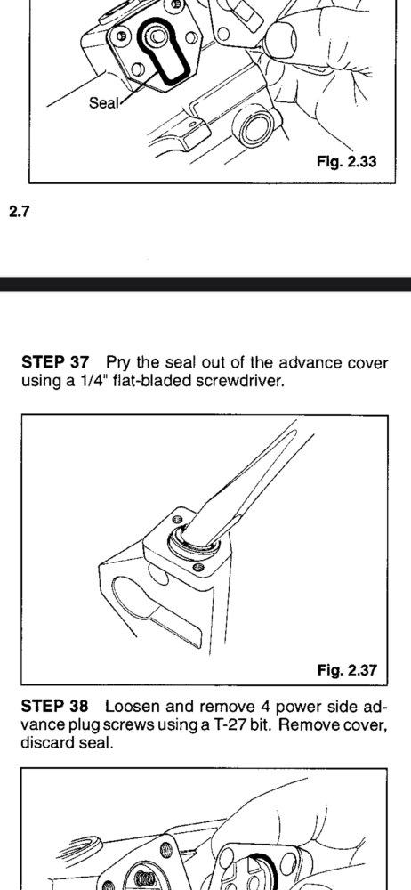

Good morning and thanks. When I replaced the seal that houses the linkage for stepper motor I tried moving it by finger pressure and it didn’t move (before attaching stepper motor) so I took it back off and it moved freely but when I reattached it was too hard to move… so I wasn’t sure if it was binding because of something I did or if the stepper motor was that strong. I didn’t replace seal on the linkage yet….just taking baby steps.IMG_1300.png
