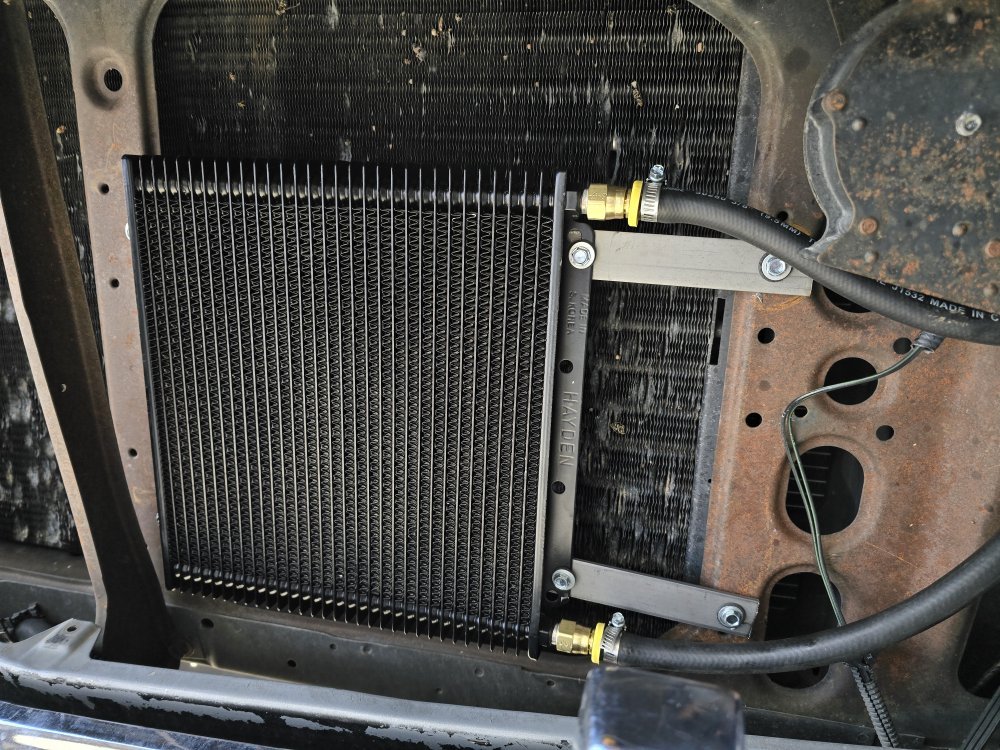

as far as other gauges, a trans temp can be tied into the lines feeding the trans cooler. just be sure to tie into the one coming out of the trans before the cooler, not the one coming back into the trans. I would avoid plumbing one into the pan to avoid any possible leaks in the future.

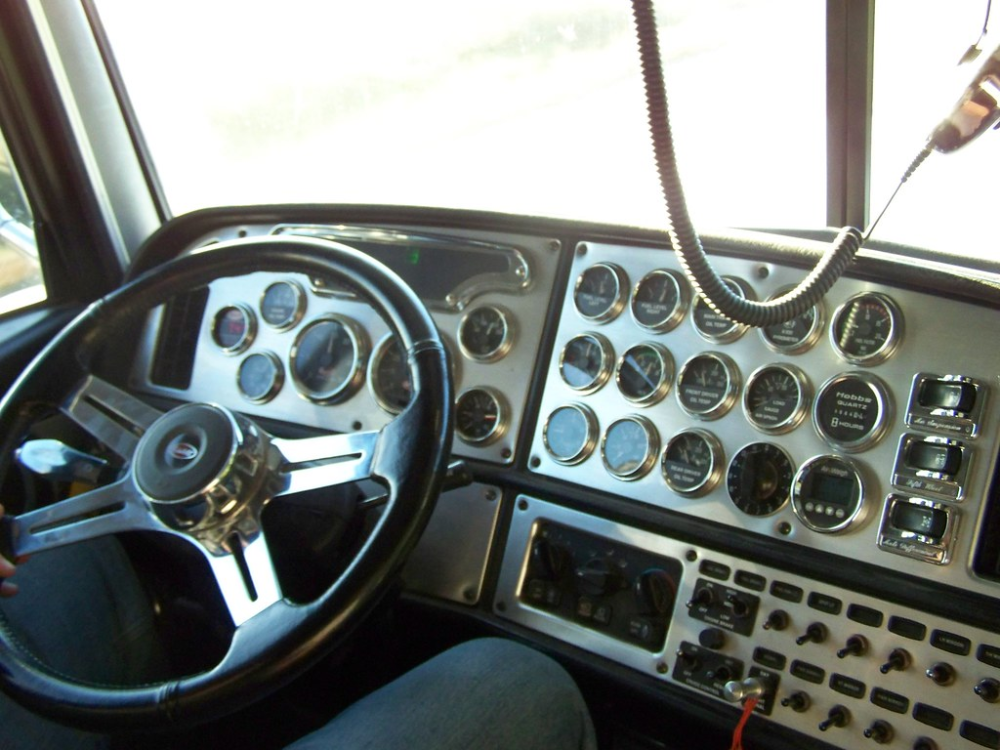

for my wish list I would like to have the following on my rigs.... Boost (already have), fuel pressure, EGT, trans temp, rear diff temp, engine oil temp, and overdrive temp (I have a gear vendors overdrive unit attached to the rear of the trans). And of course make the dash look like a Peterbilt HAHA.
