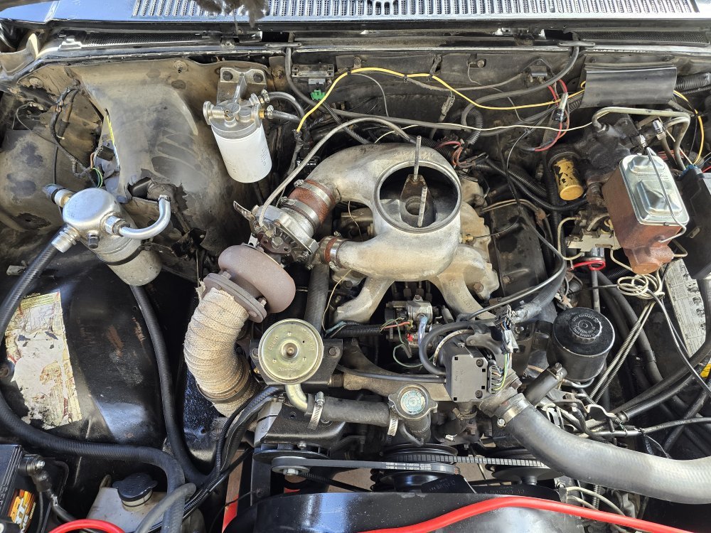

Thank you all so much for your help through this, ever sinfe changing out the Lift Pump, the 6.2 has been running smoothly (https://photos.app.goo.gl/D4kWrNc3Bo1zSFUFA) with no issues as of yet, I am forever thankful to you all

I will consider adding a Fuel pressure guage aswell, since, why not at this point, as i already have a Pyro Meter and Boost Guage installed by the prevhous owner, having another 2 would compliment it well.
