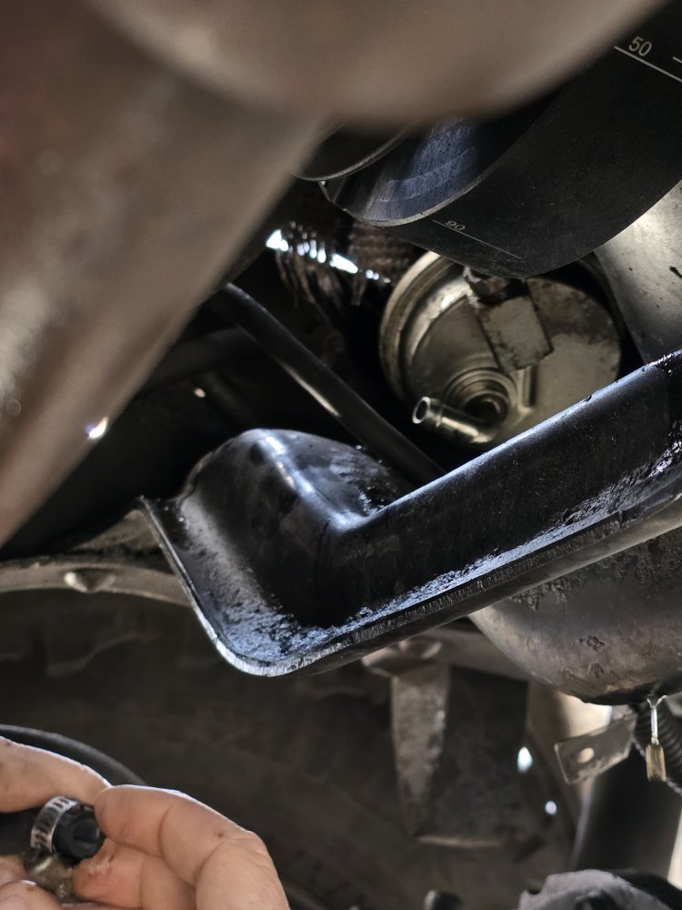

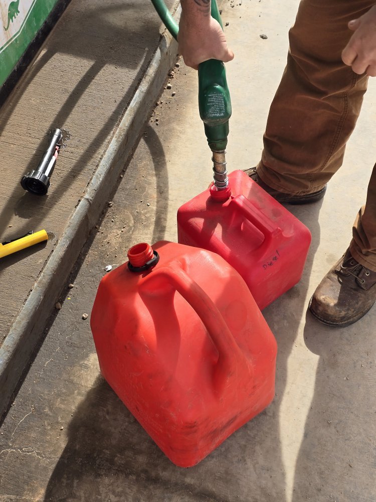

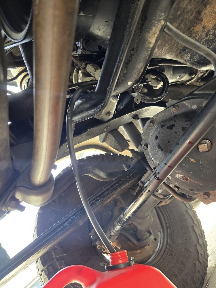

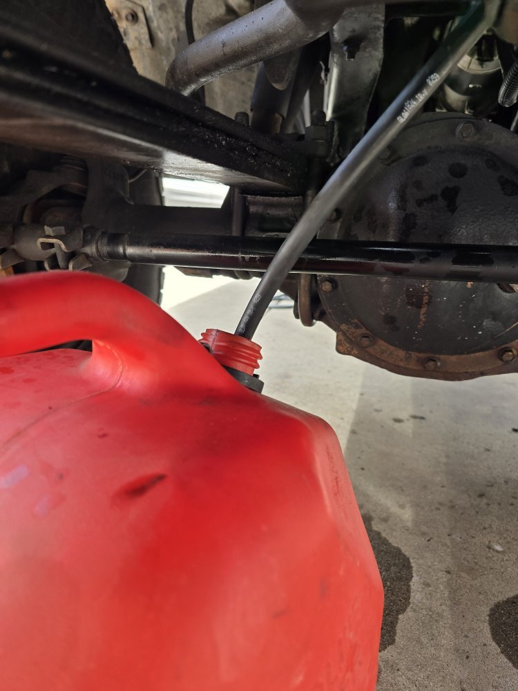

Strap down a five gallon fuel jug on the floor in the right side passenger area. Providing this Blazer still has the mechanical lift pump bolted to the block.
Disconnect the hose right at the lift pump, bring another hose from the fuel jug to the lift pump and start a siphon, plug the hose into the lift pump at first sign of fuel. The fuel hose can be threaded through the pour spout of the fuel jug to help in not creating a mess.
Now take it for a drive and see how it performs.
Will do that this weekend sir

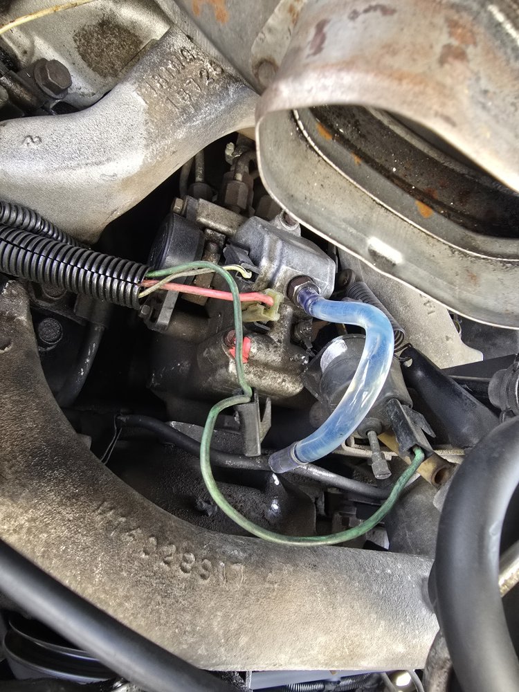

Possible that if there are holes rusted through the pickup tube that those holes got exposed and now it is allowing air incursion ?
May very well be, only way to find out

The clear line can be on there for years and years. The pvc cheap stuff lasts 3 years anywhere I have seen, 4-5 years most places. The good stuff from fuel-line.com is permanent as in should outlast the black rubber line.
