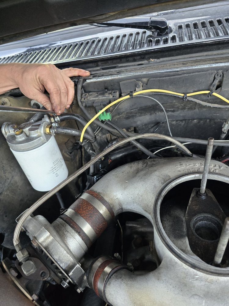

My friend the ex Army MX (mechanic) guy literally stopped to go in reverse, and as soon as he stopped it reved to max RPMs before dropping and repeating the processes, we barely pulled in before parking and shutting it off in a hurry
Are you saying here that is went WOT on it's own approaching 4000 + rpms? with out you or anyone pressing the throttle pedal?
from what I can tell here you have two compounding issues. 1. air intrusion from somewhere in the fuel system. 2. Possible IP going south.
I will wait for the guys to chime in on problem #2 That can wreck you whole day and then some if correct.
If you didn’t have massive air intrusion it would have blown up already.

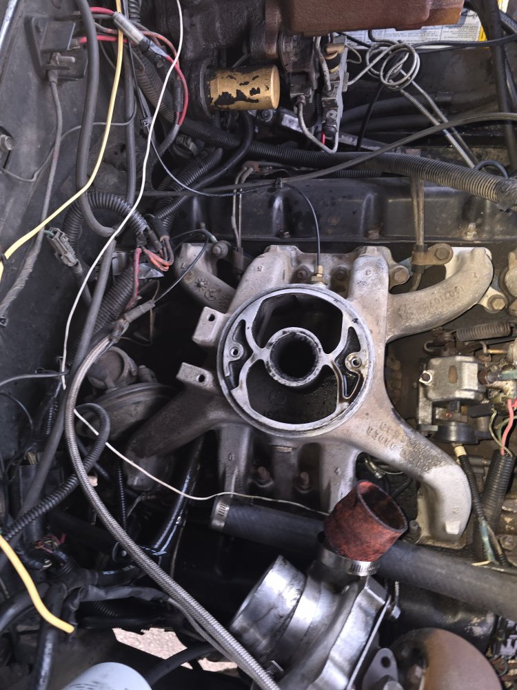

I don’t have time currently to find a YouTube video showing how to assemble the governor correctly. This is what must be done. And get the top of the intake bare. A piece of plywood or steel to cover it completely. You need a perfect seal as best as possible.
Find or make something. Then show it here.
Then we go from there.
Until you can show what you have will do it adequately- doing anything else can destroy the engine and kill whoever is near it.

I have a spare IP that my friend sent me (some of you may know him from TikTok: https://www.tiktok.com/@thatdirty6.2detroit?_t=ZT-8uKnfCNweuQ&_r=1 )
I've been wanting to rule out air intrusion, but, I suppose the IP truly is going out, unfortunately

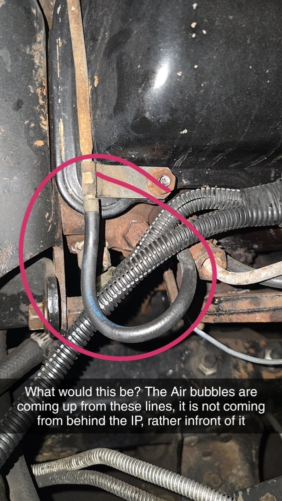

If anyone has a diagram for this, I'd really come in hand
These are your injector return lines. they all just loop from one injector to the next. the last two are plugged off. the first injector connects to the return steel line that tee's into the IP retrun as well and the other bank of injectors. then runs up under the intake to the back of the engine where it then connects to a larger hose then travels back to the tank.
