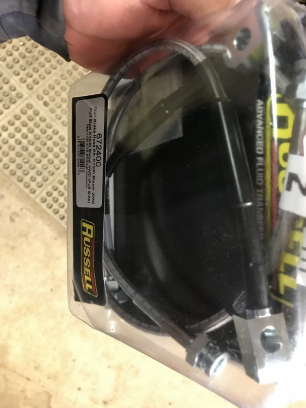

I don’t see any brackets, so it looks like I’ll have to remove the brackets from my rubber hoses and crimp them onto these.View attachment 52513
Yep > I called them twice today,
First guy told me they came with brackets. 2nd guy told me they came with brackets. I told the 2nd guy I wanted to see a picture of the brackets and after about 15 minutes he said they do not come with brackets.
I am looking for a couple of scrap lines to have the brackets ready before I tear things apart. Going to make a junk yard trip tomorrow.
Do the rubber brake hoses have any steel in them?
I plan on just removing the blot and cutting the lines on each side of the bolts. I have one set of cutters that would work good, but they are not steel friendly
If they do have any steel, it’s really thin gauge. You can cut brake hoses easily with side cutters. I’m not sure you’ll be able to do too much prep with the hoses off the truck - you’ll need to make sure the brackets are in the right location and orientation and that would be hard to do without the hoses on the truck or laying the braided hose right next to some standard rubber hoses. Are you going to be installing the hoses soon?
Tomorrow. Wanted to do it today, But I needed the brackets and did not want to destroy waht I have in case there was an issue.
The hard part with these brackets is the weight of the steel that wraps around the line. It's very hard to roll back and reclamp around the line.
I'm thinking of just cutting them length ways so they just trap the braided stainless lines instead of being attached like they are OEM style
https://www.amazon.com/gp/product/B000C9E4B0/?tag=jhdiesel-20
I doubt they’re that bad to pry open. Maybe start them open with a chisel or big screwdriver and then use channel locks to finish opening them up. I’m guessing once you have the brackets from the junkyard you’ll be able to figure it out.

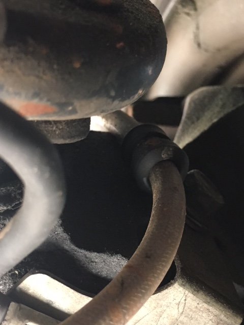

The OE front disc brake hose clip is pretty stout. They are wide and not easily crimped. I buggered mine up. If I would have been a little more patient or had a few to play with I might have been able to do better. Maybe take a side grider and trim them down some to make it easier to bend and crimp or something.
I ended up buying some cushioned hose "clips" to hold them in place.
View attachment 52528 View attachment 52529
Good to know, thanks. I’ll be prepared to do some messing around when the time comes.

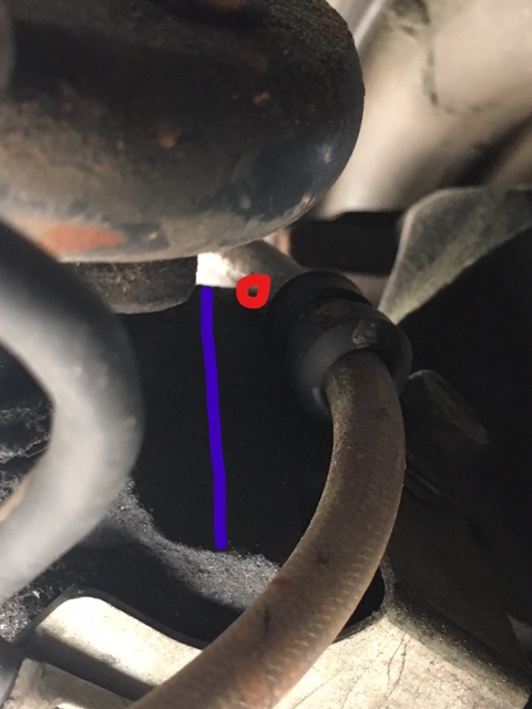

On the front brake clip I worried about it not be exactly like OE but seems to be fine. I have no wear on the line that I can see or feel.
The OE clip lays in a little trough the whole width of the knuckle ( sorta along the blue line). I worried about the backside of line rubbing underneath on the knuckles top edge under the point in red but the hose doesn't move on the back side - the Caliper and hose connection stays in same position relative to the knuckle. 99.9% of the movement is on the front side when you steer. Might be a little movement as caliper floats while breaking but its negligible. The upgraded line doesn't swell during braking so less movement than OE. The line would probably be ok without clip but it is a good idea to try and protect any possible chafing being a brake line.
If you wanted you could hone that edge a little just to be extra prudent if your casting has any sharpness.
Let us know if you see something on your install you think might be an issue.careful clip.jpg
