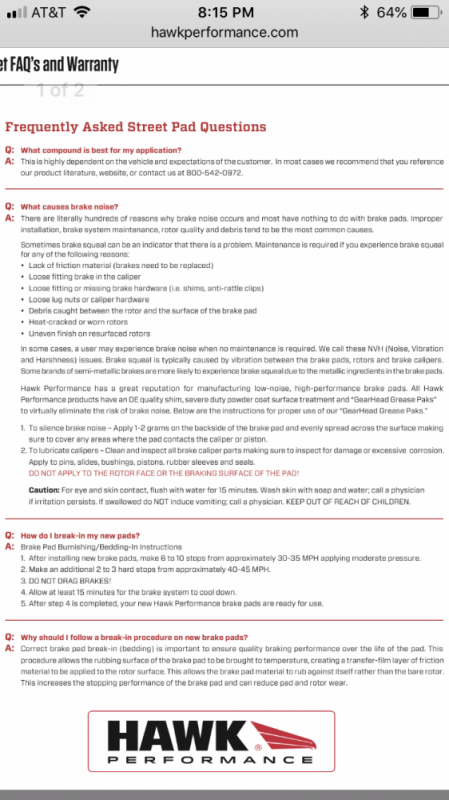

Somewhere in the past I read a brake pad bedding procedure that said you are supposed to make hard stops from a high speed with time to cool in between. I’m not sure where that came from - probably some internet “expert”. I went to Hawk’s website and found their procedure, which is pretty similar to what you guys are describing.
As far as dealing with my current brakes, I’m hesitant to take them apart and start over. I’m happy with how they’re performing currently and would hate to ruin something by trying to re-do the bedding procedure. If they’re working well now, should I still try taking them apart, deglaze the rotors amd rebed the pads?
Also, I misspoke when I said burnishing the rotors - what I meant was that I was abrading the rotors to deglaze them so the new pads could bed in.
Heck no! Rule #1: if it is working don’t mess with it! If it’s good now, you’re fine.
