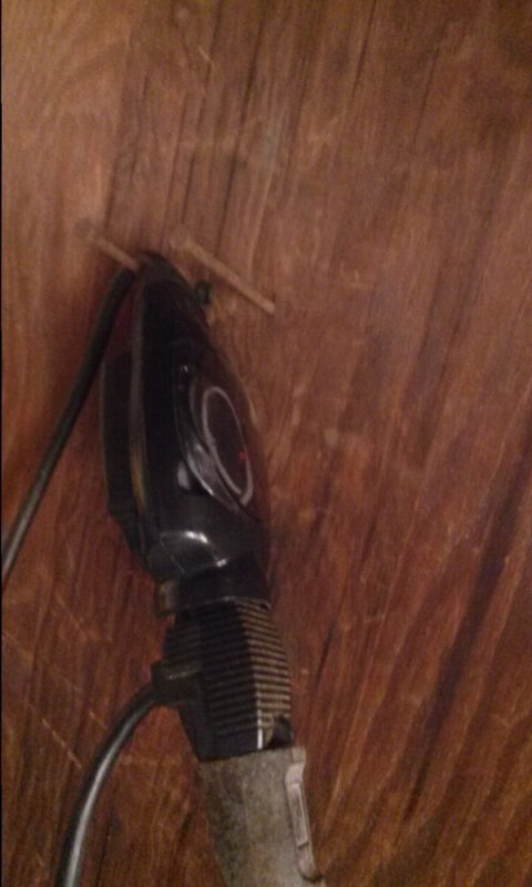

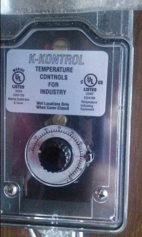

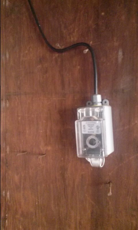

Do you have the thermostat by the engine or for ambient air temp?
What thermostat do you use?
Ambient and keep it in an adjacent car port so that (for grins) it stays out of the elements.
