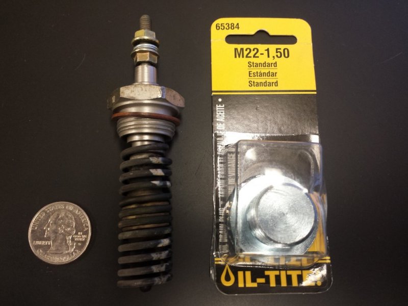

I was given the intake heater/element from a 7.3 Powerstroke. I'm planning to either weld a bung/mount in the 3" IC piping just before the intake inlet, or possibly drill/tap the Peninsular inlet (easier & faster than welding bung into aluminum IC tube) to mount it. Figure the heater needs to be mounted where it's a restriction to effectively transfer its heat to the air charge. This intake heater has the same diameter/thread pattern as the 5.9 Cummins oil pan plug, so easy solution to take heater out & eliminate the restriction except in the coldest winter weather.
My ~19:1 engine starts reliably well below zero, but at the coldest temps takes ~5 seconds to have enough heat in the chambers to fire cleanly with no smoking out the tailpipe. I'll try this intake heater to see if it will clean that 5 seconds up. Also see how noticeable any performance difference is from the added restriction.

Agreed these heaters were added to pickup diesels to help with cold start emissions. They showed up on some diesel tractors many years ago - before much concern over offroad diesel emissions; don't know if these were moving as much air as the 6.5?. So I don't know if this heater will output enough btu to raise the air charge temp enough to make a big difference? Hence why I wanna try it - not a lot of cost beyond a bit of fabrication time & the wiring/relay stout enough to feed the intake heater.

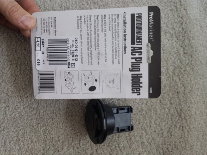

Think that's the one I've seen on some Ford tractors & I think some combine engine but can't recall which. I'll get a pic of the 7.3 Powerstroke heater. Getting back closer to the original thread subject, I'll get a pic of a marine 120V plug I picked up to mount inside one of the bumper nostrils to clean up the block heaters pigtail.

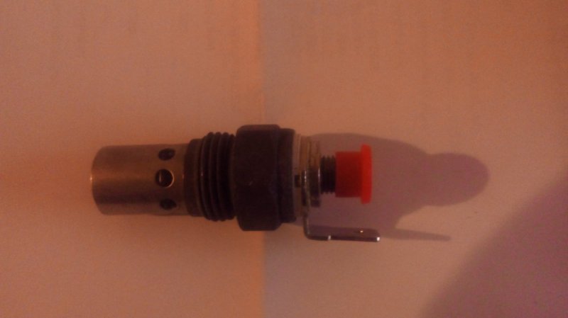

Been contemplating trying this.
That thing is *puny* compared to the AIH . . .
That "thing" uses fuel more so than electricity.
Yeah, was thinking that - It's been many years back when I was around some older Ford tractors. Was it used to aid vaporizing fuel? Or actually fire it? Seems like I recall a tradename like Thermostart? or something along those lines.
Here's a pic of the intake air heater Ford used on the 7.3's,& a Cummin's 5.9 oil pan plug to fashion a block off plug so the heater & the restriction it'd cause could be removed for the majority of the year.
I just spoke with the guy that gave it to me who has several modified Ford diesel trucks. He said the heater made a noticeable difference - which is enough to make me want to try it & see. His 7.3 made a hair under 500 hp on the dyno so understand why he removed the heater/restriction. 20151229_153523.jpg
Here's the plug I intend to use to mount the block heater pigtail hidden off to the side in a bumper nostril.
I like he thermostart idea, except iirc you have to bleed the fuel for it. They do get a little flame action, unless you feed if unlead- then you get a GOOD flame action and no need to bleed. Heh heh- memories...
