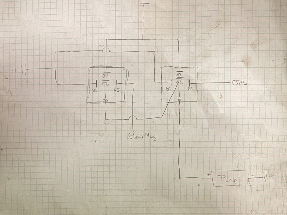

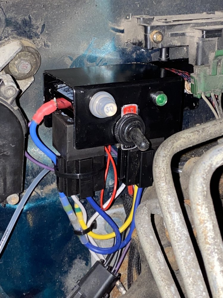

I got the wiring on the fuel system wrapped up this evening. The relay system that Jeff had put on the Tahoe worked well, so I was going to reuse it, but I realized it was right where I would be putting the cruise control module when it gets a mechanical conversion in the future, so I decided to do a whole new electrical system on it to go with the rest of it. I made a bracket out of some square tubing I had laying around.
I set up the relays the same way Jeff did because it worked really nice being triggered off of both the glow plugs and the oil pressure switch.
Here’s a video of the system being primed for the first time. It builds pressure pretty quickly. It would have done even better if I had known that the batteries were sitting at only about 10 volts…..
Nice work there! that's kinda the way I wired mine too. mine is more crude on the wiring, but it's really nice to have the LP prime the system before cranking :D
I also added the functionality so the lift pump would run with the glow plugs when I wired the dually…..but for that one, I used just 1 relay and then added diodes to the trigger circuits so they wouldn’t back feed. It isn’t intuitive to me to use the normally-closed terminal on the relay, so I was glad to see how it was used on this truck. I also used that for inspiration for wiring my headlights - when I did the headlights on the dually, I used 2 relays, but I also added a diode for the 4-high mod…..which was an unnecessary component I now see. For the lift pump circuit, I’m not sure which I prefer - 1 relay with diodes or 2 relays, I’ll probably let it marinate until the next truck.
I only used one relay on mine without the diode for the LP. so far I haven't seen any ill effects yet. some 5 pin relays have a built in diode in them, the trick on them is to make sure it's connected in the right direction to use the built in diode. Mine are just normal relays though.

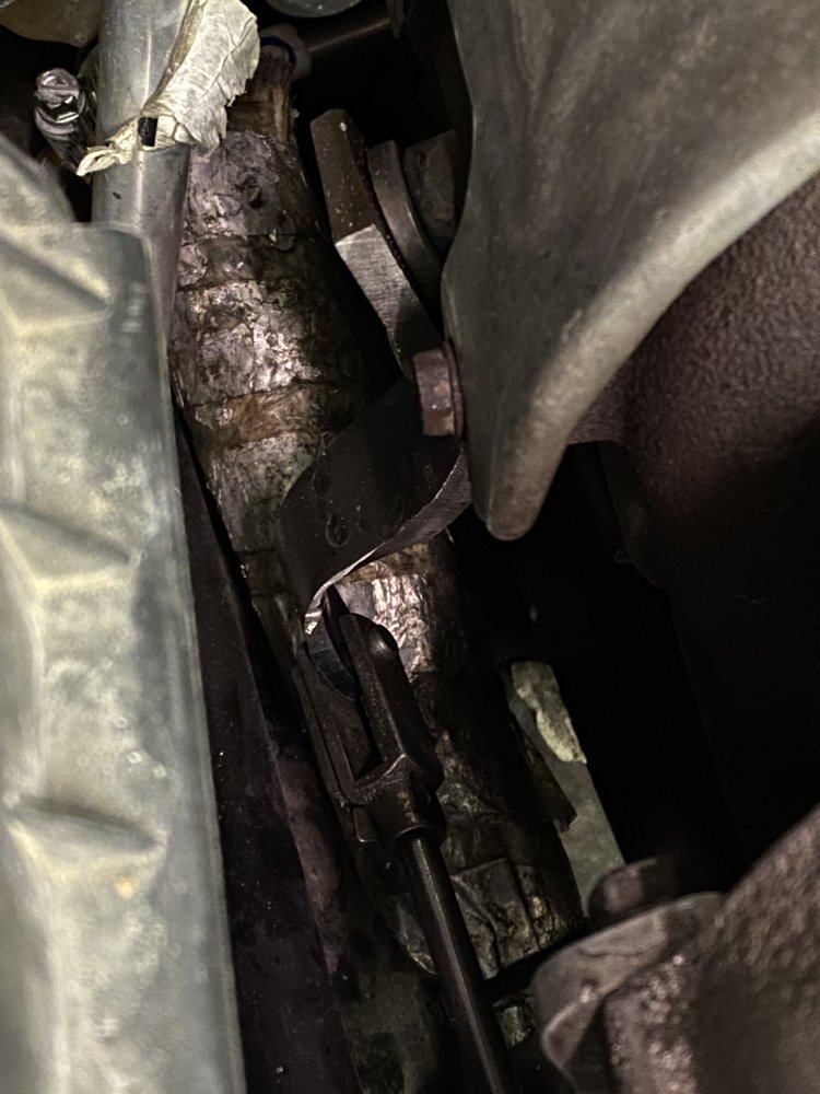

I worked on the wastegate vacuum system and even with no vacuum leaks and a new solenoid it still wouldn’t work, so I finally scrapped it and decided to go with a turbomaster. I only had one for the later GM8 style turbo in stock here, and since this will eventually be getting a turbo upgrade I didn’t want to spend money on another turbomaster, so instead I made an arm for the turbo to work with the earlier turbomaster. It maxes out at 7psi, so I think that’s fine.

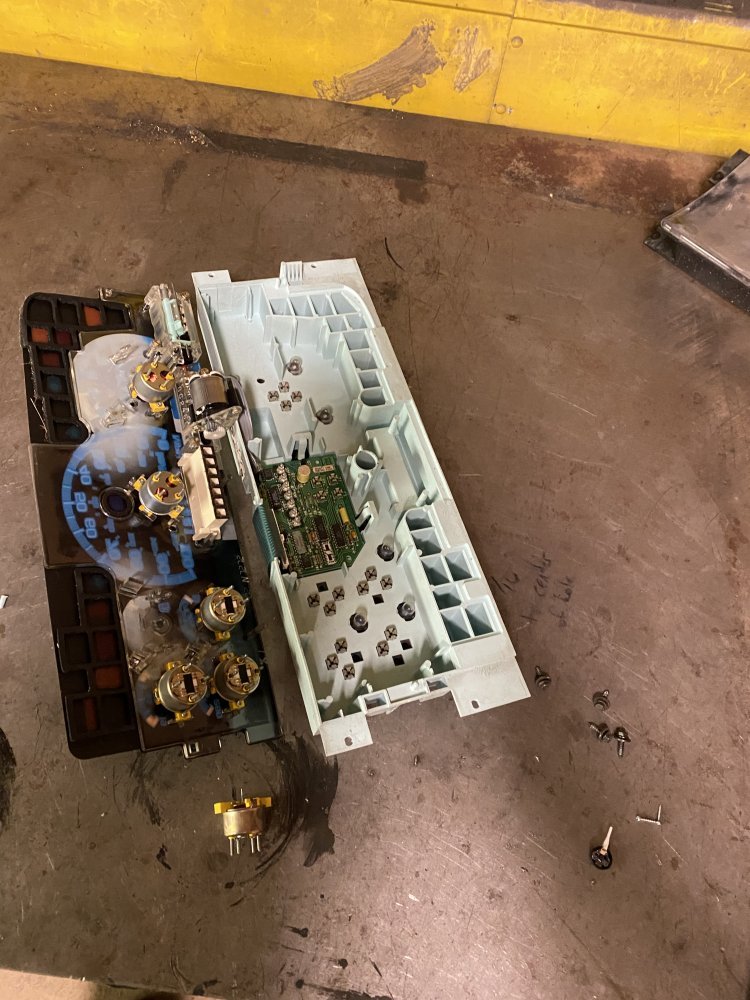

@n8in8or I see you got your cluster apart, one of the guys here had wanted some pics of the circuit for the tach. would you take some pics of the circuit and components to share?
Here's his thread.
Here's his thread.
The cluster has been back together for a week now and the parts cluster I used to rob the fuel gauge motor was a gasser cluster so that won’t help him unfortunately.
