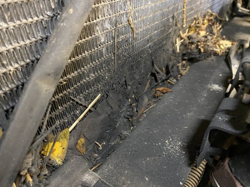

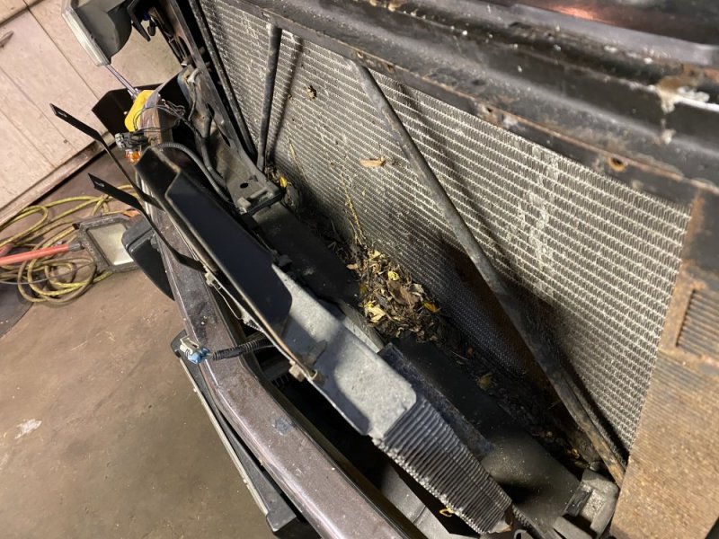

Last week I installed the new AC lines, condenser and accumulator. I found a lot of junk on the radiator, so I vacuumed it off, blew it out with an air nozzle from the back side and then degreased it.

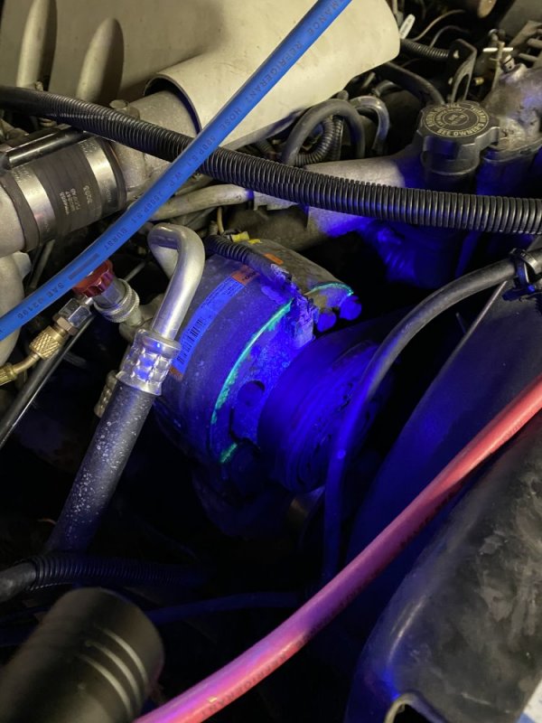

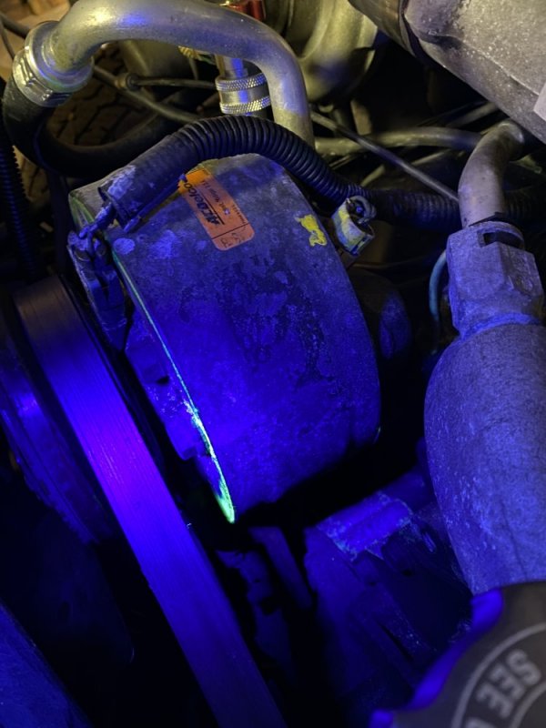

Put it in vacuum and…….it wouldn’t hold. Damn. Charged it to find the leak with dye and found the problem: and R4 doing R4 things. Probably sitting for 4 years didn’t help it.

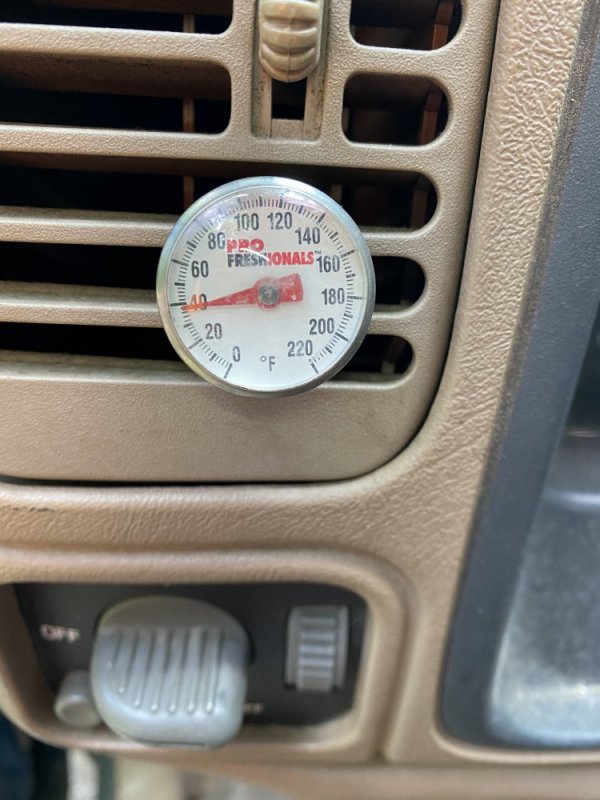

So I ordered an AC Delco compressor for it. Got it all installed last night and it held vacuum this time. I ran the pump on it for 3 hours today and then charged it. It has good AC now.

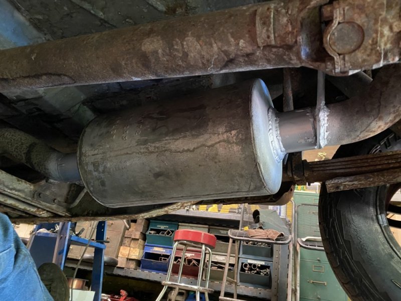

I also put a muffler on the exhaust. When I bought it the body of the muffler was rusted off and sounded awful. Since it had a cat on it I figured it would be fine with a straight pipe. Wrong. It was loud and obnoxious, both inside and outside. I had a 4” Walker muffler I had removed from the black Hoe, so I adapted it to the 3” exhaust. It sounds nice now.
