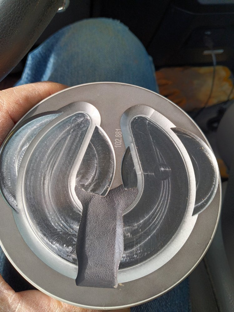

So long as it works for ya. I do it like the 2nd picture you show. And just drive it all the way down the side. It goes at an angle so every couple inches i have to pull it back a hair and redirect to go straight.
I do that along the intake side first, then front and rear. Finish with exhaust side.

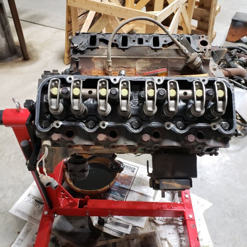

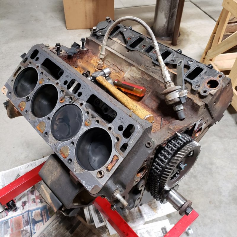

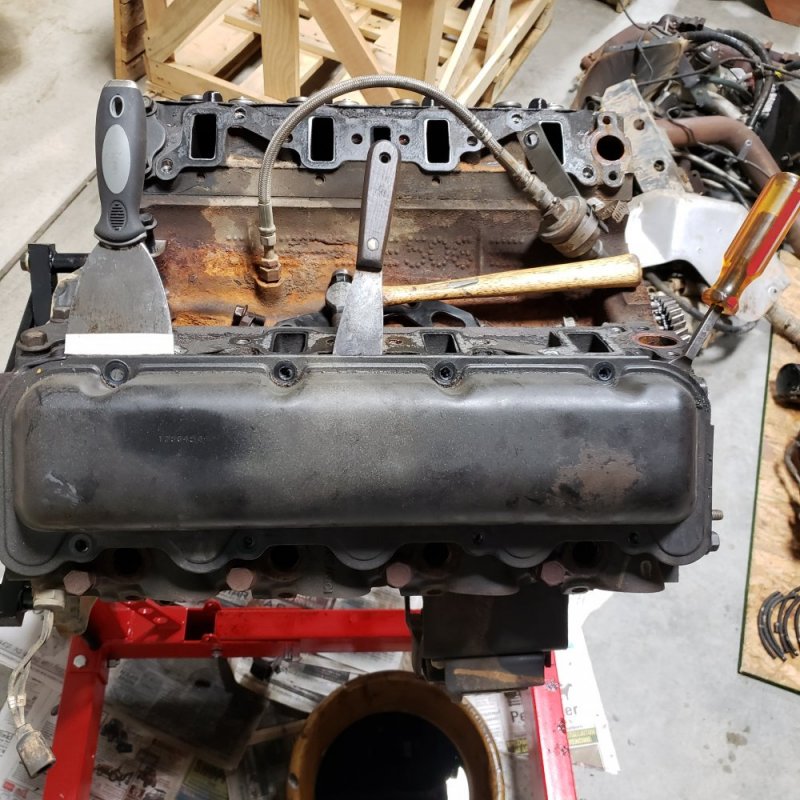

When I was taking the passenger side valve cover off the donor motor today, I saw there was what appeared to be another layer, but it wasn't clear to me what it was. Once the cover was off, I still couldn't tell what I was seeing. Is it a gasket of some sort? I didn't see anything like this on the other side valve cover.
I was able to use the technique I described above and got this side off without issue. I taped the putty knife so I knew how far I could safely drive the blade.
I am not sure how much age or miles are needed to make these plastic buttons turn brown, but these were yellowed, assuming they're white when new.

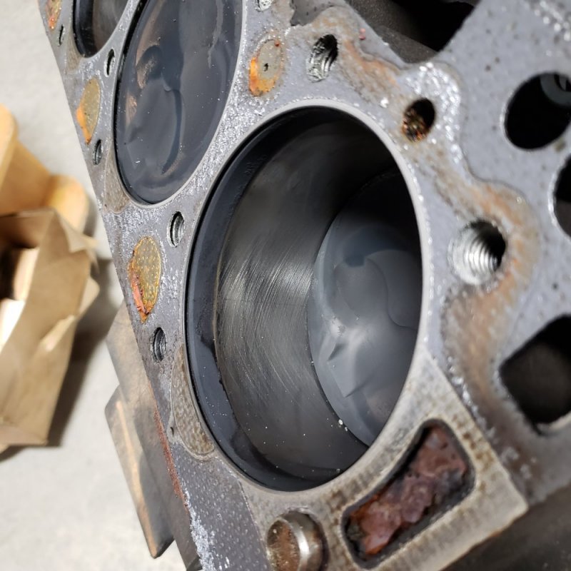

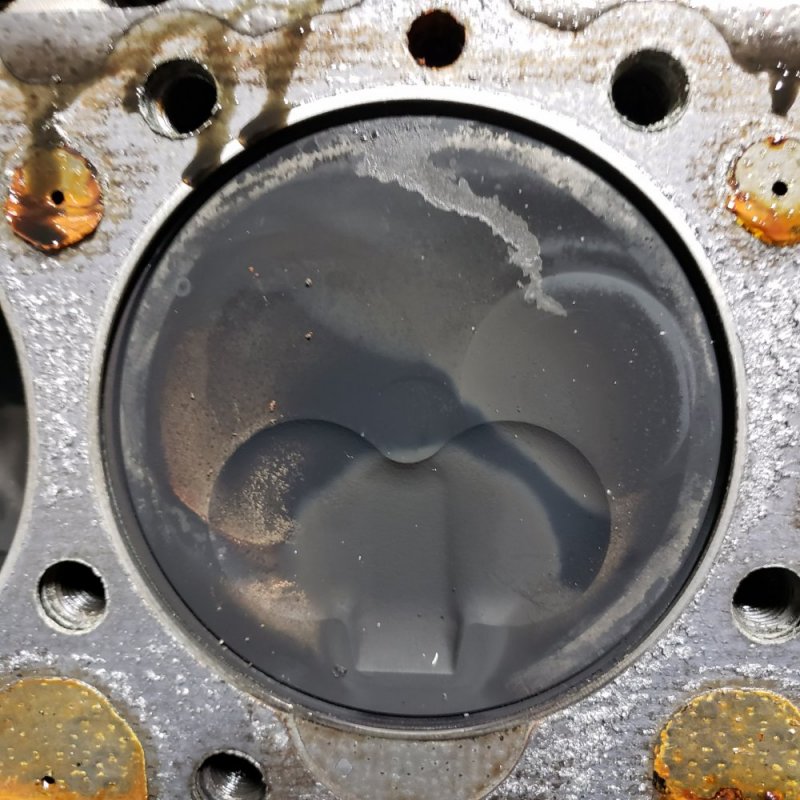

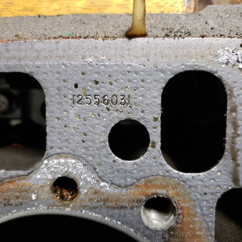

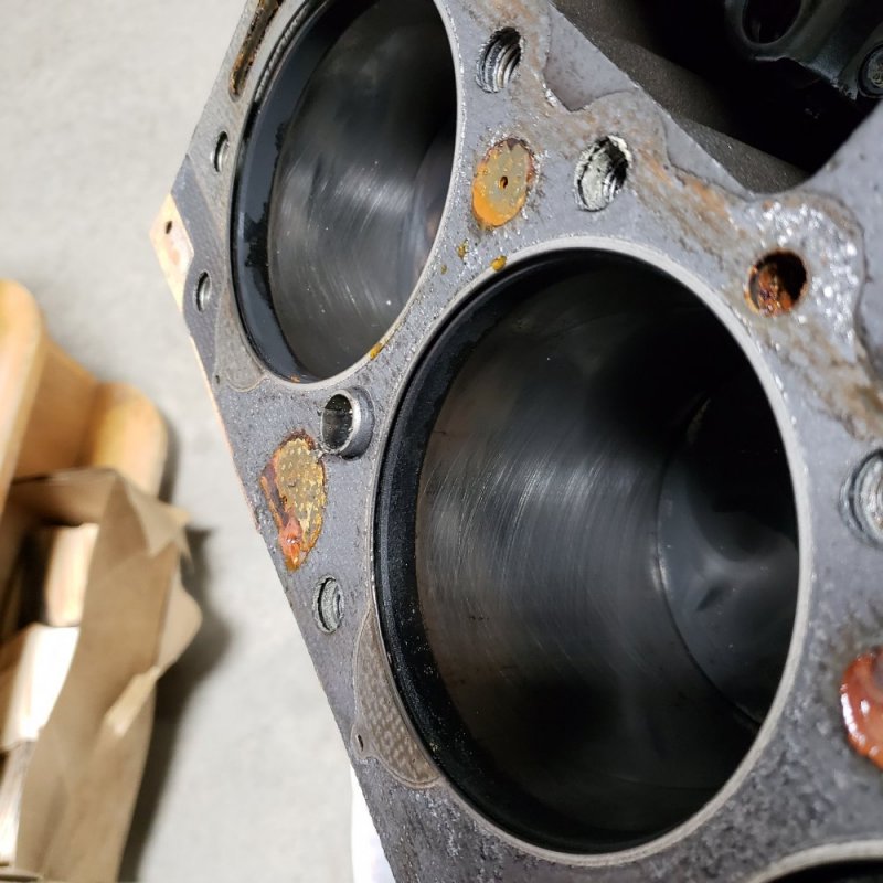

All 6 holes I can see have this for the crosshatching. I believe that's a good sign. Maybe it doesn't mean much since it's getting torn down anyhow, but I was still pleased.

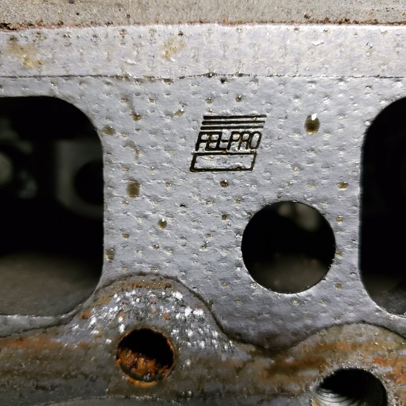

I had it in my mind the head gaskets would not be branded or if they were, that they would have been something custom to AMG or GEP. Are these standard issue for a new Optimizer when built?
