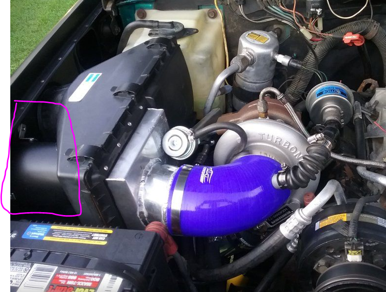

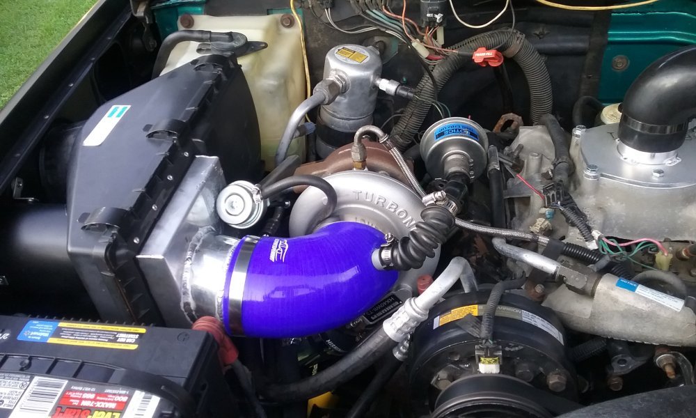

It's close, about 3/8". But I use a regular 5/16" Craftsman on it. Good eye catching my second intake tube into the fender. 4" sewer pipe screwed to the inner fender. Nice place to cut a hole through if you want to. My theory is, the fewer turns air has to make to get in and out of the engine, the better. I don't have a photo from the top that I can find, and I can't get one right now, since everything is out on the floor while I figure out the path forward on the block.
@93detroit I bet that 4" pipe you added also helps push and hold the air box straight not allowing it to move. the one on my 95 sits somewhat cocked forward where the factory rubber elbow is starting to contact the battery post chewing into the rubber. I was thinking about getting a piece of strap metal and running from the far side of the box to the inner fender pulling it back some so the boot isn't making contact or wiggling around.

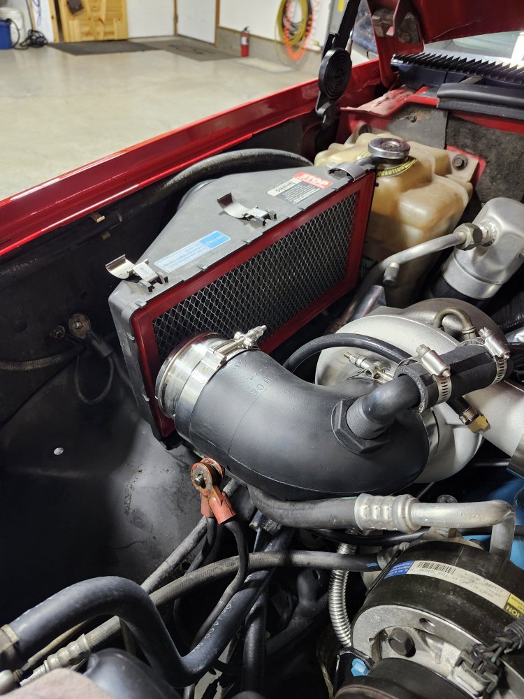

Here is what it looks like with the original filter housing. I think it's reasonable to see that it could be done. It's clean looking. The flow rate got my attention though.
Flat filter (46316) = 100 CFM per WIX
Large or small K47 filter (46441 or 46440) = 250 CFM per WIX

If you want to use this style filter and would like to strengthen the sealing areas, I had the thought of taking some small aluminum angle from home depot and riveting it to the inside under far enough below the lip so the angle doesn't contact the filter when closed. this will help hold the housing flat when it's clamped into place making a better seal.
I also found the spectre (similar to K & N) filter that fits these housings. they don't list it under the application, but I managed to find it crossing a fram part number on spectre's site. using this type filter and adding an oiled thin foam over it should be good catching most everything and have good air flow
