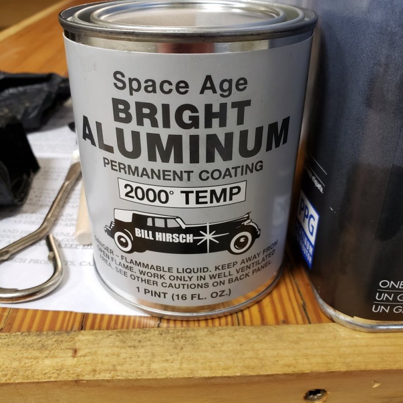

I could use the wifeys oven and get the same results, yes ?That aluminum parts are finished with the Bill Hirsch coating. I'm pleased with the cast pieces and lines. Right now they're at a local guy's place who can bake them at 300 deg. F for 10 mins. so they're cured out when I ship them back to Twisted Steel Performance.View attachment 81007View attachment 81008

Can You show a picture of coated products ?I picked up my parts yesterday and the powdercoater held them at 300 deg. F for 10 mins. He said it took about 45 mins to get up to temperature on the manifold. His shop still smells horrible from it. I'm hoping I got good adhesion since I didn't see any bubbling, which is supposed to be an indicator of an oily surface underneath after cured and brought to temperature. I'll plan to box everything up next week to send off to Twisted Steel Performance.
In case anyone is wondering, the pint shown above is WAY more than enough to coat all the part I coated.
