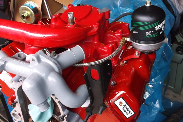

I just got the last radiator hose in, I will get coolant in it and get going again. I'm almost sure I got the starter fixed came to be defective bolts making it walk over. It also just occurred to me the whole time I have had this build thread know one has said anything about the valve covers. I figured someone would notice.
Had to go back in the thread to look, looks like two pass side covers. The sun is hitting it making it hard to ID.
Whats you plan with it?
I just did the same thing so I could install a centrifuge filter.
I am doing crankcase evacuation on both banks. With the amount of boost I want to run I need to keep crankcase pressure under control.
