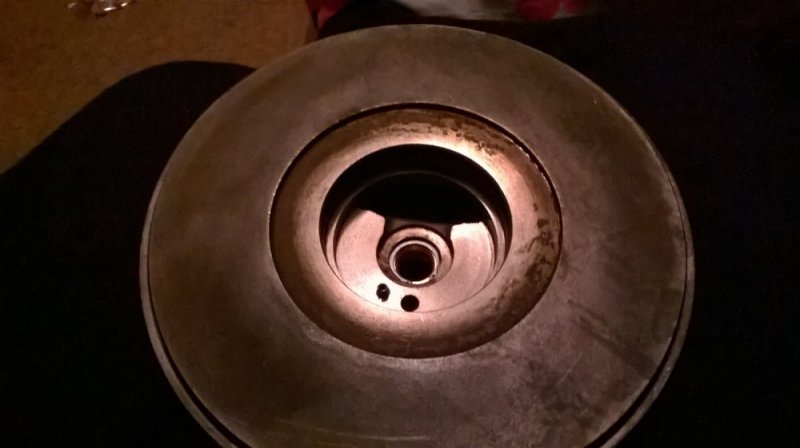

Thanks everyone for the compliments. Leroy it is idling high I have not done the timing learn yet so the ect sensor is unplugged causing the high idle. I was going to learn it but then started to have starter problems again. I don't understand why I am having such a hard time with the starter. I got under again after it slipped and held the pinion gear out and it hardly touches the flywheel. I have the correct bolts and the rear starter bracket is on and tight. The flywheel is new and so is the starter.
Seems like I remember a thread about a similar issue and it had the wrong flywheel on it. IIRC it was from a gasser
No gas flywheel on this engine. I have solved the starter problem for good. I investigated why it was slipping and found it was only engage on the very end of the teeth. I have the rear starter support and right bolts but still only touches the ends of the teeth. I had a buddy mill 1/8" of the mounting pad and bolted it up. It sounds like a stater now. It is quite and smooth, never skips a beat and doesn't sound like it is full of rocks. For anyone else that might have this problem have the mounting pad cut down. I do not recommend taking a grinder to it as you might not get it flat and cause more problems.

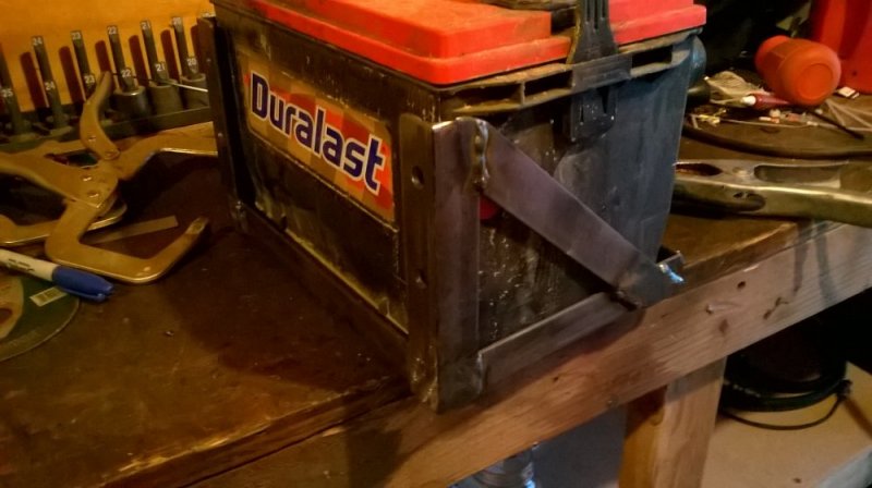

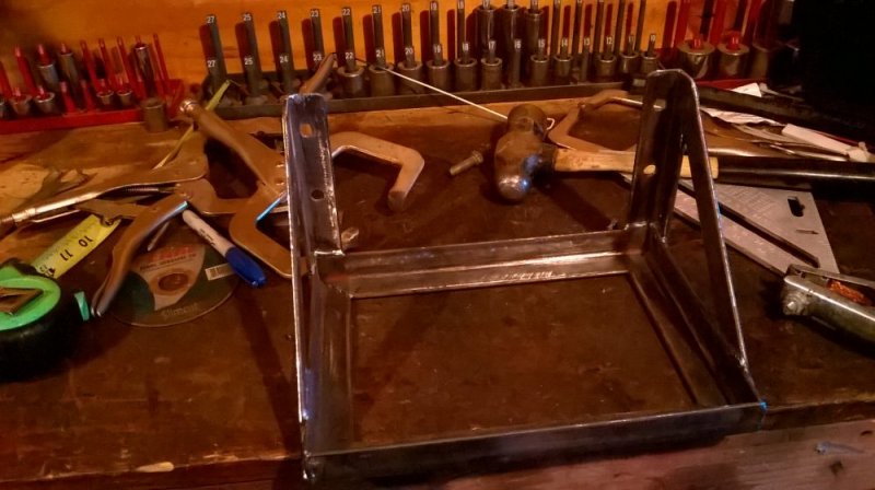

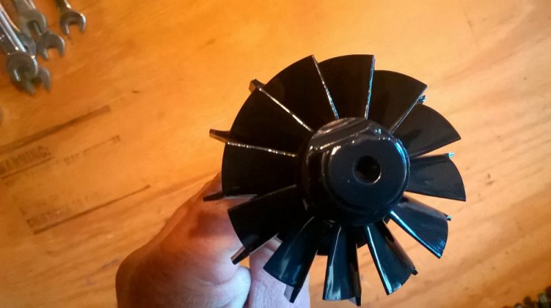

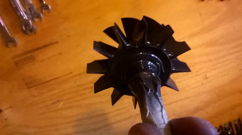

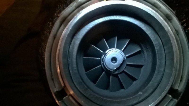

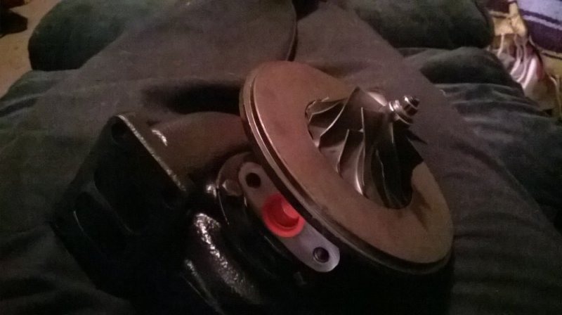

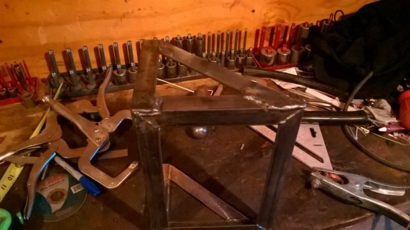

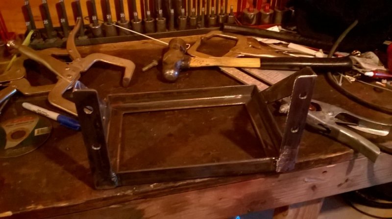

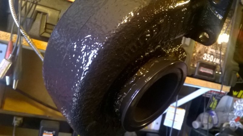

Update. The turbo decided to leak oil into the intake and exhaust. I overhauled the turbo and decided to ceramic coat the turbine and the heat shield to keep the heat out of the center section. I also made the battery tray. The battery is going under the right side of the bed. I will be using one group 78 900cca battery. I have tested this setup and have not had a problem even on the coldest day. Here are some pics the battery in the pics is not the one I will be using. I am using a side post battery to make it easy to remove the terminals.
WP_20151115_13_56_00_Pro.jpg WP_20151115_13_55_55_Pro.jpg WP_20151115_13_56_15_Pro.jpg WP_20151119_19_33_34_Pro.jpg WP_20151119_19_56_33_Pro.jpg WP_20151119_19_57_59_Pro.jpg WP_20151121_17_31_56_Pro.jpg WP_20151121_17_32_07_Pro.jpg WP_20151121_17_32_15_Pro.jpg WP_20151121_17_32_57_Pro.jpg
Why is there no room? The cold air intake is where the old battery was. Can not mount it on the other side because the oil cooler is there.
