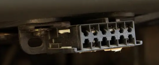

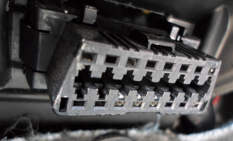

for OBD2, you'll need to find the fuel pump relay under the hood and jumper pins 30 and 87. the pump should run iirc. for the older OBD1 systems there is a pin in the data connector you can apply positive power to and turn on the pump, that won't work for yours.
other than that, find the pump on the frame and disconnect it's connector, run a ground to the black wire and positive to the red wire on the pump connector. you can use a cordless drill battery to do this so long as it's a not a 20v battery. 12, 14, and 18v battery will work, just don't run it very long on an 18v battery.
dbrannon79: Motorhome is 1996 Safari Trek 6.5TD . I have a OBD2
