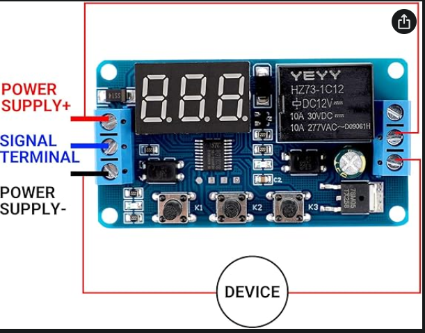

If it’s air getting in the fuel system overnight. Heat has nothing to do with the confirmation of anything. It is all about the purging of air in the fuel system, which then leaks down again after sitting overnight.With heat confirming the long crank time getting better, after testing each wire to the GP's and confirming 12+ when not connected, then it could be that you need more GP run time. the factory PCM was programmed at GM for the 11g GP's which get hotter quicker, but they burn out fast too. a double edge sword. try rigging up something to bypass the GP controller weather you use a screwdriver shorting across the controller contacts or wire in a second solenoid and a push button in the dash to do the same.
key on and let the PCM do it's thing with the wait to start, then manually override turning the GP's on for another 8 to 10 seconds, then crank and see what happens without the block heater.
