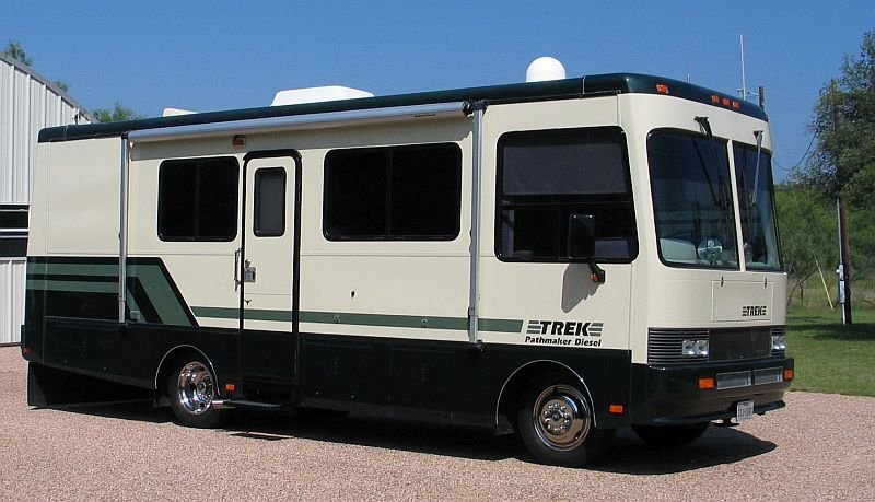

This is a picture of my motorhome. Tried to reduce in many ways to add to left side and that never worked. It was always too big after down sizing the picture many time.
