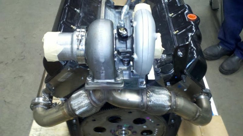

I went to see my engine today. I didn't get any pix yet because it was still wrapped up in shrink wrap. I did get a pretty good look at it though.
It looks nice, but I'm worried the turbo is in a place that may cause issues with the dog house cover. At the least, I'm going to have to build some sort of heat shield around it. It's mounted where the FFM normally sits. That means I'll have to relocate that somewhere that I can have access to it. Plus, I'll have to move the GP relay and the wire harness in the rear of the engine.
I was assuming that the rear mounted turbo would have been further back above the transmission, but I guess I was assuming wrong.

. . . I'm worried the turbo is in a place that may cause issues with the dog house cover. At the least, I'm going to have to build some sort of heat shield around it.

For the turbo, can probably mitigate heat either by a blanket or sending out for ceramic coating; same for any of the other components.

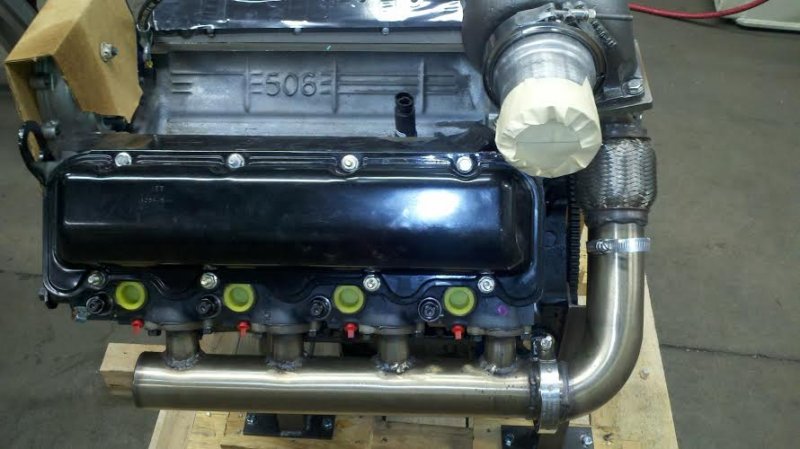

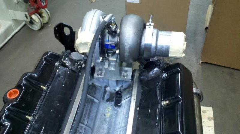

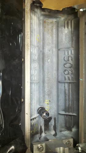

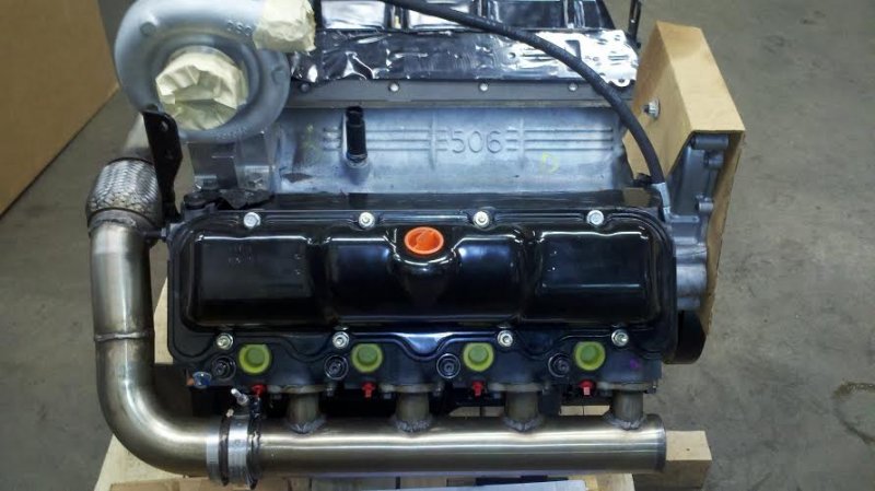

I visited the shop doing my repower today to check on the engine and components. I got some pix you all might enjoy looking at. And we are finding missing and wrong parts with this engine besides the damaged transmission. Now to move ahead with these new issues.p400-1.jpg p400-2.jpg p400-3.jpg p400-4.jpg p400-5.jpg
The PS pump needs to be new! Reman, well, just pull one out of the junkyard as it will last longer...
Already factored in, along with the alternator, vac pump (decided to stick with stock vs fabricating an electric one in. I've only had 1 fail me since I've been driving 6.5s, 1994 and it didn't fail, was just making noise), all new hoses and anything else that can be easily replaced now as the engine is out.

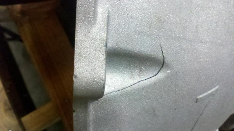

Here's a picture of the damage to the transmission, that happened during shipping. I'm still waiting for news on what and when.broken.jpg
Is that strike 3? If so, it should be smooth sailing now... Nothing like having the camper all set to go in the middle of freaking January in Minnesota...

That turbo setup is pretty. Welding doesn't look like the greatest but that should spool/flow nicely.
