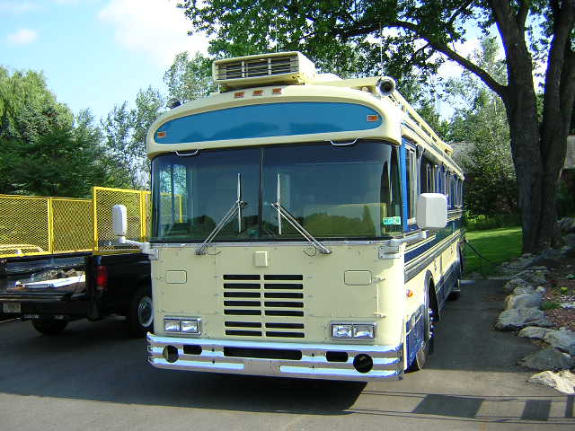

My shop installed the engine shown into a bus similar to vehicle above, front opens up pretty well, pull and put power train as a unit, front supported by fork truck, trans by a 2500# capacity trans jack dolly, rolls right out. Went from NA to a turbo, exhaust replacement and relocation, some gauge upgrade, bit of puttering with the throttle linkage. It was about 50 hours two guys on it full time. Sounds like the shop doing the work is close on the bid.
60 hours seems about right, it adds up real quick. Also agreed on having all the parts there, nothing worse than starting a project without everything and you are stop and go, makes it very painful and also makes it more expensive hour wise.

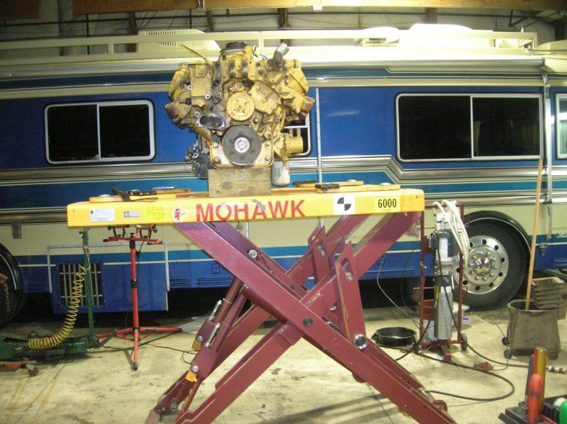

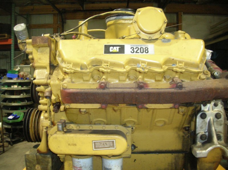

Just got an email from Peninsular, they say the new transmission and water pump will ship tomorrow. They also said the injectors were installed in the engine, per their engine builder. Hmmm, I don't see any in the photos that I took posted.
Maybe they are those special invisible units, high output. :rolleyes: :p
They are the new yellow ones, you know the ones that don't need injector lines. They receive the fuel through osmosis.
