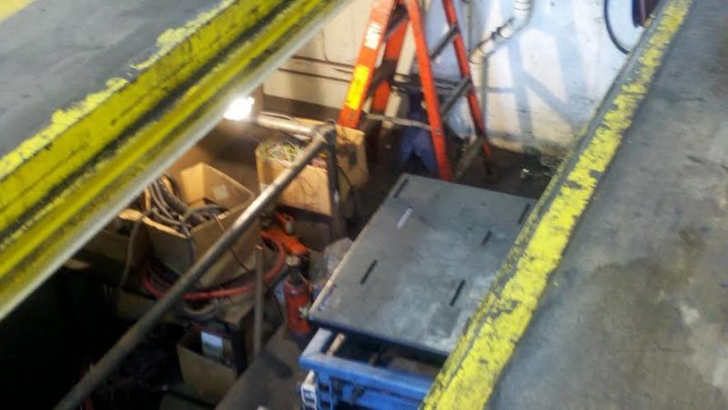

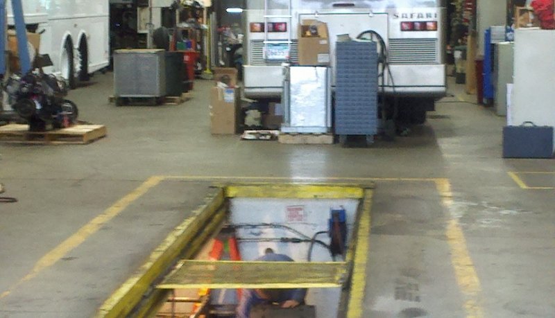

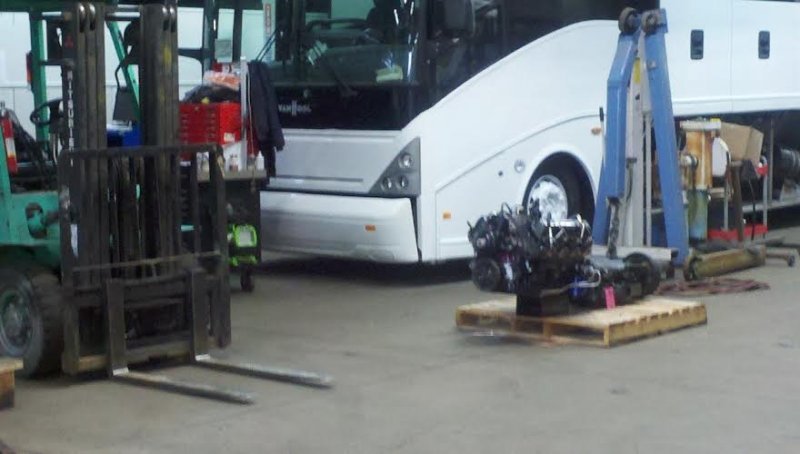

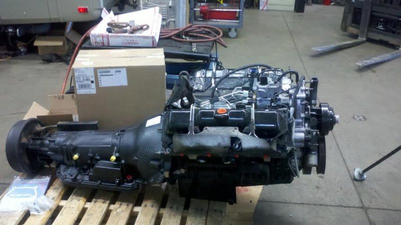

Visited the shop today. Got a photo of the engine/transmission.
As I was there they were getting ready to lift the engine into the pit.
I'm thinking that by the end of the day, the engine will be in place. Then to hook up everything and fabricate a new 4in exhaust.
motorhome engine.jpg motorhome pit 1.jpg motorhome pit 2.jpg motorhome engine and forklift.jpg
I always found it easier to put the turbo and manifolds on before install. But there may be clearance issues doing that on yours?

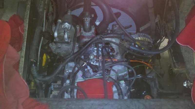

The engine is in. :)
They are now hooking up all the stuff. I reminded them to ensure the grounds are connected properly.
When they get the headers on, they'll mount the turbo to see if the floor will need to be trimmed for clearance, because of the rear mounted turbo vs side mount. (although Peninsular said it would fit fine) That's why my installer left the exhaust headers off while installing the engine. They removed them before taking the engine out too.
Another thing is that I'm glad I had the Moroso pan, because there were doubts that the frankenpan would have cleared the chassis.
Is that a CS144 alt?
I found out the hard way even 2wd trucks/burbs need a new oil pan, kind of sucks cause it drives the cost of the swap up even more.
Yes, that is the CS144. I thought it was supposed to be plug and play, but we needed to get a different plug end and splice it in.

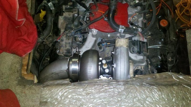

engine n turbo.jpg The wheels of progress are turning slowly, but turning.
The latest is that they found leaks in the AC pump/compressor. They also have the exhaust mocked up, so now they can reroute the wires and FFM that were displaced by the relocated turbo/exhaust.
Still looks like there is a lot to do yet, to me.
Are you running a turbo blanket and some header wrap to keep things cool?

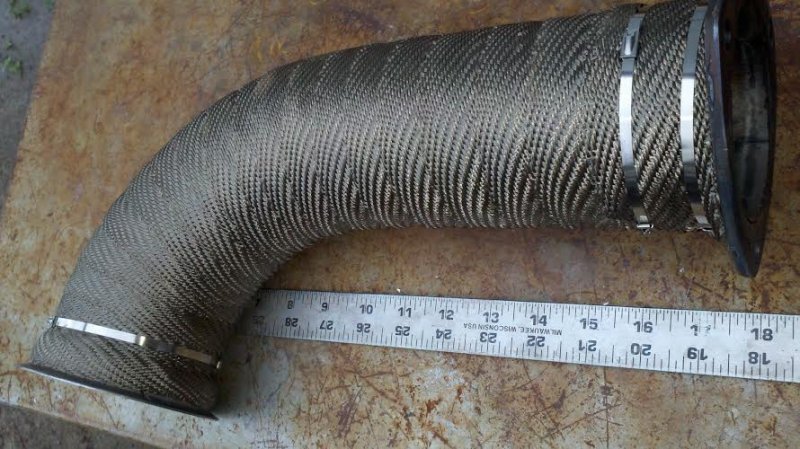

Yes, I have the headers wrapped and I have a turbo blanket too. When they get the down pipe finished, I will wrap that also.

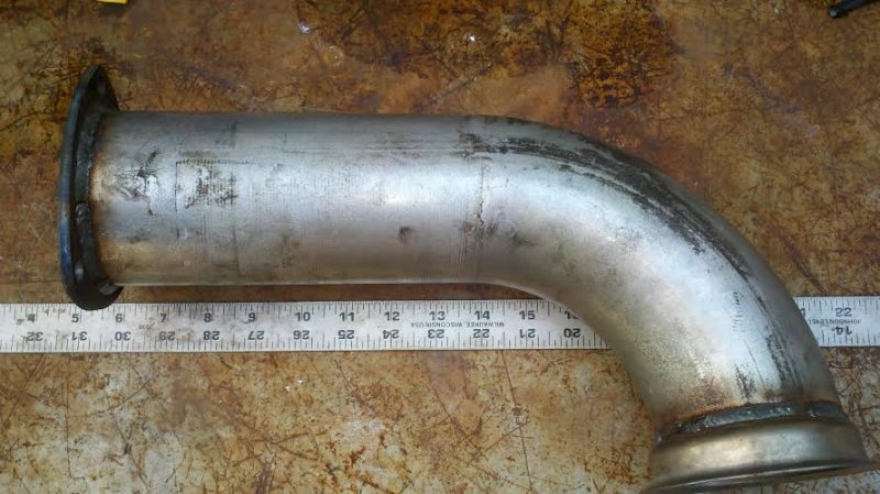

It looks like they had to trim some more of the floor to clear the 3 1/2in elbow coming out of the turbo.

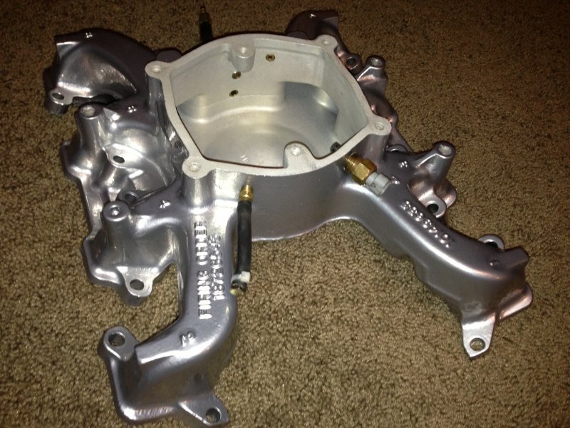

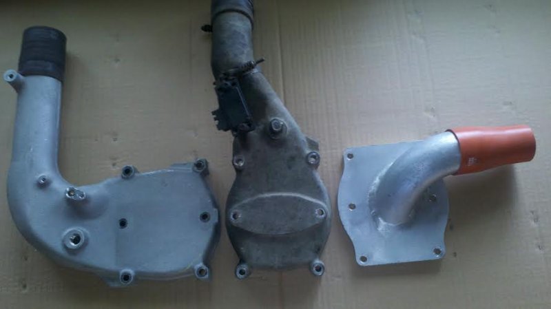

Here's a pic of 3 upper intakes. Left to right are: standard, motorhome (Workhorse chassis) and the supplied (from Peninsular) rear mounted turbo upper intake. Note: there is no place to mount the IAT or booster pressure sensors on the Peninsular one. Looks like I need to do some fabrication.
You can tap the Peninsular's plate 1/8npt for a barbed fitting for the boost sensor and 3/8npt for the AIT sensor or
Tap the lower intake.
I guess the only issue with tapping the lower is possibly having to remove it to do the job but.
I'd offer up the tried and true spacer design I have but I'm not giving up mine...sorry, too selfish I guess.
What's the exhaust manifold look like for one of those motorhome turbo setups? I have a GM4 Turbo off one of those setups, curious what the manifold looked like. Upper intake is sure different.
The original manifold or the custom one?

I have to go back over there later today to pick up the down pipe so I can wrap it and take it back in the morning.
