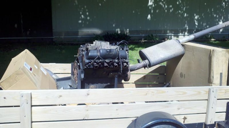

Selling it? Rebuilding it? Scrapping it? Where is the vulture smiley when you need it? :woot:
