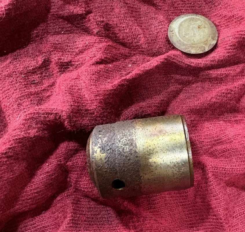

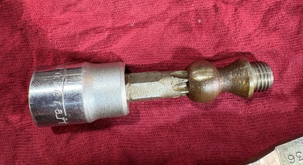

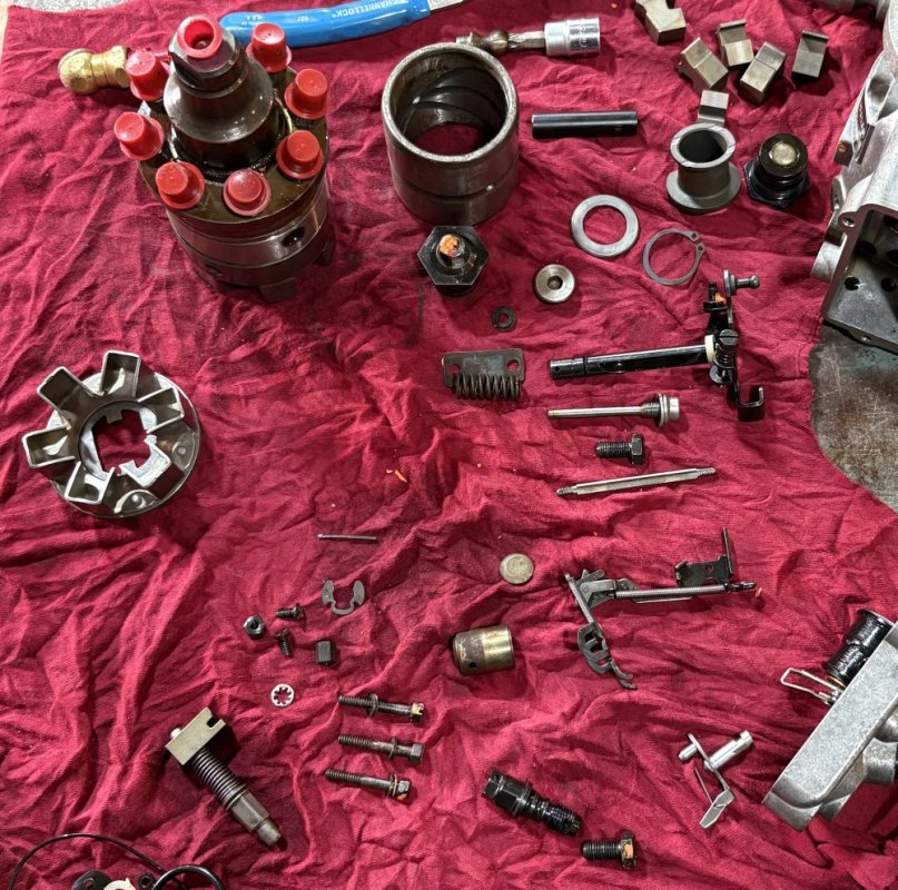

Here are some pictures of all the parts on a table after taking the pump apart.Everything is pretty good except the Bristol drive bolt and advance piston due to the rust.The Bristol drive bolt is brittle and easy to break.I usually place a torx bit into the bolt with a couple small whacks of a hammer and then use a impact gun to whip it out.A ratchet will not work.I’ve seen them split and fall apart when trying to use a ratchet.

Curious if this bristol bolt is present on a DB2 IP for our 6.2's / 6/5's. where is this bolt located on or in the IP?
It’s only found on olds 5.7 pencil injection pumps along with older John Deere and case roosamaster DB and DB2 pumps.The 6.2/6.5 just has a small pin that slides into the cam ring.This particular Bristol drive bolt threads into the cam ring on the olds pencil pump.The olds diesel with poppet injection has the same steel pin as the 6.2/6.5 DB2 pumps also.
The 5.7 pencil pump has no mechanical light load advance lever on the outside.So thats the particular pump with the threaded Bristol drive bolt.

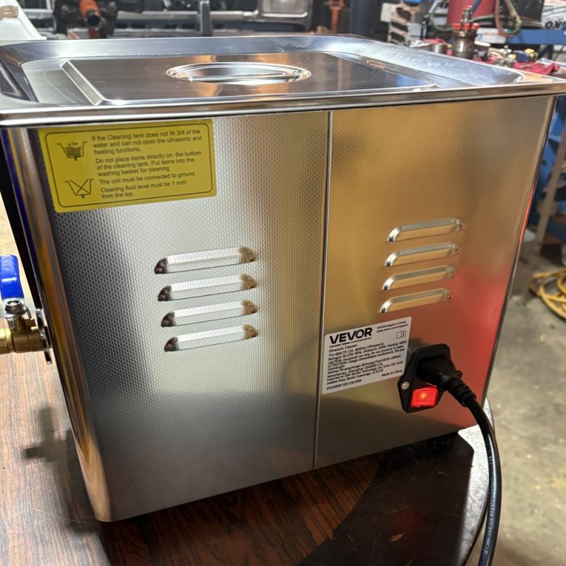

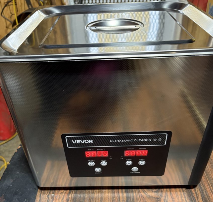

I used the vevor brand ultrasonic cleaner for the first time today and I was really impressed how well it cleaned up all the internal parts within the injection pump.The pump needed to be disassembled anyway to get rid of the flex ring and once I did,I found stuck pumping plungers.They are now nice and free.Its been about 15yrs since this pump was used so its been quite awhile.
I have some of the pump assembled.Tomorrow I hope to finish it and reinstall it upon the engine and get it running.I used some deep creep penetrating fluid upon the plungers and rotor assembly before inserting into the hydraulic head section.
I also tried freeing up two new old stock 5.7 pencil injectors in the ultrasonic cleaner and both injectors have pintles that are stuck pretty good at this point.I disassembled both injectors before putting them in the cleaner.I sprayed deep creep down inside each one after taking them out and blowing them dry with compressed air in hopes that it will work the pintles free.

Nice! the one I have is a chineeesium special from amazon. I ordered the one with a mechanical timer and knob dial for the temp thinking that the digital one might go bad before the rest of it failed. I'd rather go mechanical over electronics when possible.
I found on cleaning fluids that you can use just about anything. I really like the ZEP de-greaser from home depot for it. it seems to knock off all carbon and even dissolves most surface rust. it did wonders with 6.5 injectors! sometimes I'll even go as far as pouring the cleaning solution in a glass jar and nuke it in the microwave to get it hot prior to starting up the machine.
get you some paint filters from harbor freight and use them to filter out what's in the machine and keep reusing it till it gets too grimy!

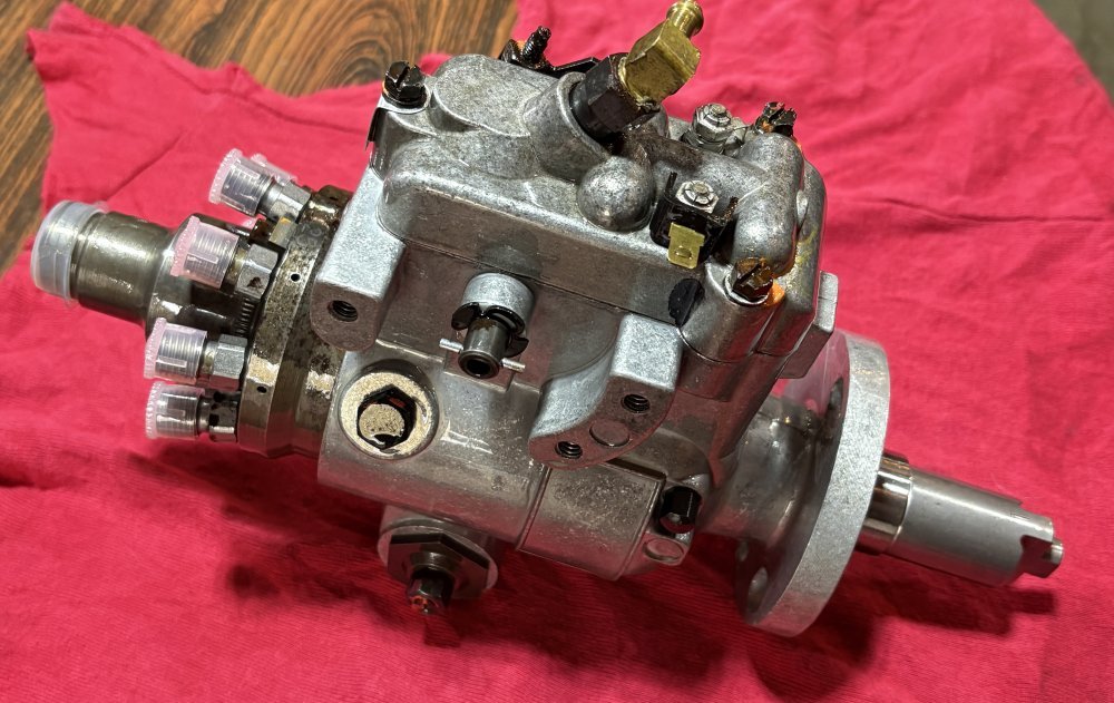

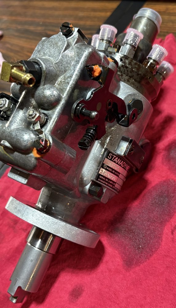

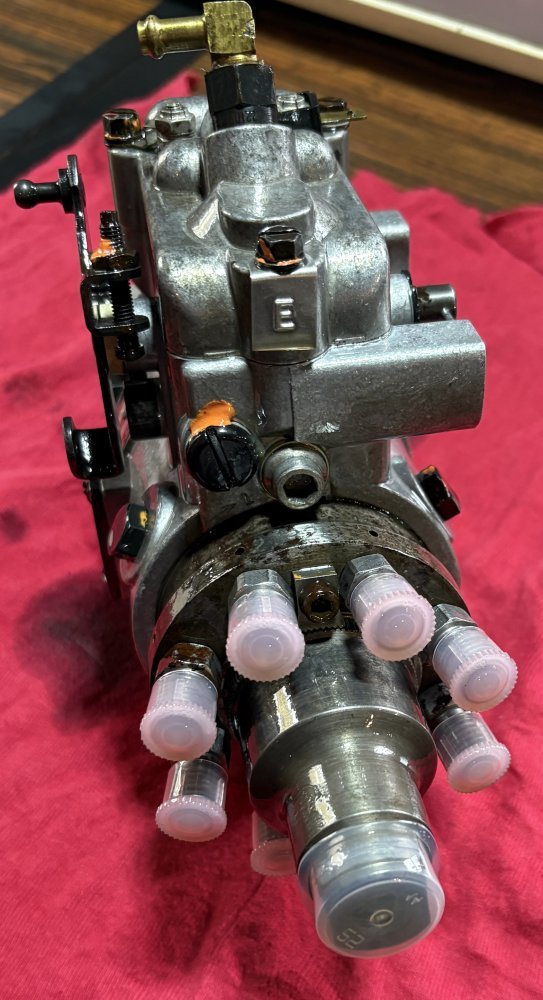

The 3271 pencil injection pump is back together and ready to go back on the truck.I bench tested it with some fuel and cordless drill and it’s spraying fuel pretty nicely like it’s supposed to.Hoping tomorrow to have it installed.The ultrasonic cleaner did a great job of getting all the internal parts cleaned up.A new spaco seal kit was used along with the EID.
The 3916 pump I just took off the engine was rebuilt at some point in the past but it has a sticky metering valve,etc.The throttle speed increases on its own without touching the fuel pedal.More than likely it needs to be dismantled and gone through.Probably has corrosion,etc going on inside.
I have another spaco brand seal kit on the way so I’ll take the 3916 pump apart and run the parts in the ultrasonic cleaner.It has the “E” tag on it also but I’m sure it’ll work great again once everything is cleaned up and reassembled.Here are some pictures of the 3271 reassembled.

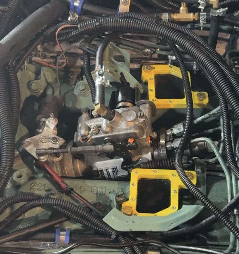

This morning I got the 3271 pump into place.No issues with it.No leaks anywhere.This pump is definitely much much better than the last two pumps I had on this engine recently.It idles nice and smooth.I’m quite happy with it.The last two 3916 pumps I had on this engine the engine would rock from side to side and misfire badly when I attempted to slow down the idle speed.It definitely wasn’t running properly with the 3916.
I got the engine up to operating temperature and drained off the Joe Gibbs’s break-in oil and refilled with Mobil delvac 15W40 synthetic blend with another oil filter.Oil pressure is perfect.Its showing almost 40psi just above hot idle.Oil pressure when cold is around 70-75 psi.

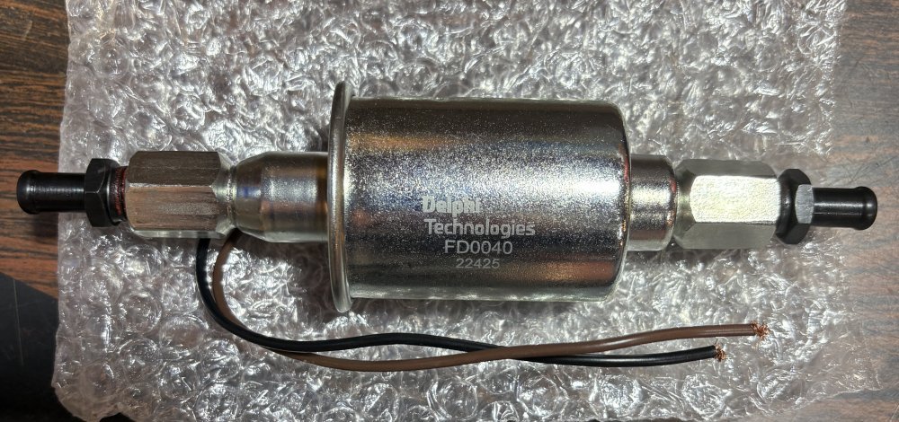

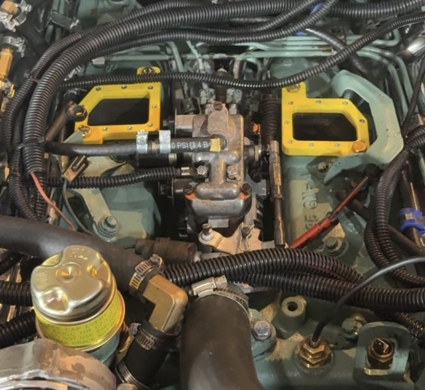

Here are a couple pictures showing the pump back into place.I put a fuel pressure gauge in position under the hood just before the injection pump and it’s only showing just above 3psi.I’d like to see at least 6 when it’s running.I have a new Delphi lift pump I bought not long ago so I plan to put that lift pump on and see if the fuel pressure improves.

I have the Delphi lift pump ready for installation.Hoping tomorrow morning to put it in place.Its rated for 12psi so this pump should do a better job overall vs the current lift pump.

On the DB2 going from memory I believe anything over 10 psi will blow the pump driveshaft seals.On my truck the fuel has to pass through two filters so it’s slowing down the flow and pressure too.So with this Delphi pump the pressure should be where I want it once it’s up and running.
I have a fuel pressure gauge in place under the hood.I’m only seeing just a hair over 3psi going into the injection pump when it’s running.The gauge is placed after the two filters so I’m measuring pressure entering the injection pump.
That's where to check it
I’m hoping to see 6-7psi entering the injection pump inlet after the Delphi lift pump has been installed.I’ll let you guys know how it turns out.I’ll take a video showing the fuel pump pressure as well.
