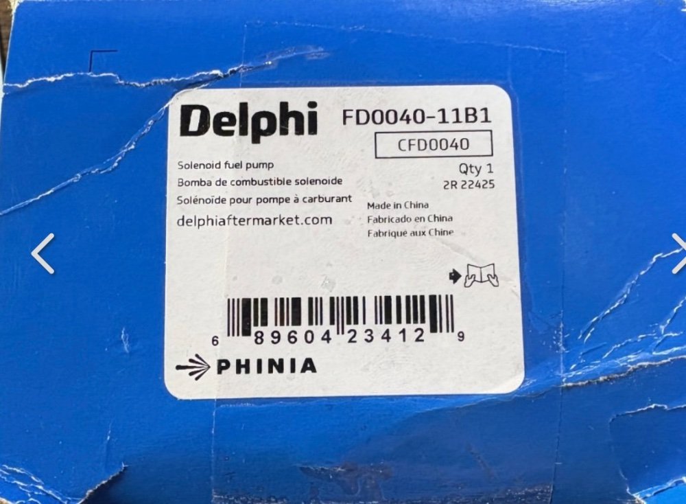

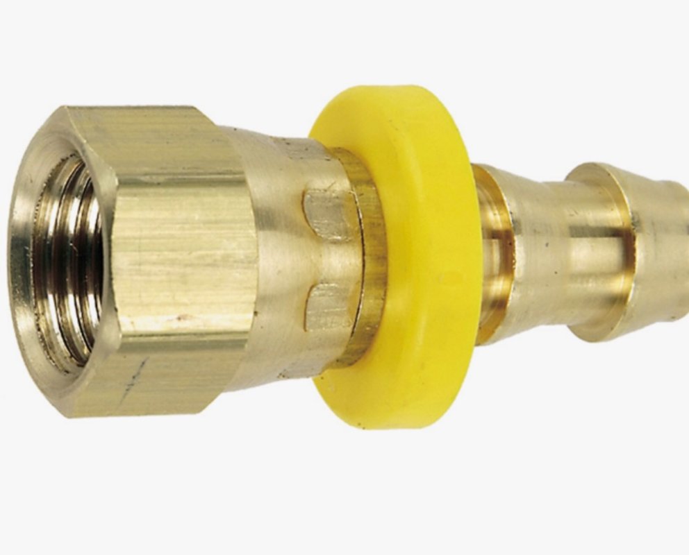

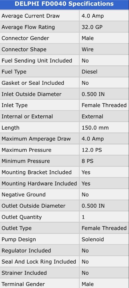

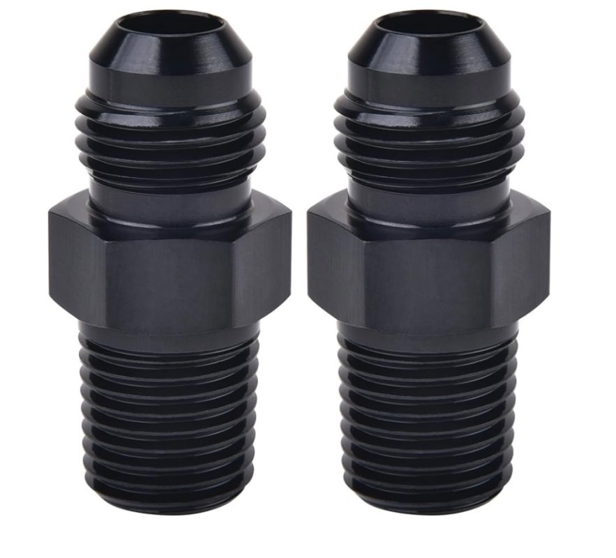

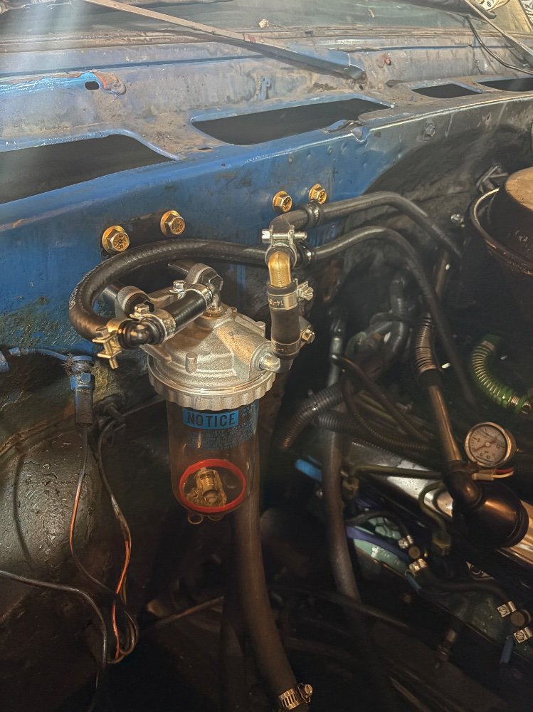

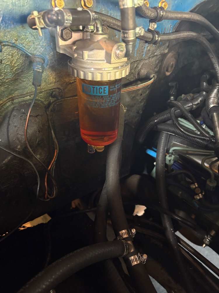

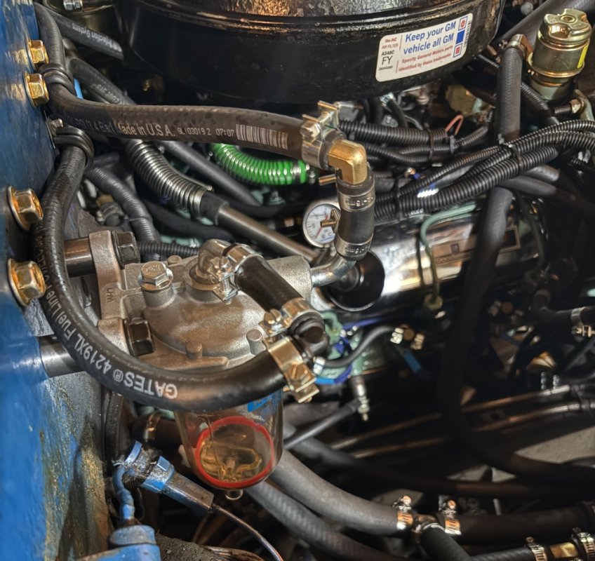

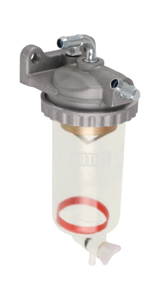

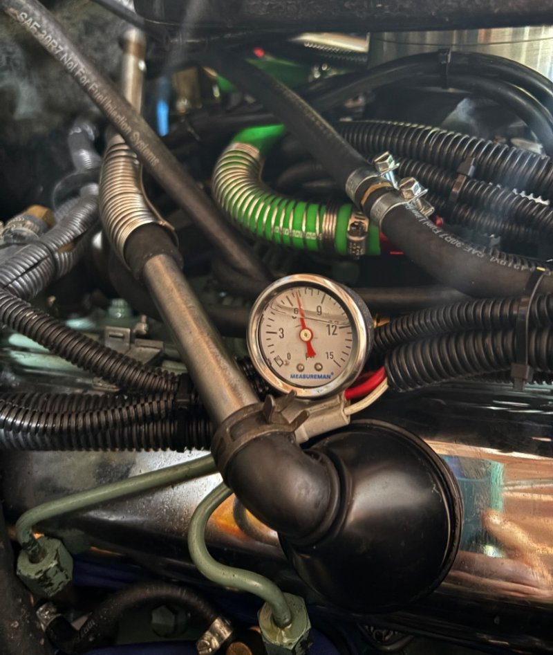

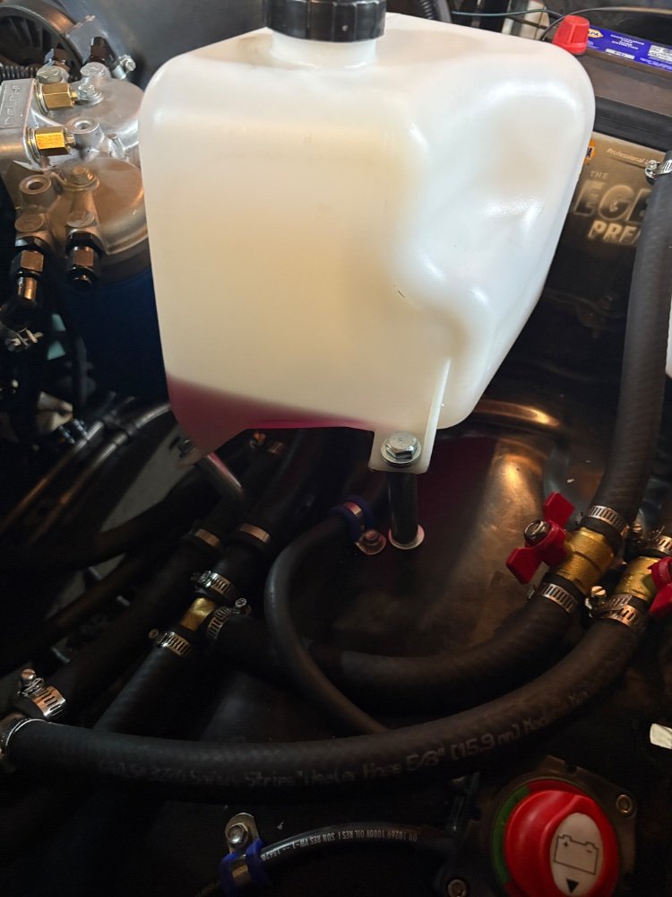

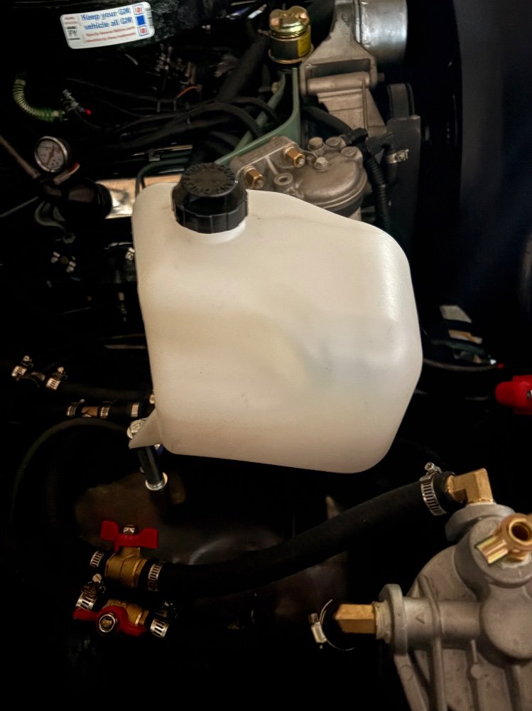

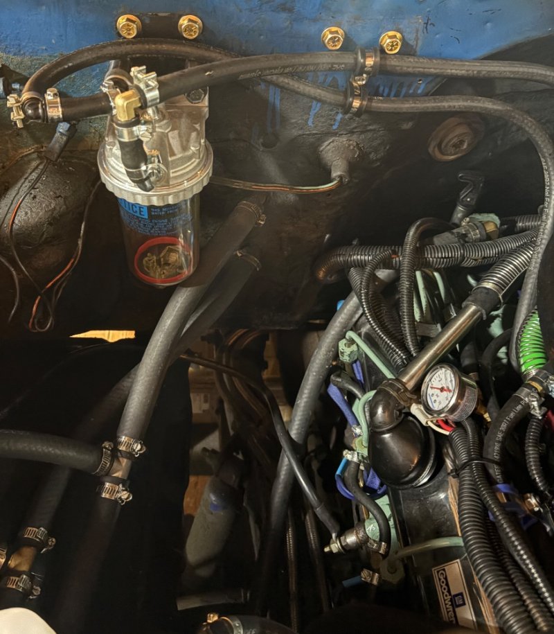

Absolutely.I hope it works out also will.I used new 3/8 fuel line hose as the supply.I’ll take a picture of the Delphi lift pump and the fittings I used tomorrow.I like the way it runs though.Much better than before.I have a digital fuel pressure gauge I plan to use to monitor pressure under load,etc.
Here’s more information on this lift pump and the fittings I chose to use in the lower two pictures.
