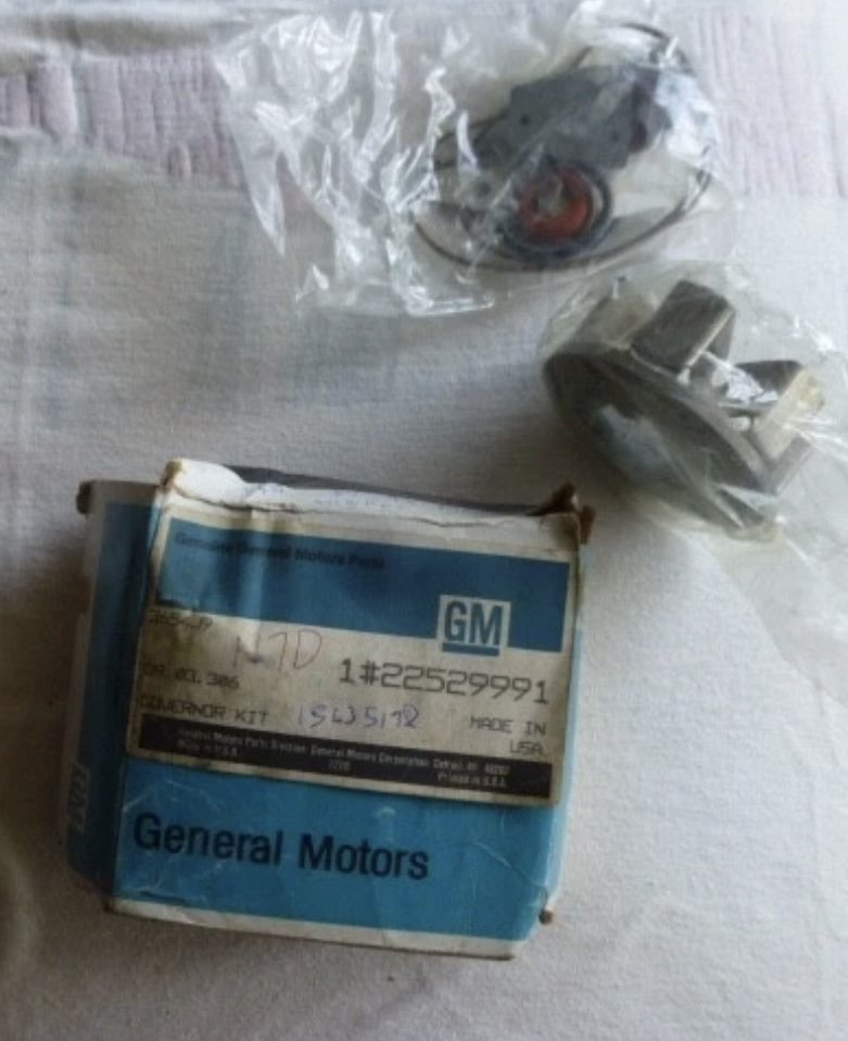

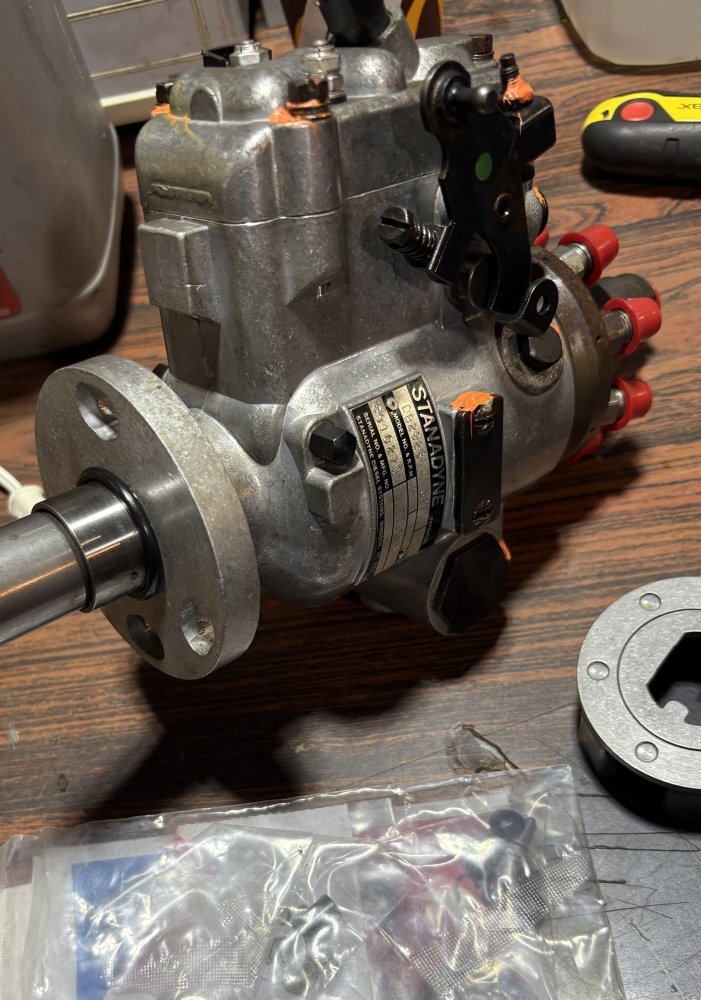

Thanks jay.I’ll definitely look into that and give it a go.Yesterday on eBay I came across a new elastomer insert drive governor cage which does away with the flex ring along with a o-ring/seal kit.I have a new old stock 3271 pencil injector pump that doesn’t have much use on it.It has no E tag on one of the governor screws like my current pump does so I want to take it apart and get rid of the flex ring altogether and set it aside for when I do need it.I also bought the updated idle spring kit that I’ve used on other pumps in the past.

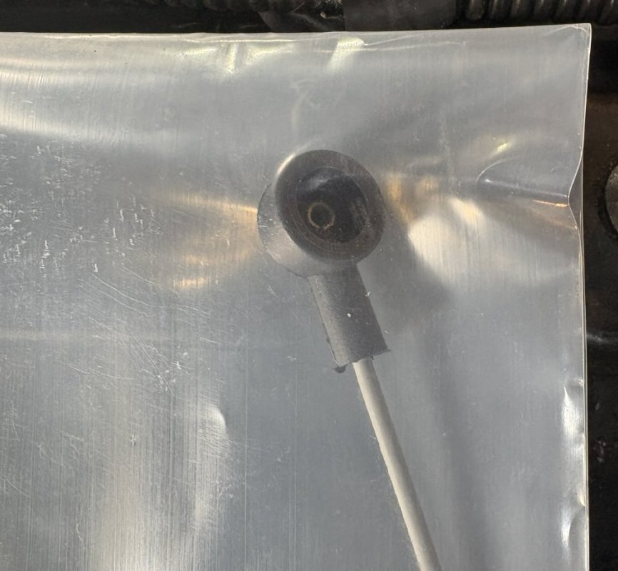

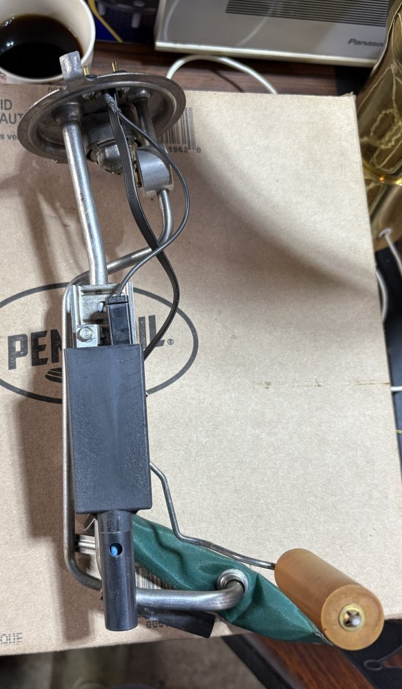

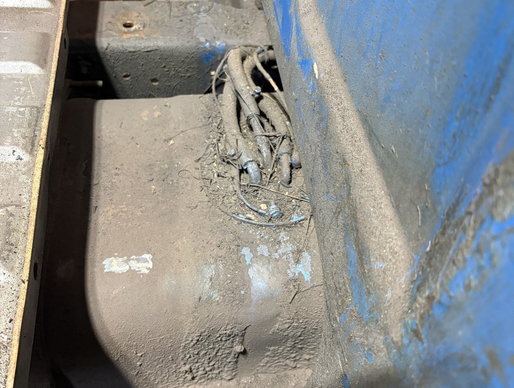

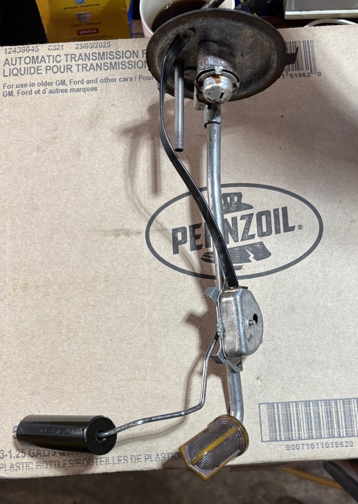

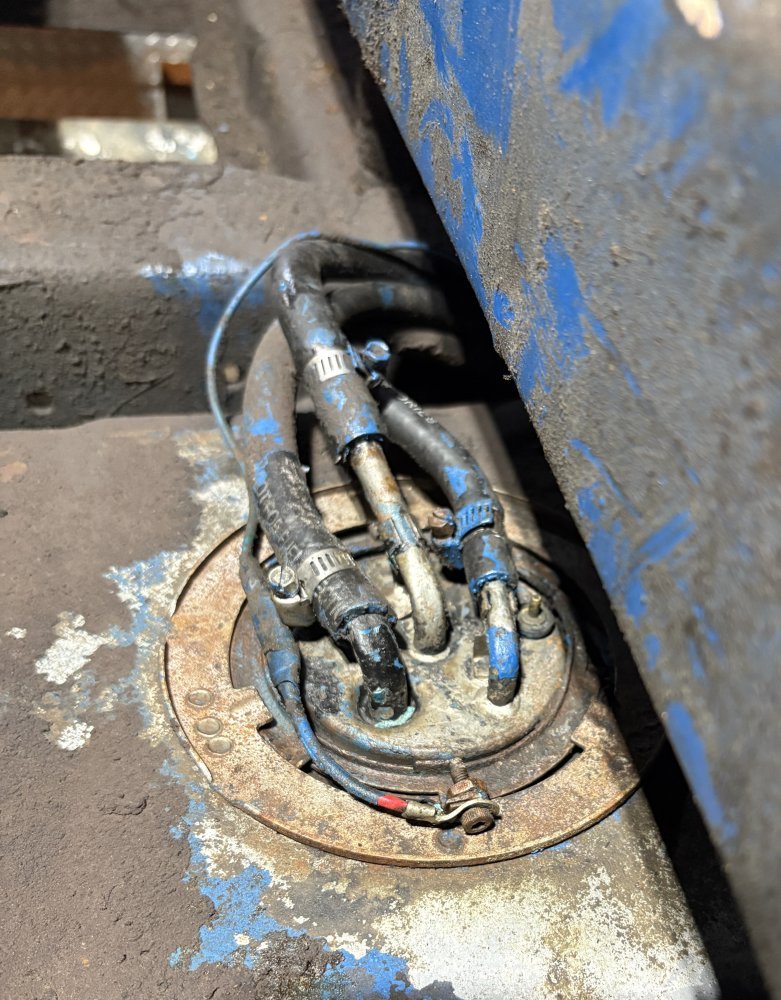

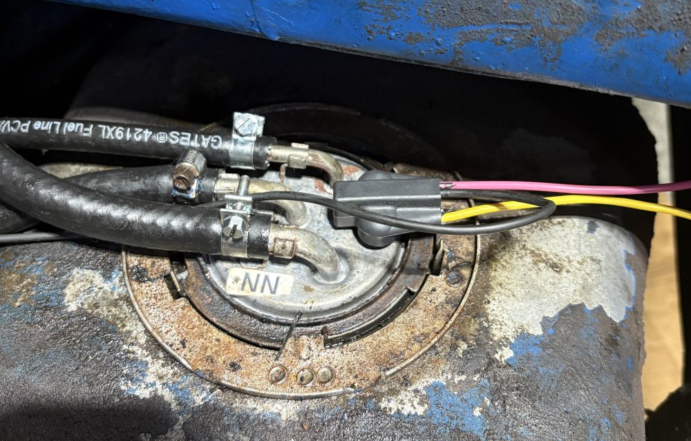

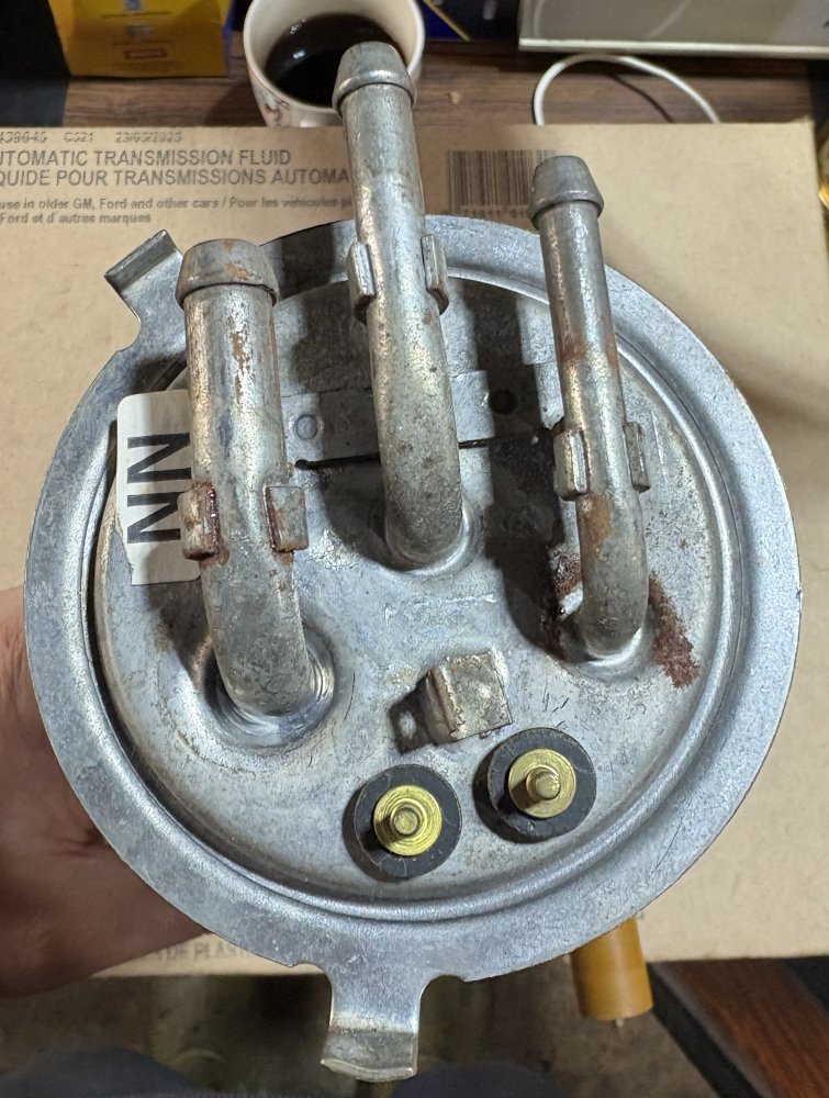

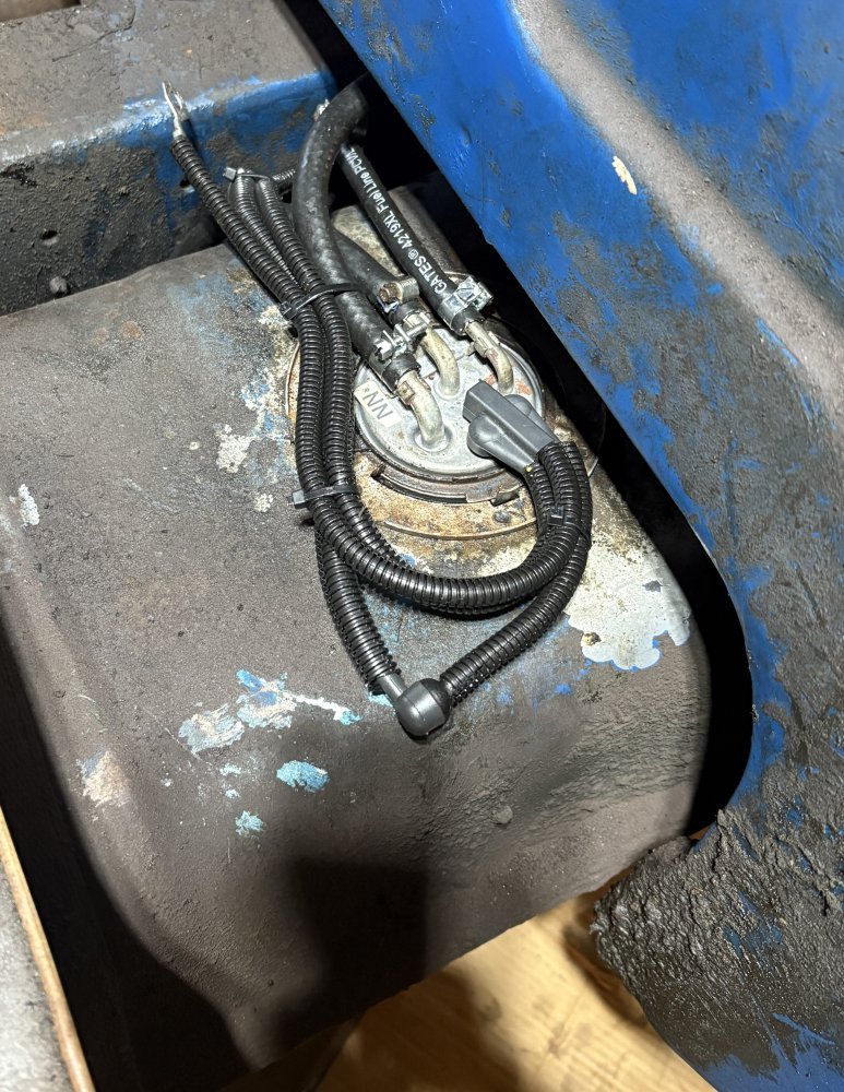

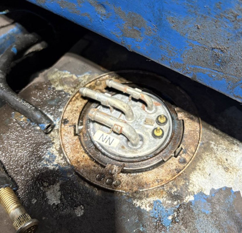

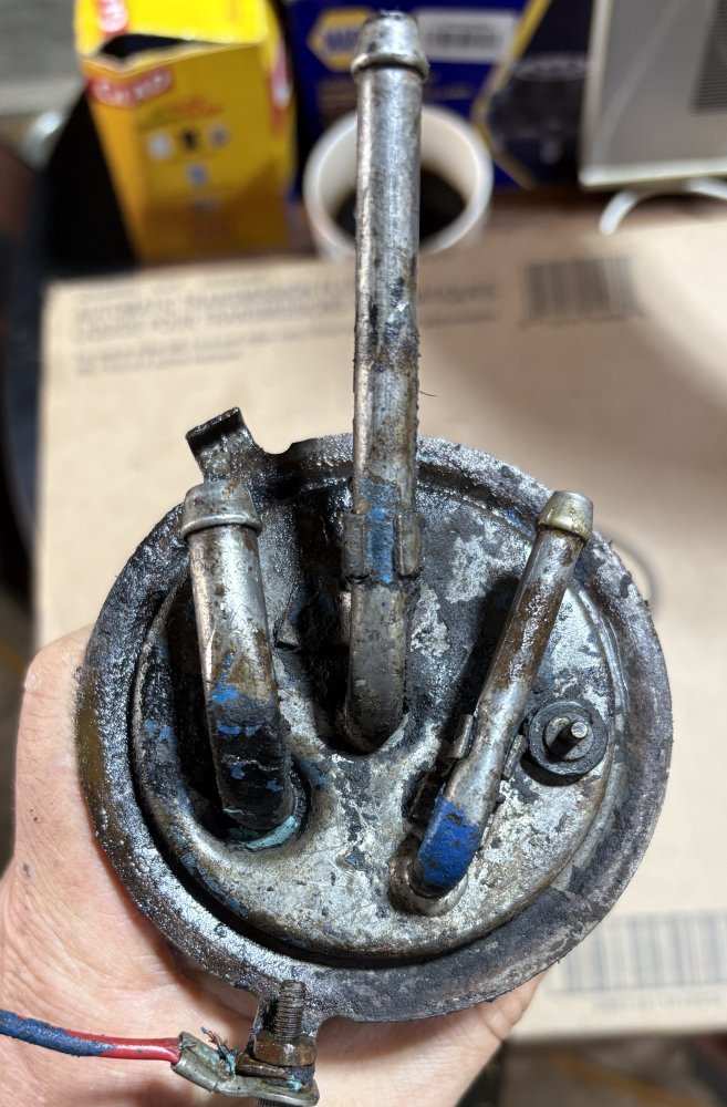

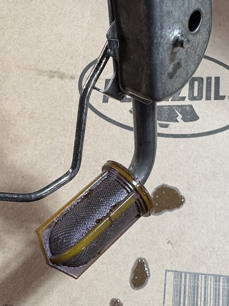

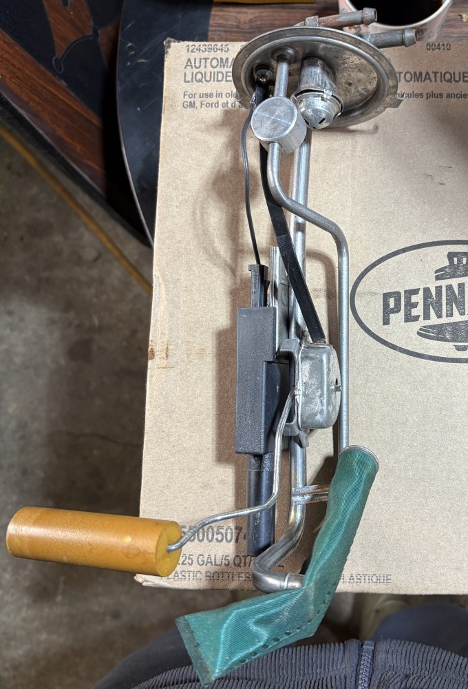

Today I made a stab at replacing the old fuel tank sending unit in favor of a updated version with the water in fuel sensor.The old fuel line hoses are gone now.I got rid of all that along the chassis.Tomorrow I hope to install the new hoses and get the water in fuel wiring started.The old sending unit has a paint gun screen upon it that my father installed many years ago.

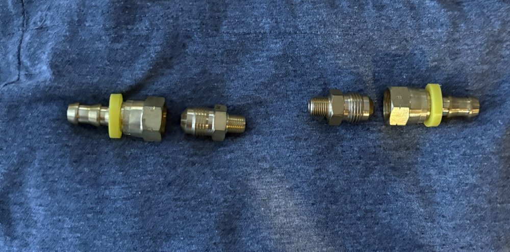

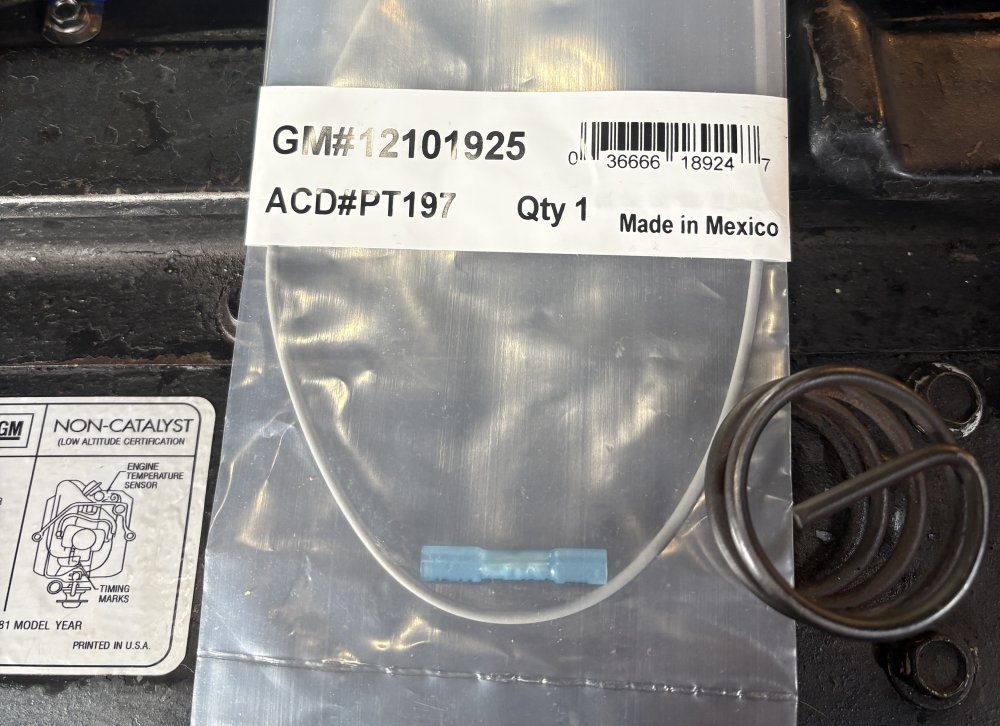

I think this will be a great feature when I finally have the water in fuel harness all in place.The new fuel lines are installed along the chassis up to the sending unit.The wiring connector is in position at the sending unit.I just need to run the harness along the chassis now and into the cab.I also have some brass fittings to go from 3/8 Barb to 1/8 npt which is what the lift pump uses upon the frame.Right now it has 5/16 Barb to 1/8 npt but I’m changing out those fittings tonight.

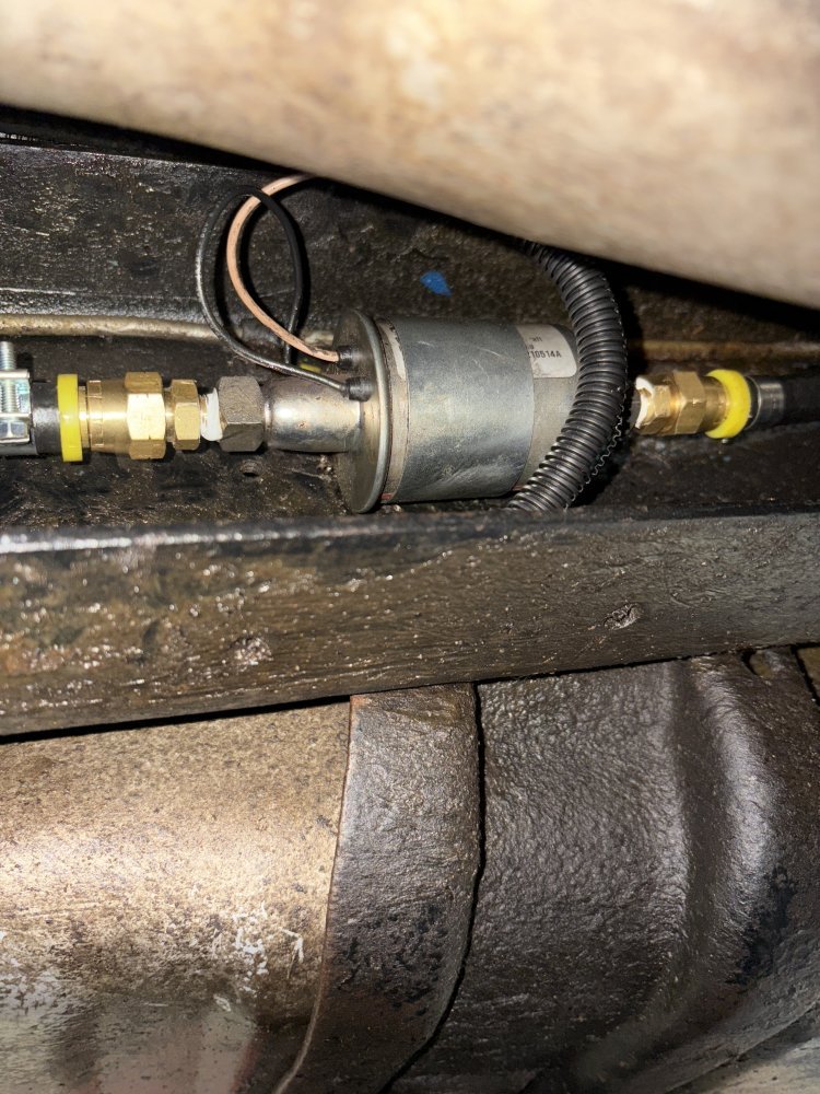

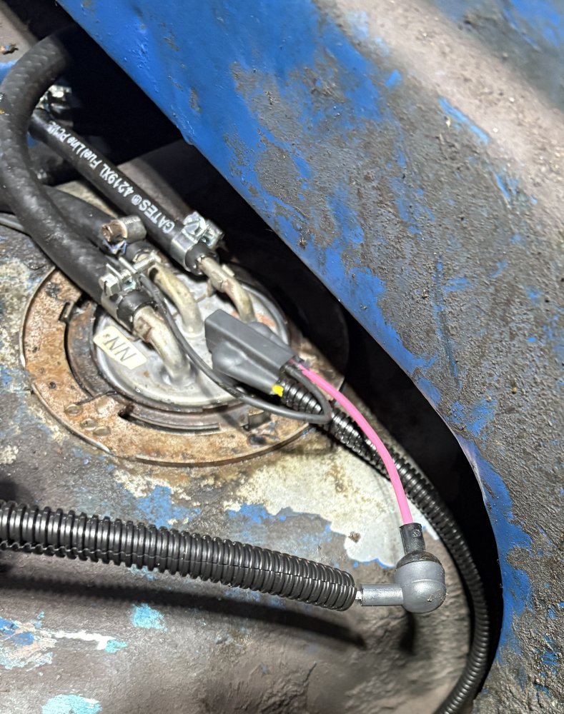

Today the new fuel hoses and water in fuel wiring was installed along the chassis.The 3/8 Barb-1/8 npt fittings were installed into the electric lift pump under the truck so all went okay with that.Just a matter now of getting the wiring in place inside the truck in regard to the water in fuel option and that’ll be completed.I used some Adele isolator clamps to keep the fuel lines secure to the chassis.

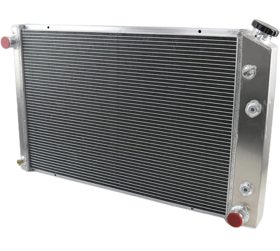

Yesterday I noticed a small amount of coolant under the radiator on one side.Has all new hoses and clamps on it.New petcock with sealer on the threads as well.It must have a small pinhole in it someplace.This morning I ordered a new all aluminum radiator on Amazon with good reviews so I went ahead and got it.Total was around $350.Also wanted to show a picture of the lift pump under the truck with the 3/8 Barb fittings in place.

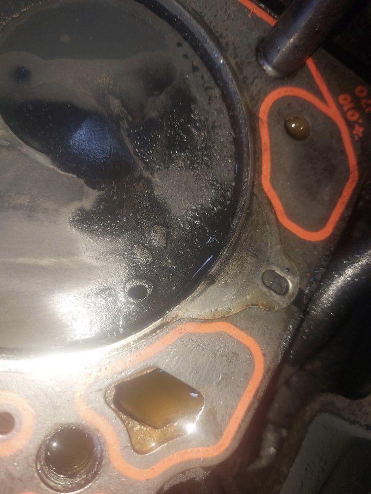

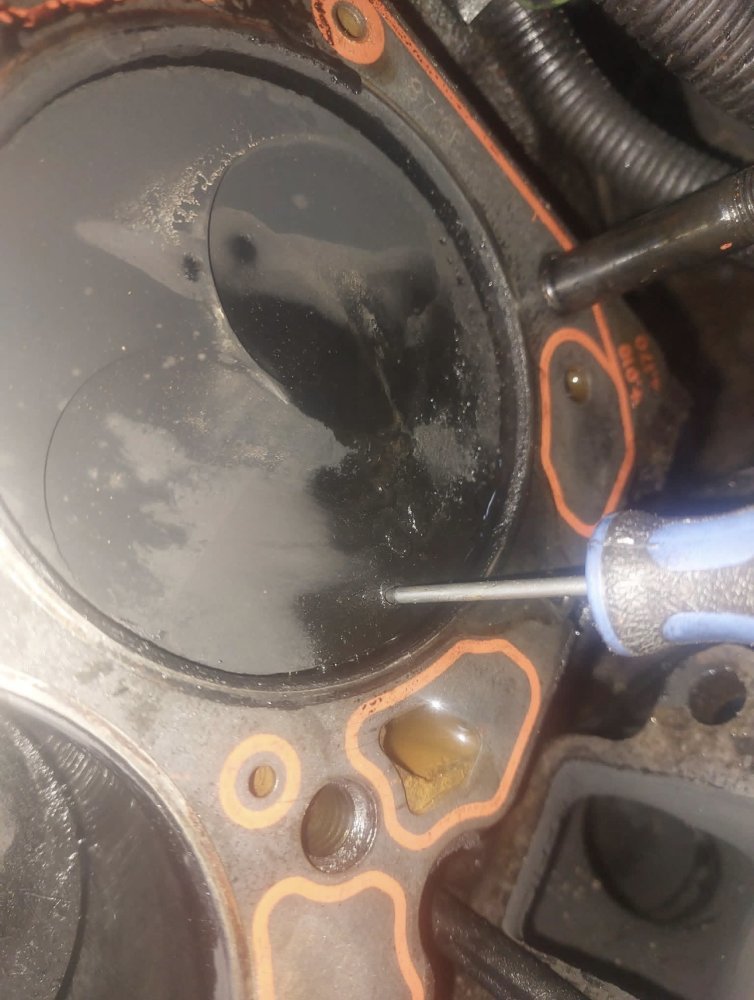

Here are a couple pictures I found online showing a hole in a 5.7 diesel piston because of a bad pencil injector.I’ve never seen this happen on the olds diesel.Very interesting to see that’s for sure.Supposedly the owner was saying the engine ran pretty good all along until this happened.
It definitely pays to have your injectors checked and gone through if necessary by a pump/injector shop with a good reputation that knows what they are doing.Any of you guys hear of Dennis Erickson?He is supposed to be a good guy with these pumps and injectors.

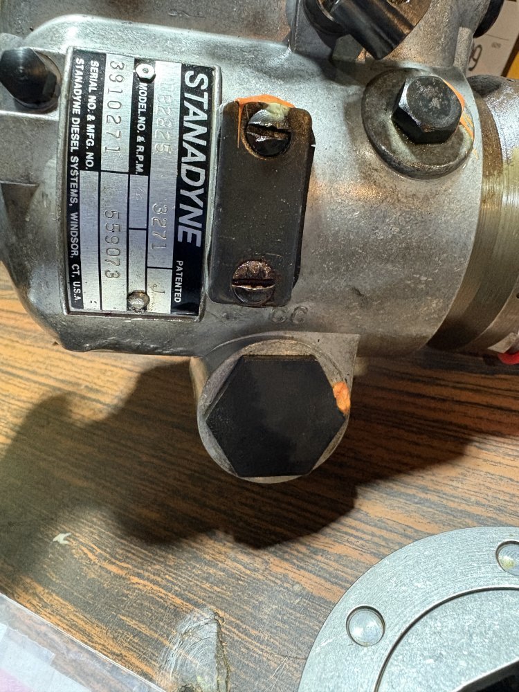

I have a 3271 pencil injector pump I plan to put a EID inside along with a new spaco seal kit.Theres no “E” tag on the governor cover screw so it most likely still has the flex ring inside.The umbrella seals are leaking also on the driveshaft.I’ve used this pump I’m going to say at least 15yrs ago and I had no problems with it aside from leaky driveshaft seals.

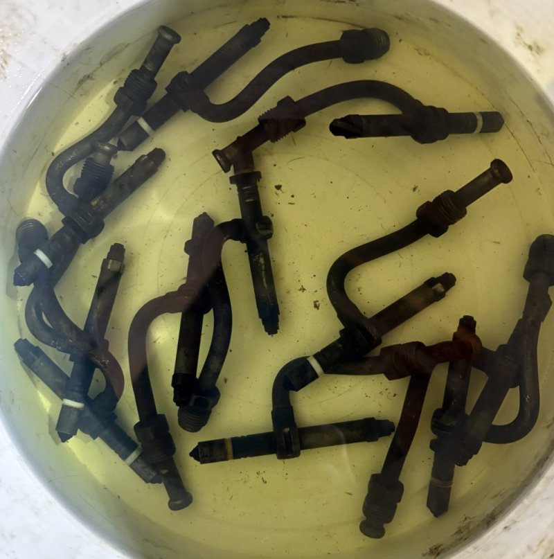

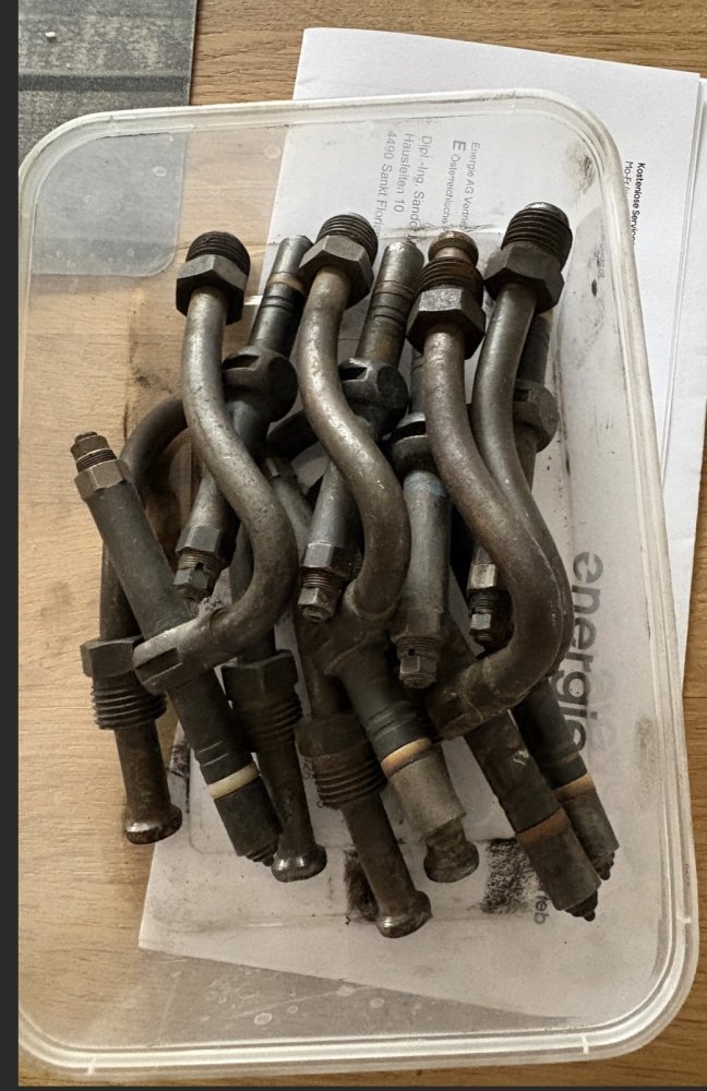

Also pictured are some used ferrule style 1978 pencil injectors that I bought a few years ago from eBay along with victor reinz head gaskets among other things from the same seller.I haven’t used these particular injectors but they could very well be perfect.I have them soaking in some diesel fuel at the moment.

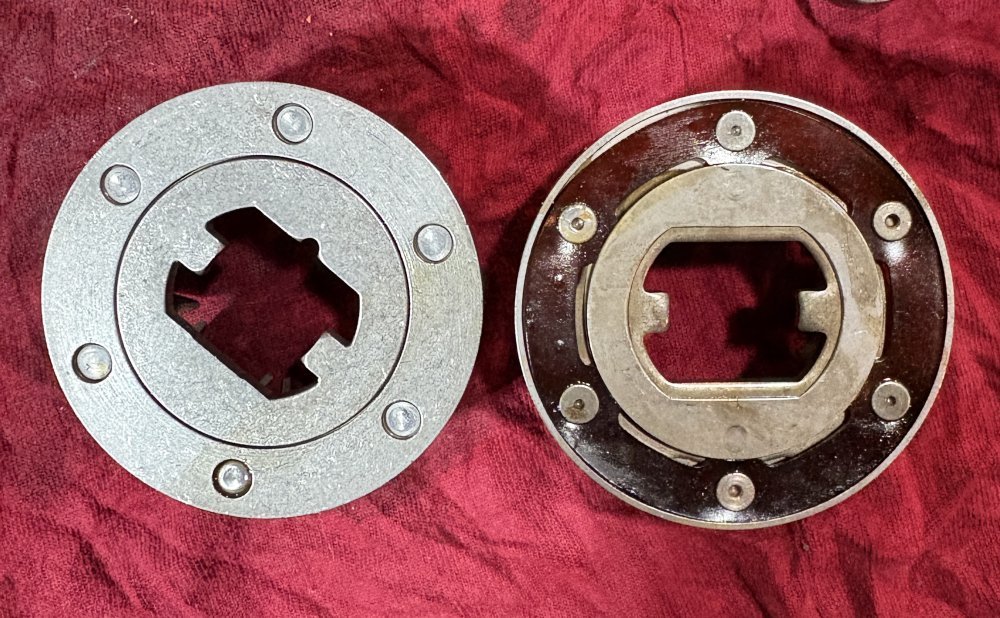

Tonight the 3271 pump is apart.I found some rust on the metering valve area and down in the advance piston section.It had the flex ring as I suspected.It was on the verge of turning black and flaking away but the updated EID version will take care of that area.
I plan to use my ultrasonic cleaner maybe on Monday and clean up all the internal parts and reassemble things on Tuesday if things go as planned.
