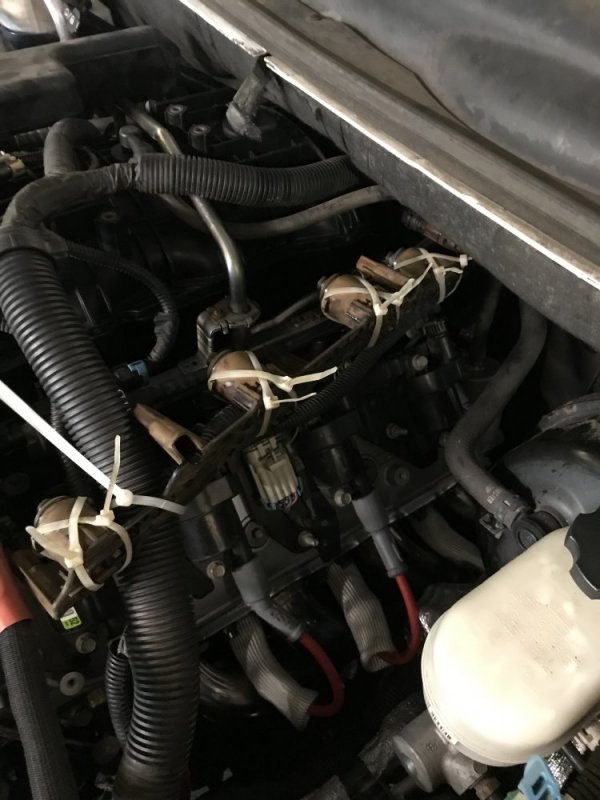

I was talking to a friend of mine at work today about the Envoy and he suggested trying to plug the cylinder deactivation solenoids in and see if that makes it run a little better. Sounded like it was worth a try! So I disassembled them from the plate and plugged them in. I also unhooked the battery to reset the computer. Well it still isn’t happy and is dropping cylinders, but at least now it stays running in gear....though it still won’t go above idle in gear. At least I should be able to drive it onto the trailer which will help me out on Sunday when I load it up to take it to the tuner.

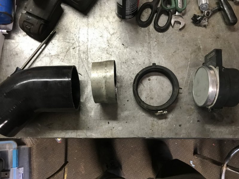

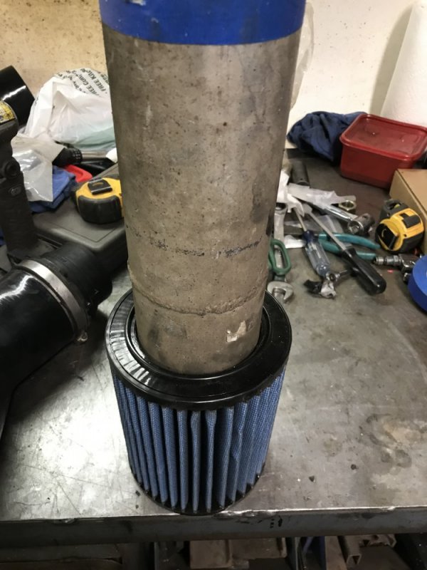

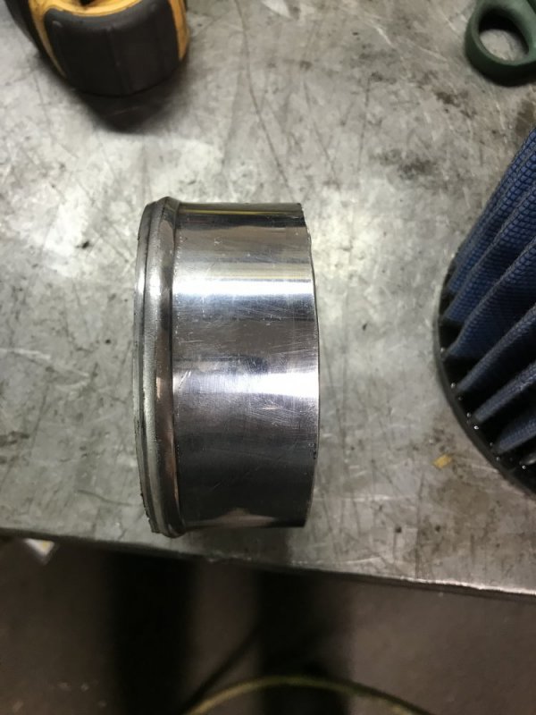

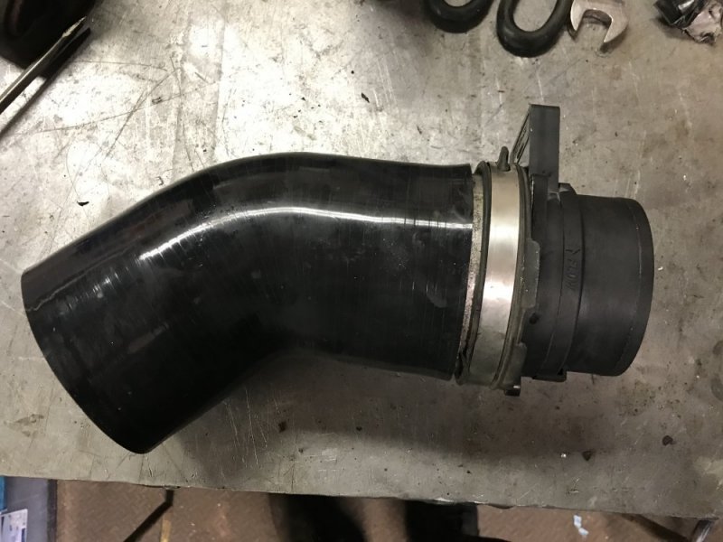

After that I switched back to the air intake. I cut the ID of the air filter so it will now accommodate a piece of 4” exhaust pipe.
This pipe is just stuck in it for illustration purposes - something else will be in here eventually.

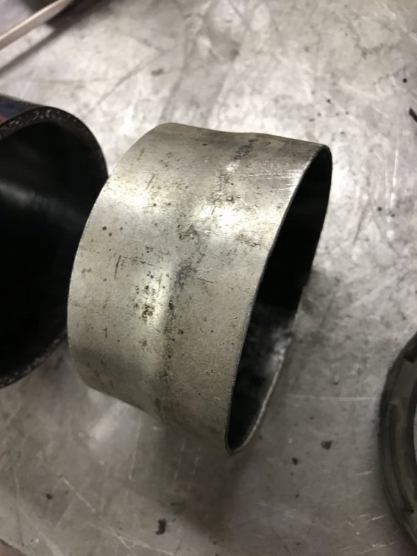

Then I found that a piece of flared 4” was perfect for fitting in the original MAF clamp/grommet so I cut a small piece that is a perfect adapter from the MAF to the 4” silicone elbow.
103CADAD-B124-4098-B63B-76541DB2CA8E.jpeg269A22A5-F072-43BF-9A95-01B9FAD54621.jpeg4C576AB9-EF43-41FB-B0C6-8497272EAB9F.jpeg

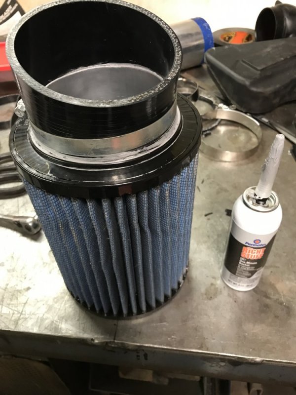

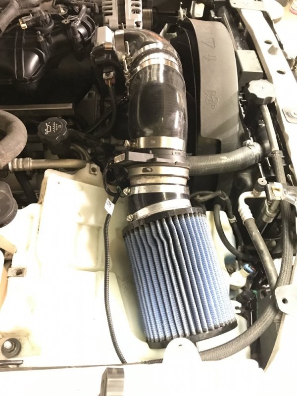

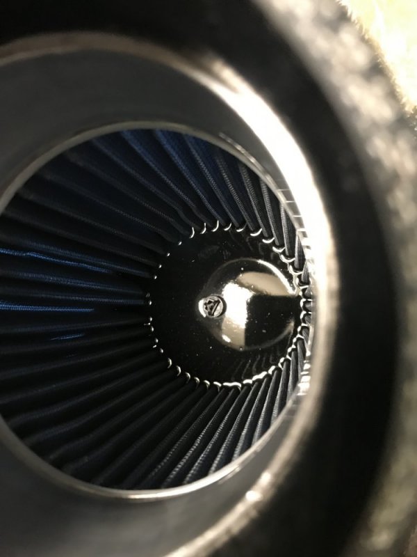

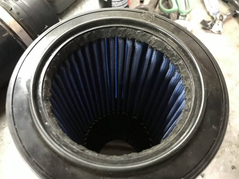

Finished the intake today. Overnight I was thinking about the air filter connection and decided that using a piece of the bead rolled tube to help keep it in place would be a good idea, so I did that first today.
Then I applied a thin layer of The Right Stuff to the inner surface of the filter. This was a can of it I bought a while ago and to my surprise it was gray! So it didn’t blend in with the rest of the filter, but that’s ok....it isn’t a show truck I guess. Then I smeared it on the outside of the aluminum tube before sliding the silicone tube on and clamping it.
Then I moved on to trimming the silicone elbows and the aluminum tube.

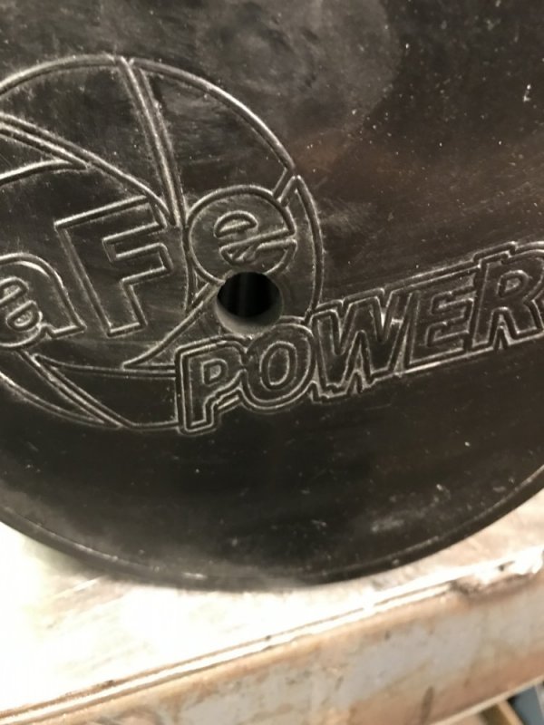

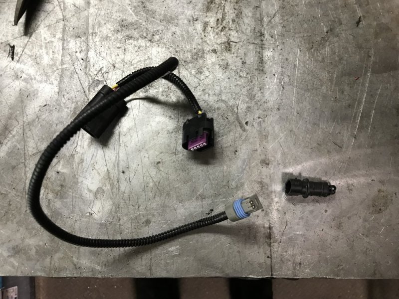

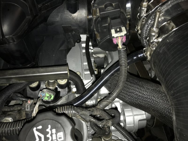

I also drilled a hole in the end of the air filter for the Intake Air Temp sensor. Factory the IAT sensor is part of the MAF sensor, but it can get heat soaked in that location so it’s common to get a separate sensor for reading the temps. I got a breakout harness that was pre-made for the relocation.
0FC6ED00-28CE-43F7-BD97-5083CC51D64D.jpeg31993915-CA81-4E6A-81C1-4EFE313E5604.jpeg5CDBC1E0-28DE-4B42-8560-CC414922B29B.jpeg

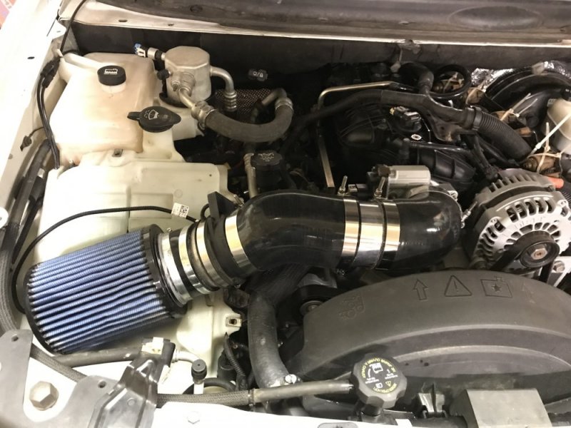

In the end it turned out pretty well.
2F466C9F-5A17-47DB-A002-252A80415912.jpegBEFD5412-2504-404A-90D3-33ABB907198D.jpeg0DFFABFD-D553-4F71-8651-4258751AB661.jpeg

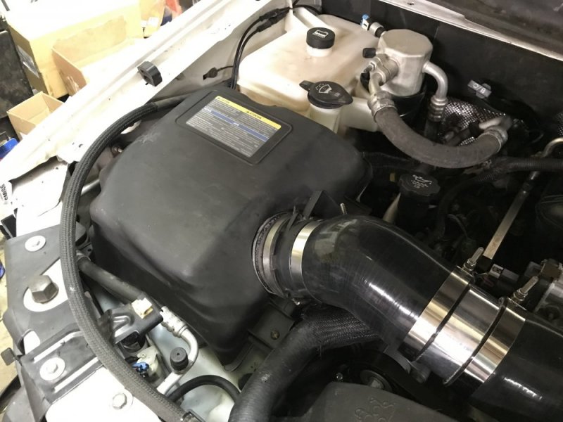

With a little trimming I was able to reinstall the factory cover. At some point I will do some insulation to keep engine heat out and help funnel outside air into the filter. This is just phase 1 though....at some point I will make an extended intake that goes through the washer solvent tank, through the inner fender well and grabs air from behind the bumper for a fresher air charge.

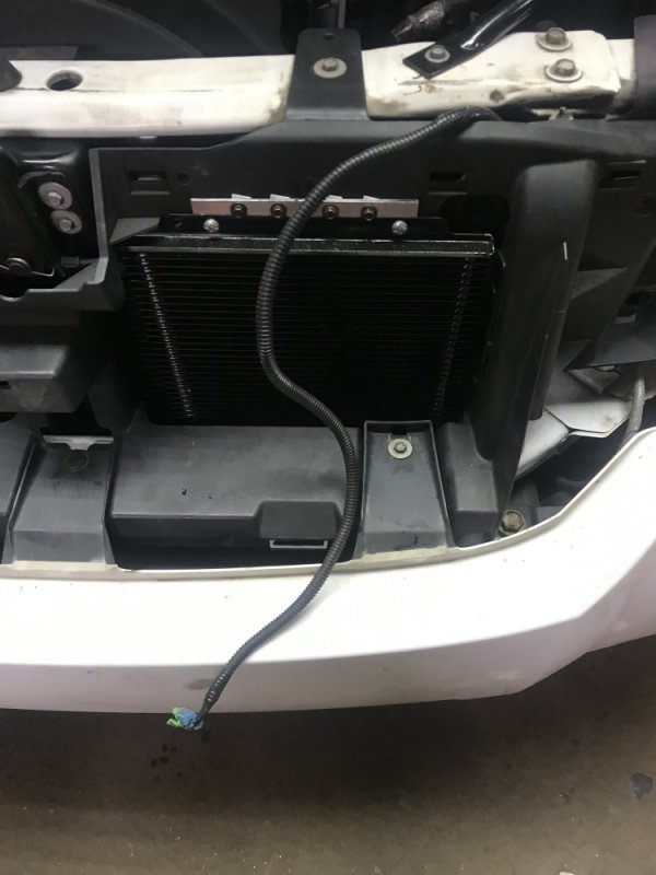

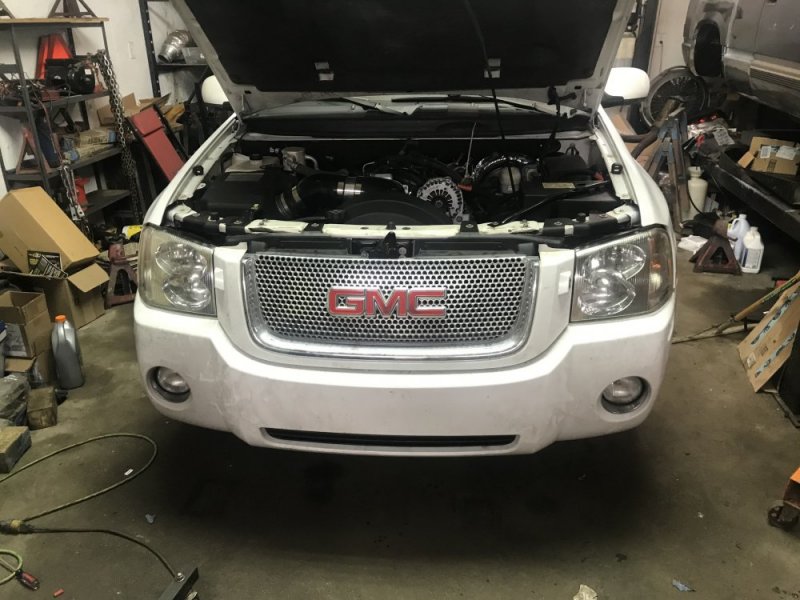

Today was a gratifying day. The Envoy got its face put back on! But first I realized that I had forgotten to extend the ambient temp sensor harness when I relocated it, so I did that after installing the front bumper cover.
Then it got the rest of it’s face....that felt good!!

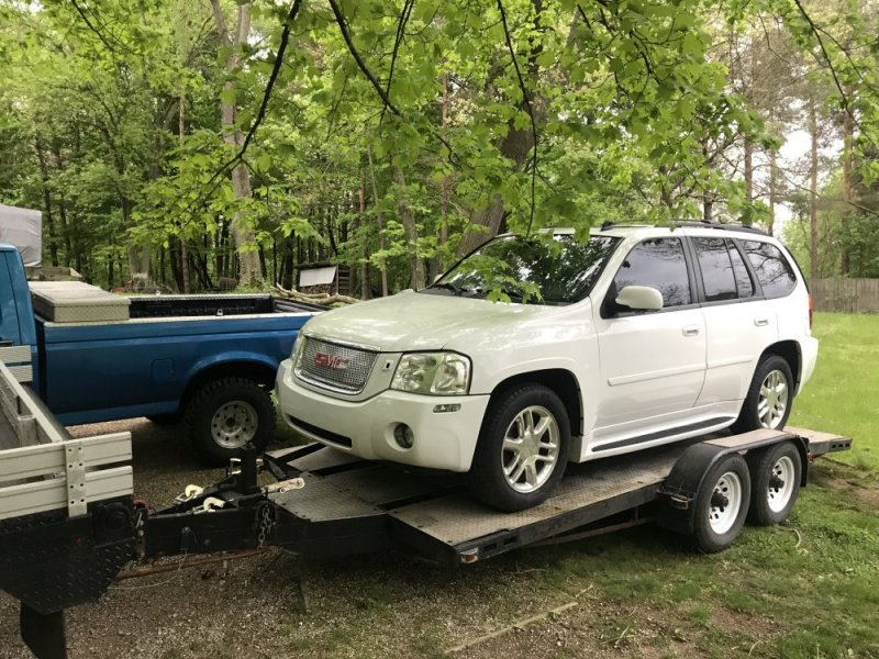

Then loaded it up on the trailer to make the trip to the car wash and then the gas station. Back home and it’s ready to make the trip to the tuner in the morning. I’m so excited to hear it run on more than 4 cylinders!!!

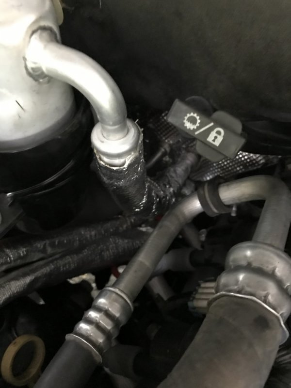

First thing I did was change the AC accumulator. While doing it I also changed all of the seals in the AC system so I hopefully won’t have future leaks. I forgot to slide some DEI sleeve over the hose before installing the accumulator so I had to use what I had for leftovers for the sleeve that wraps and attaches with velcro.....it’s a little short, but at least the spots closest to the header are protected.

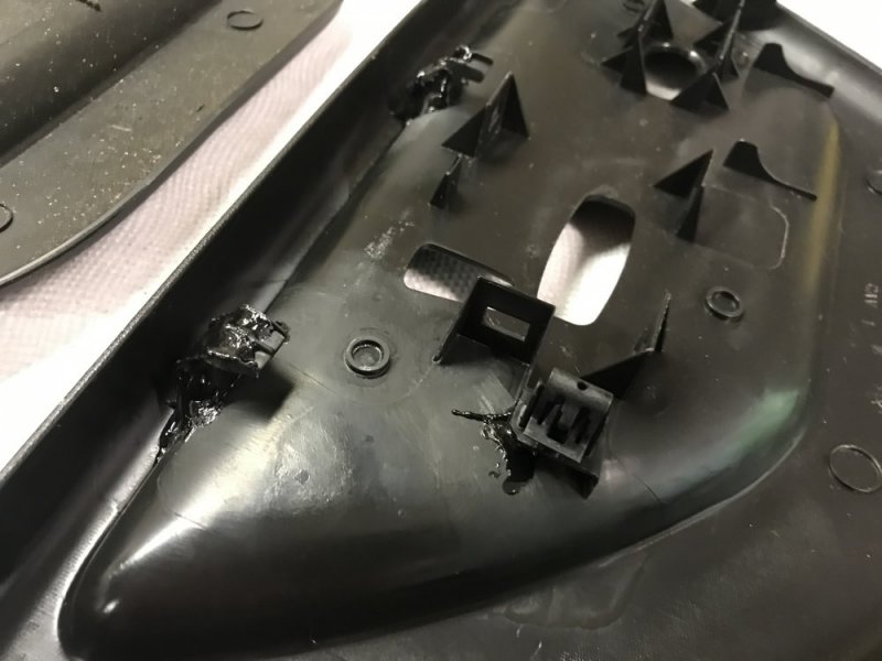

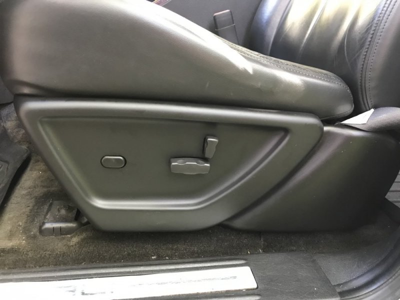

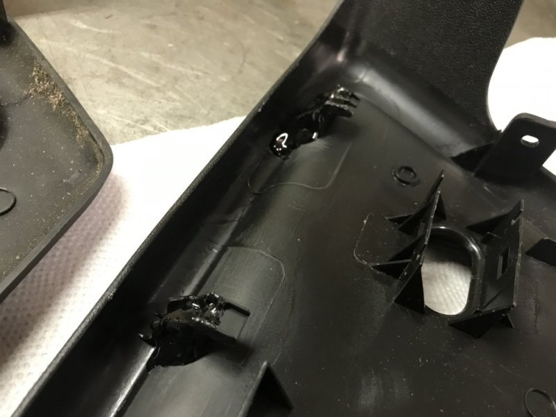

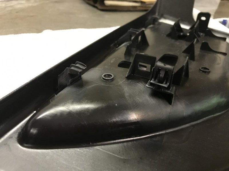

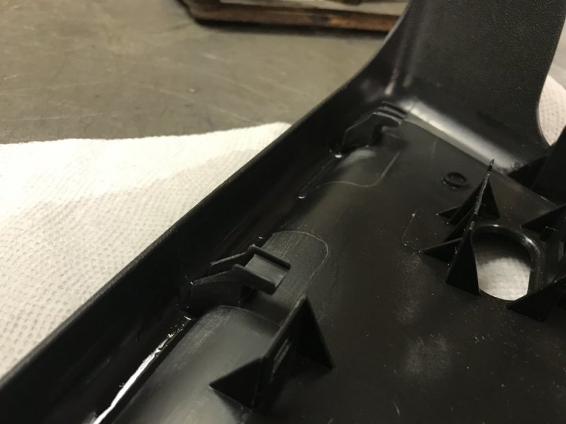

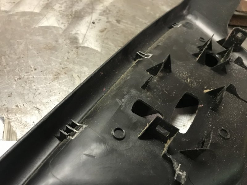

I did a small repair last night. A common problem with the Envoy is that the panel on the side of the driver seat breaks at the mounting tabs and then it’s hanging loose. I bought a new GM replacement panel. I had a little of that plastic epoxy I used to fix the bumper cover left so I decided to use that to reinforce the tabs before I installed it.
First I scuffed and cleaned the panel.
Then I applied the epoxy. I would have liked to use a little more to create even larger gussets, but this is all I had left.
Then I installed it.
I forgot to take the “before” pic so you could see the old one hanging loose. But here’s a pic of where the tabs broke off.
Another thing off the list 😊
