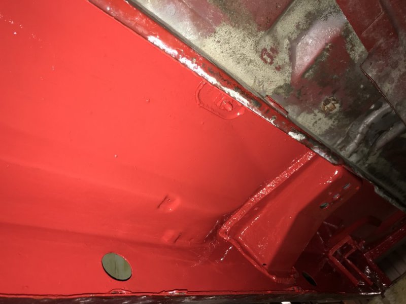

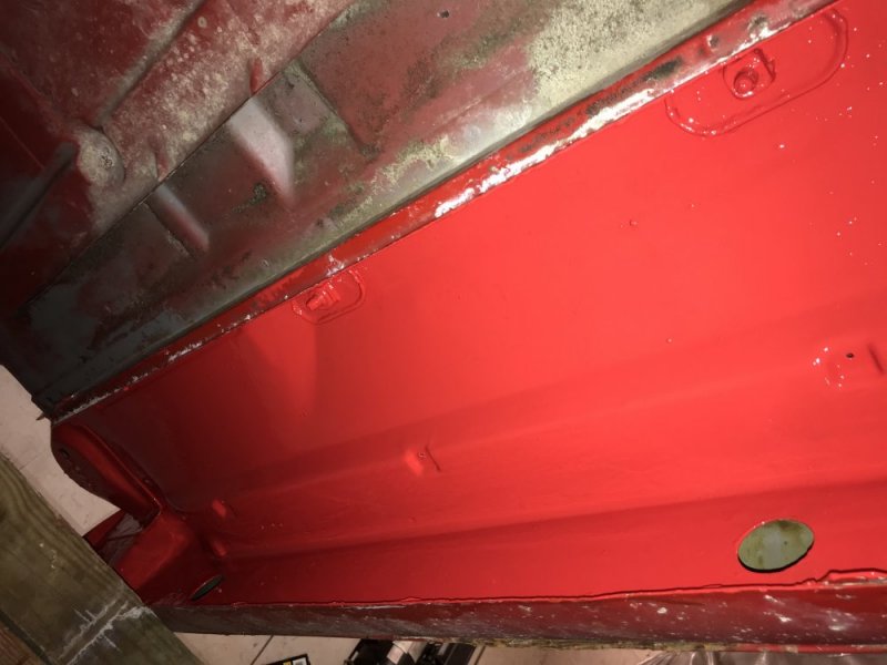

Yesterday I got two coats of Oxide Red Rust Seal and then one coat of Safety Read Top Coater on the underside. There are brush marks because it was pretty humid out, but it’s more than good enough for the underside of the body.

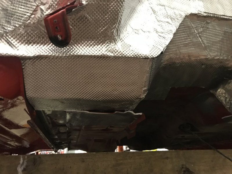

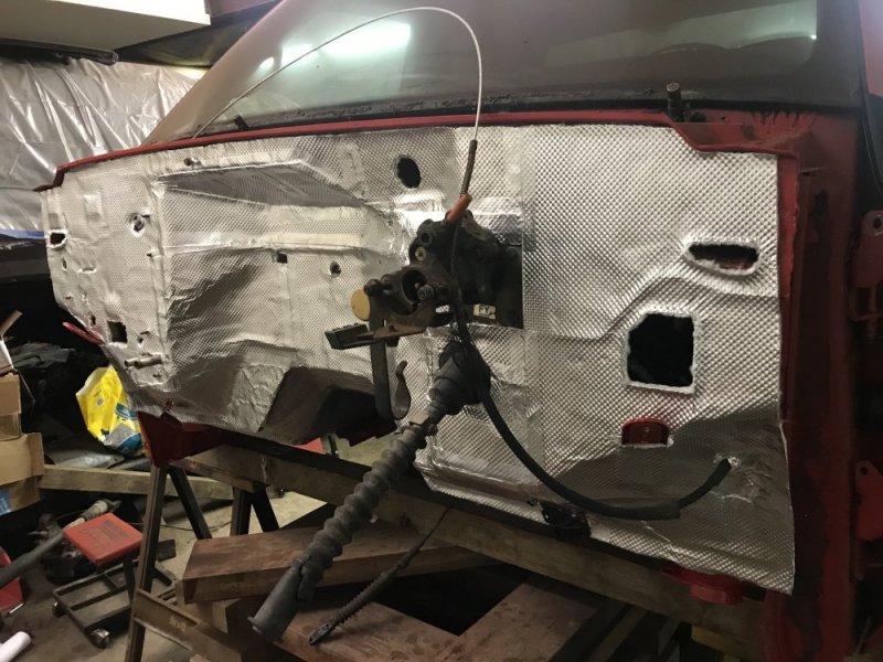

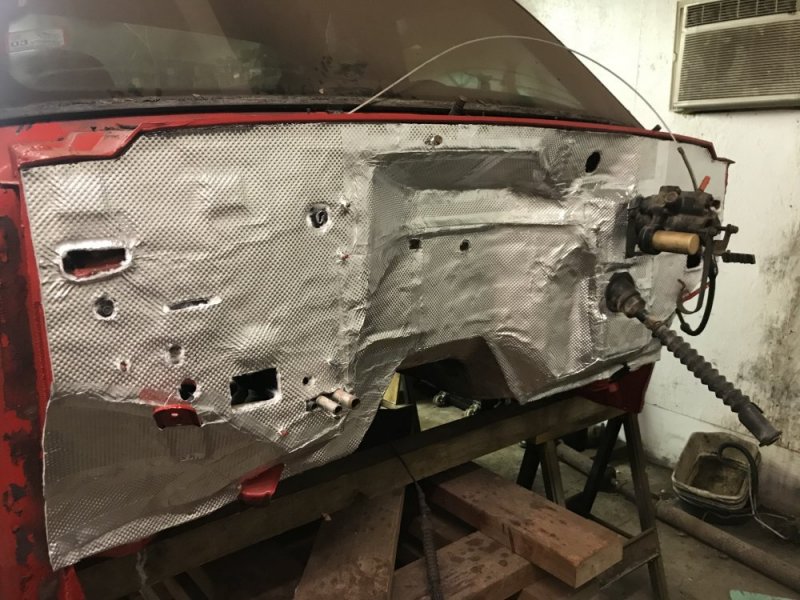

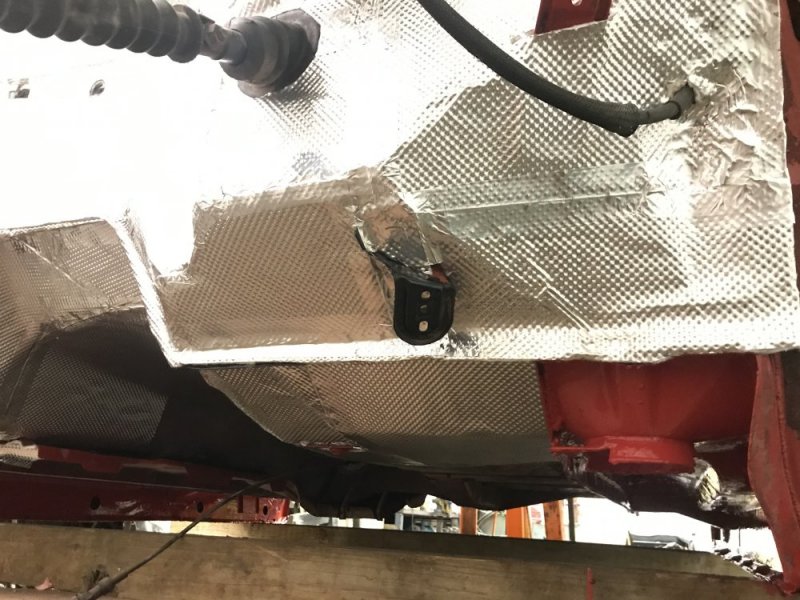

I started putting the Tunnel Shield on the firewall yesterday and finished that up this afternoon. It took longer than I expected, but it turned out pretty well overall.
42CA2CD4-A487-4D3A-81F9-B1C0122ABE2B.jpegBB4C4627-77A1-49CD-90FB-90EA082D45E4.jpeg1279369E-0625-482C-B04A-31F33C2F4DB8.jpeg8F43EDEA-4E71-4C59-B6D7-5A484F83AC95.jpeg

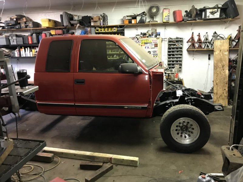

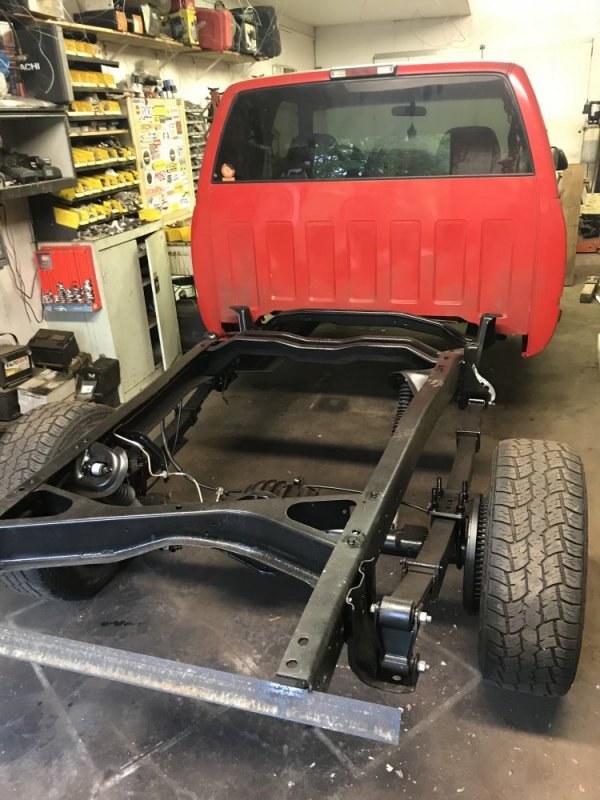

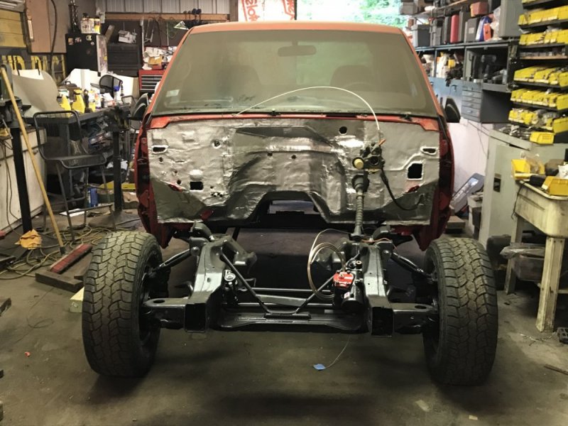

Then once that was done a big step forward happened.
485ABC53-EA5E-4F13-B7DE-5EF4D6B825F0.jpeg57385289-F458-4FC6-8D9E-678903F46951.jpeg34C6D2B7-B3FC-43D1-A960-7DD8279404B9.jpeg
It’s starting to look like a truck again! :cool:
