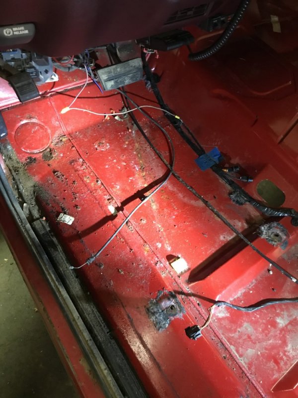

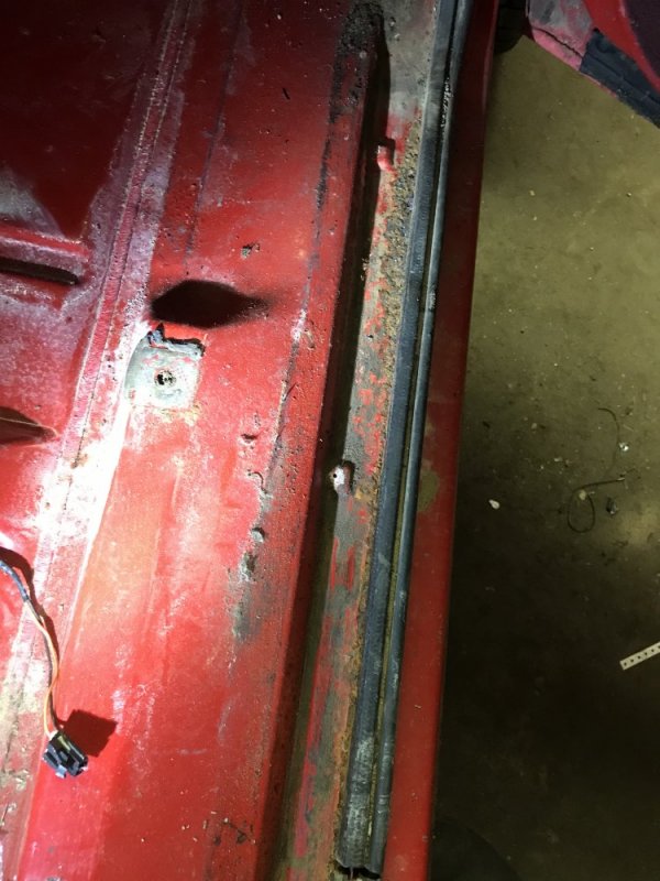

After installing the body mount bolts I shifted to interior removal. I got everything removed except the dash and the door panels. I was pleasantly surprised by how good the floor pan looked under the carpet. There’s some nastiness at the door sills, but it could still be worse. It won’t take much to get this cleaned up.

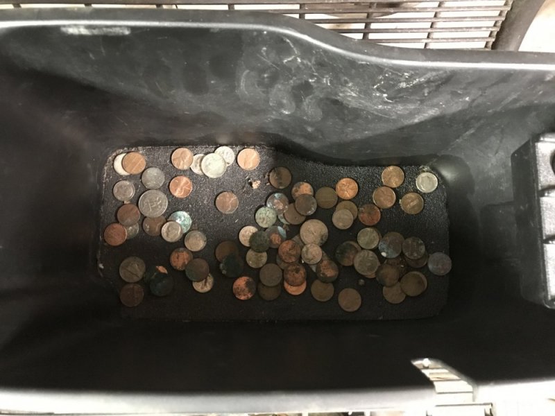

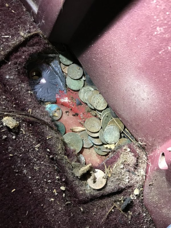

There was a ton of change in the truck with a honey hole by the driver side seat belt.

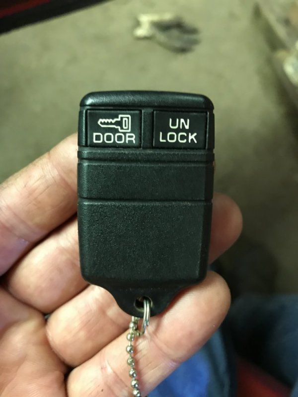

I also found what looks like a mostly unused key fob under the center console so that was a nice find.
I put a rubber floor in my plow truck, I really like it. I'm hoping it keeps the floor drier so it doesn't rust. The weak spot is the threshold. I actually considered doing a spray in bed liner system on it.
I rolled bedliner on the floor of my F350 and liked it for that truck, but I want more noise suppression for this truck. It would be nice to improve the thresholds and make a gutter system for them to drain the cab better.

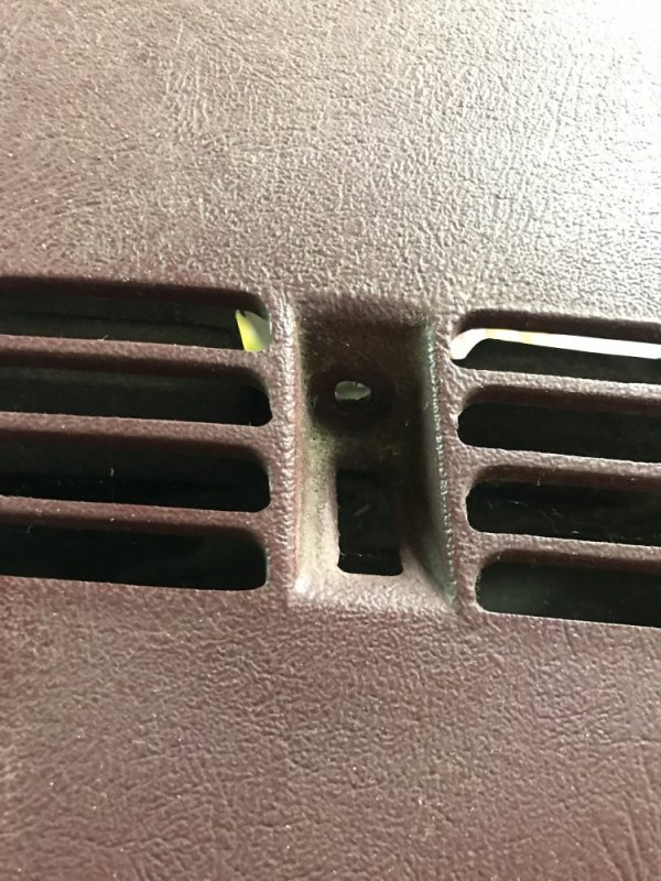

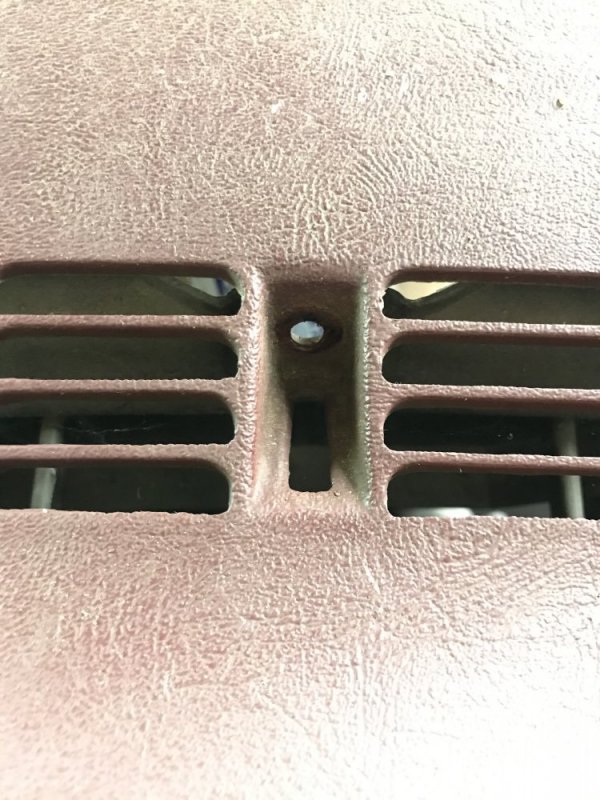

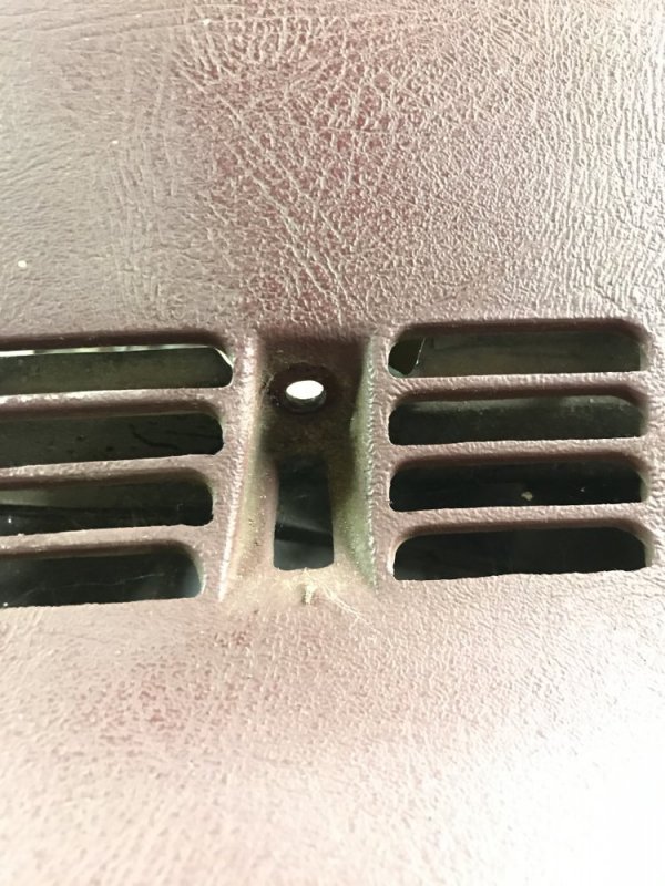

I had a couple hours today so I was able to get the rest of the interior out. No real surprises found. I’m happy to see that the upper dash mounts are still intact - I feel pretty fortunate about that.

Can I get you to take more pictures of the dash assembly? Would have been nice to see more of how it came apart
I bought a GM manual set off eBay a couple weeks ago and it still isn’t here, so I Googled “GMT400 dash removal” and found a good thread with helpful info. The only thing mine didn’t have was the airbags, but otherwise the info was spot on.

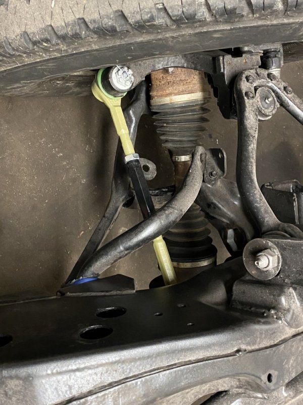

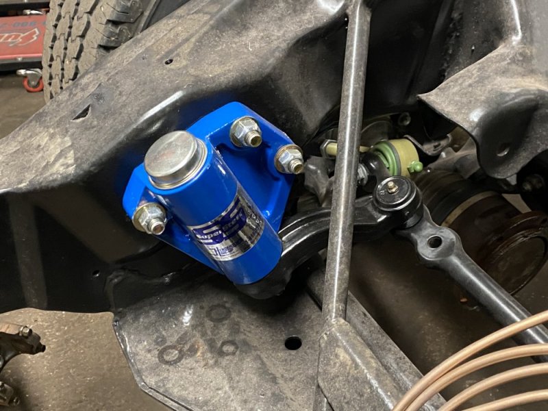

I’ve been picking away at this truck a little in between other projects. Earlier I reinstalled steering bits since I had robbed the Moog parts from this truck to put on the dually. I upgraded this time by installing Mevotech TTX tie rod ends, solid tie rod sleeves (can’t recall brand now) and a Super Steer idler support.

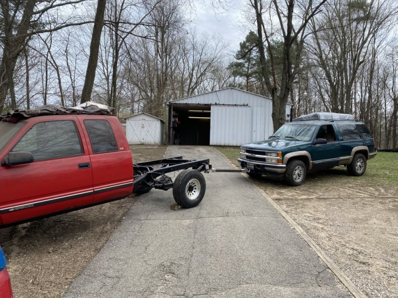

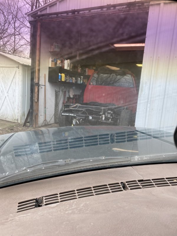

I used the green Tahoe’s front hitch to pull the truck out of the barn and turn it around. So handy.

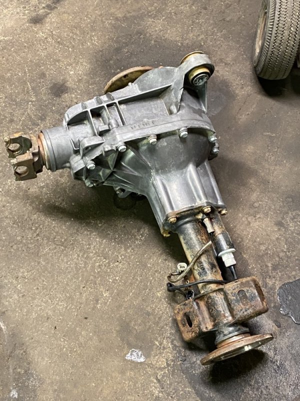

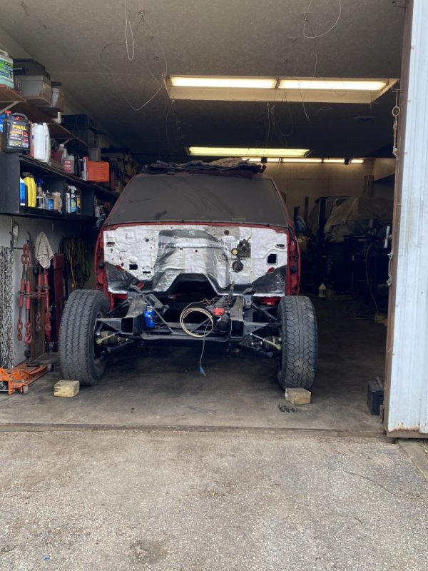

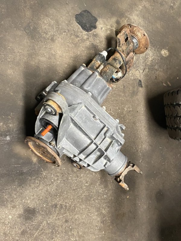

I need to get a mockup engine and trans in the truck so I can start fabbing the turbo hot pipes for it, but first I wanted to get the front diff installed. I spent a couple hours the other day get it cleaned up. I think I’m going to leave the aluminum raw, but paint the steel parts with KBS.

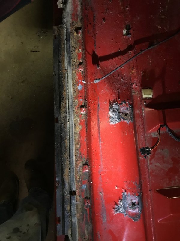

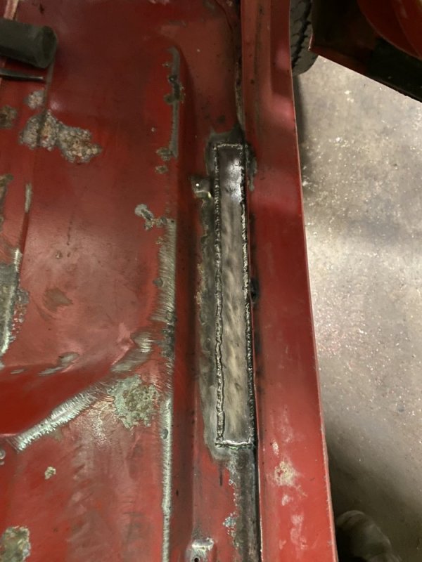

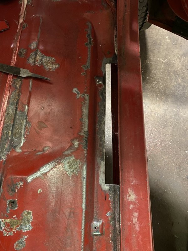

I didn’t want to open a can of KBS just to do those little pieces of the diff so I was trying to think of what else I could paint. I decided I might as well work towards getting the floor ready for paint so I could paint the floor and diff at the same time. I lightly wire wheeled the floor to prep it and found my nemesis - rust. Tonight I cut out and patched the rust. Now I can get back to paint prep.

If the condition of the front diff is unknown, do yourself a favor and replace the front axle seals while it's out of the truck. The driver's side is incredibly frustrating to do in frame. Wish I had done the same when I swapped mine
