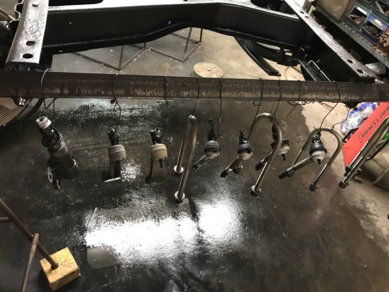

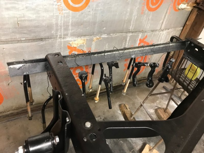

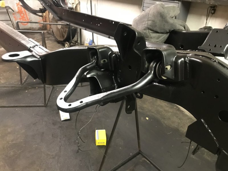

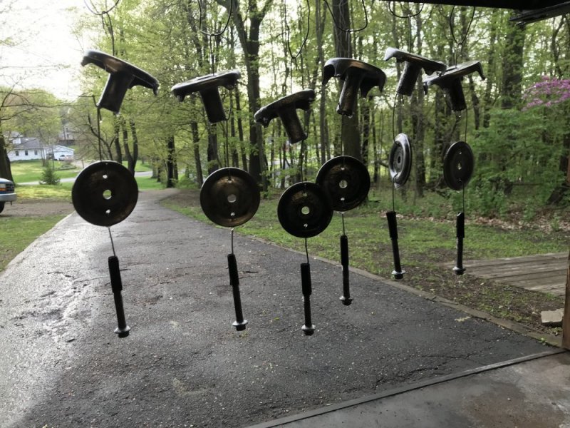

Saturday I painted the steering components and u-bolts with 2 coats of Rust Seal and 1 coat of Blacktop. The paint took a REALLY long time to dry, I think because the air was dry, because of that I didn't get to put the coat of Blacktop on until after 1:00am Sunday morning, so that was a long day.

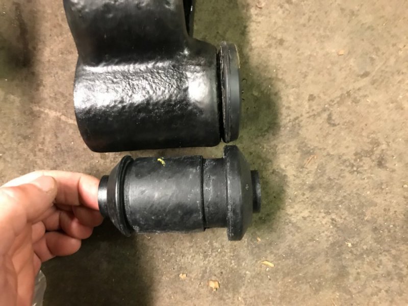

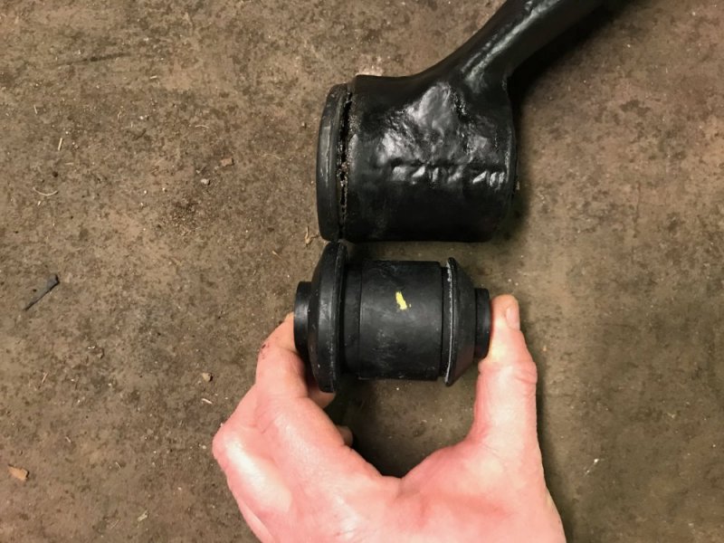

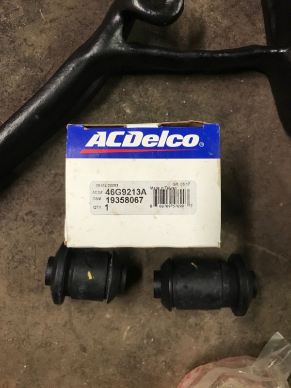

I also started pressing the bushings into the front lower control arms. I bought the front and rear bushings as they were listed in the Rock Auto catalog, but when I opened the box for the front bushing, I found it had both the front and rear bushings in it.....so this is the only part number you need for bushings for the lower FORGED control arms.
Once I got to start putting them in, I wasn't sure they were the right parts anyway due to the shape of them - the end was conical, but the bushings should be pretty flat on the end. I double-checked the part number and it came back to the forged arms in a couple listings so I pressed on (literally, ha). They worked. The pictures below show how much the bushings deform from their free state to the installed state. I screwed upon the first one and installed it dry - I debated between dry and lubed and decided on dry because I knew the factory didn't want them to spin in the arm......bad idea. That one went in really tough and I ended up spraying it with PB Blaster about halfway through, but I'm not sure that helped. For the other 3 bushings I coated them with Energy Suspension polyurethane lube before putting them in......they went in much easier.

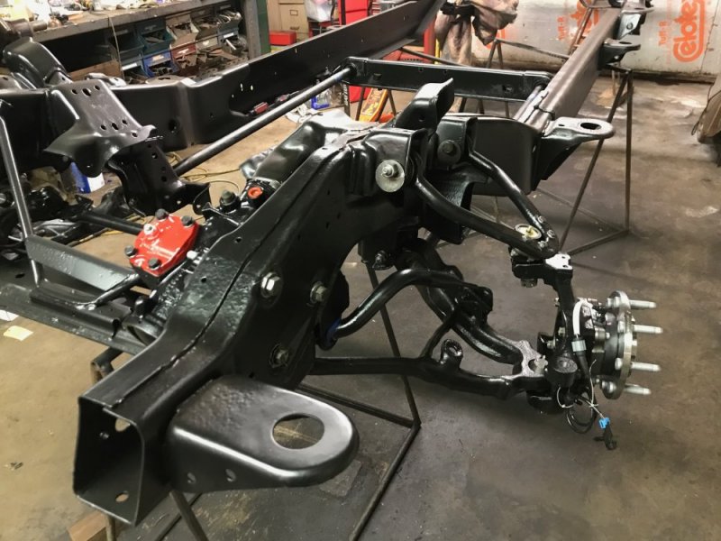

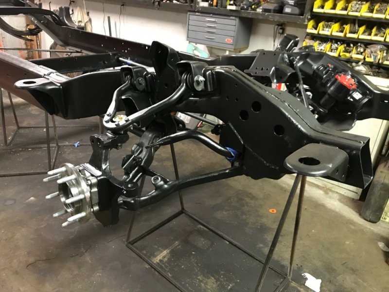

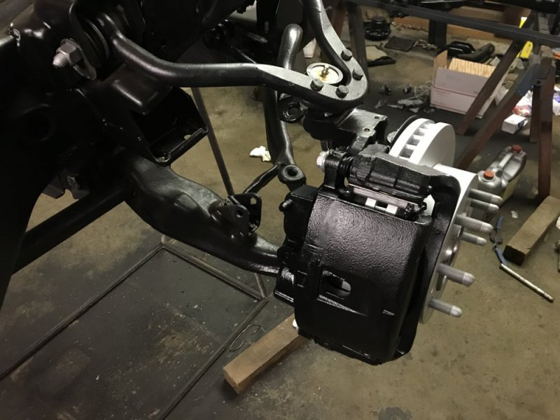

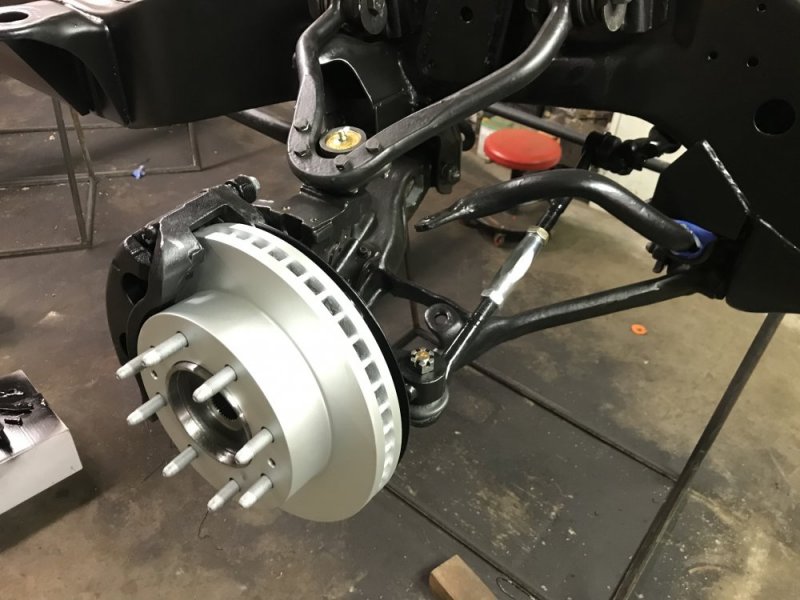

I did some other odds and ends things Saturday without a lot to show for it. Yesterday I got a lot of the front suspension installed. Everything took so much longer than I envisioned - this was mostly due to trying to be careful with freshly painted parts and also the extra time of wire wheeling all of the fasteners before installation. By the end of the day I had all of the front put together except the tie rods and the brakes.

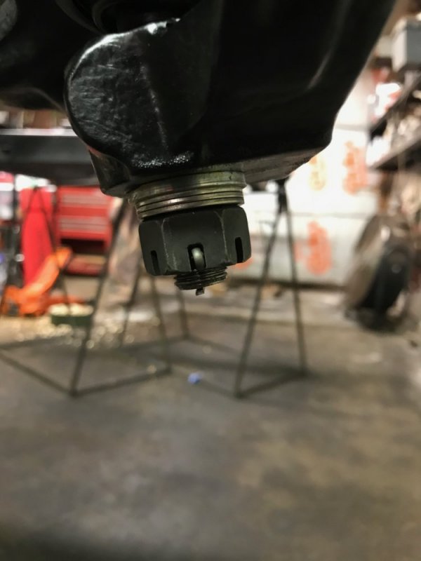

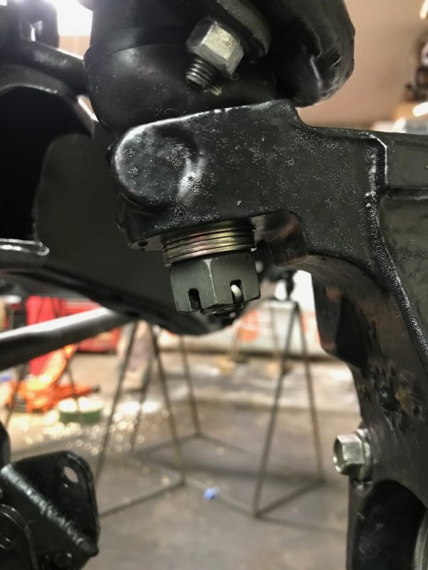

To put a bow on the GMT800 knuckle conversion, this is what my washer situation turned out like. I ordered some mil spec 18-8 stainless washers from McMaster-Carr.
This is how many I used on the upper ball joint to get the castle nut spaced out enough so the cotter pin would engage it properly.
And this is the washer situation on the lower. Note the thick washer - I forgot to grind the end of the taper on the ball joint studs before pressing them into the control arms. It would have been very cumbersome to do that with the arms installed on the truck (and I had no desire to wrestle them back off), so instead I found some good flat washers in my stash and bored them oversize so they would fit over the end of the taper. Then I added the stainless washers as necessary.
