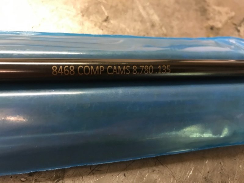

In the same vein of preparing for pushing it in the future, I got some Comp Cams pushrods to complement the valve springs from Chris. I used checking pushrods to check for optimal length at .050 preload. Perfect would have been 8.7625 for the Intake and 8.775 for the Exhaust (stock pushrods are 8.8215", but this is checking using the Harland Sharp roller rockers....). I looked in Summit's catalog and found they had some beefy .135" wall ball-end pushrods in 8.78" length with just a couple day lead-time, so I ordered those. The beefier wall of these pushrods and the better springs from Chris should really improve valvetrain stability/accuracy.

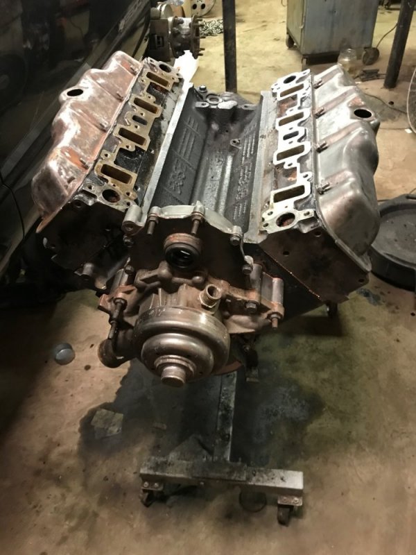

I still had some time after torqueing the rockers down so I worked on cleaning up some covers. I got the valve covers, oil pan and front cover installed. Hopefully in the next few days I can get some more stuff installed and then slap paint on it.

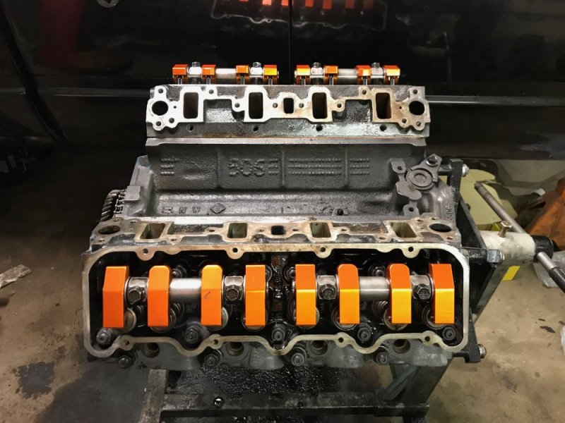

Question, in the pic of the rockers, it looks like 2 different rockers, noted in the shape on the pushrod end... the HS rockers have a different shape on that end between 1.6 & 1.7 ratio... are you going to run split rockers or is that just the pic that makes it look that way ?
I just copied the pic and zoomed in on it, you have 2 different ratio rockers and they are mis matched on valves.. might want to check that unless it's just the pic... You could use different ratios but the rockers need to be on the same valves, IF that is the case you better make sure you have valve clearance and I'd suggest the 1.7's on the exhaust valves...
I ended up with the different shape rockers when some of them got roached from fitting incorrectly. I just assumed they had updated the design when they sent me the replacements. I’ll remove a set and look at them more closely to make sure they’re the same. Thanks for the info.
It will be noticeable in the cup position location... but with talking with HS years ago they have visible differences in the ratios and that is one of them, I have both ratios here from a couple years ago and that is one way to note it...

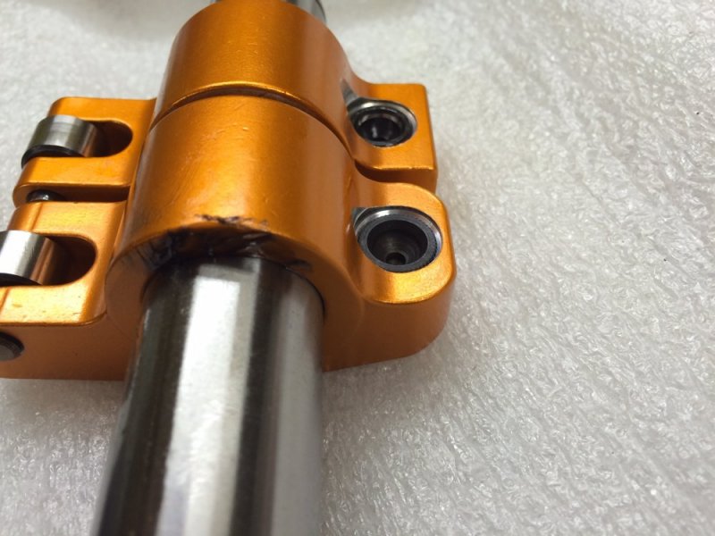

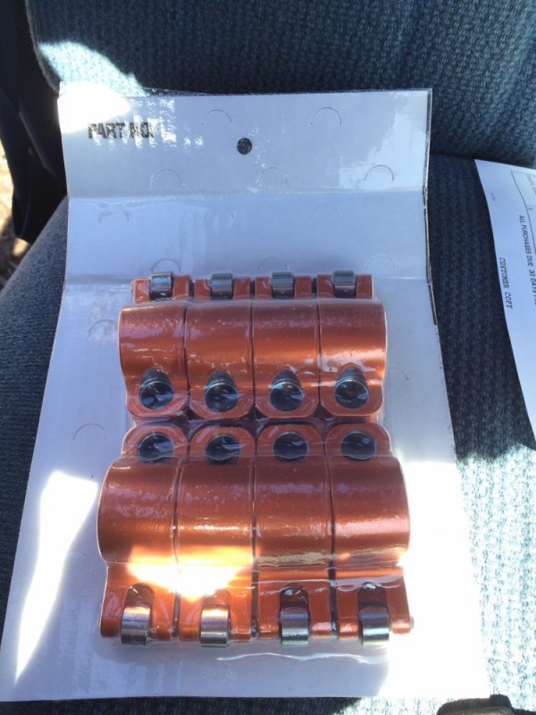

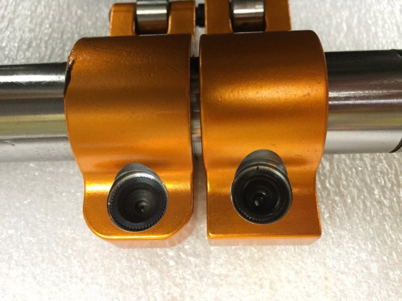

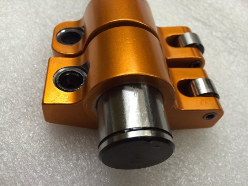

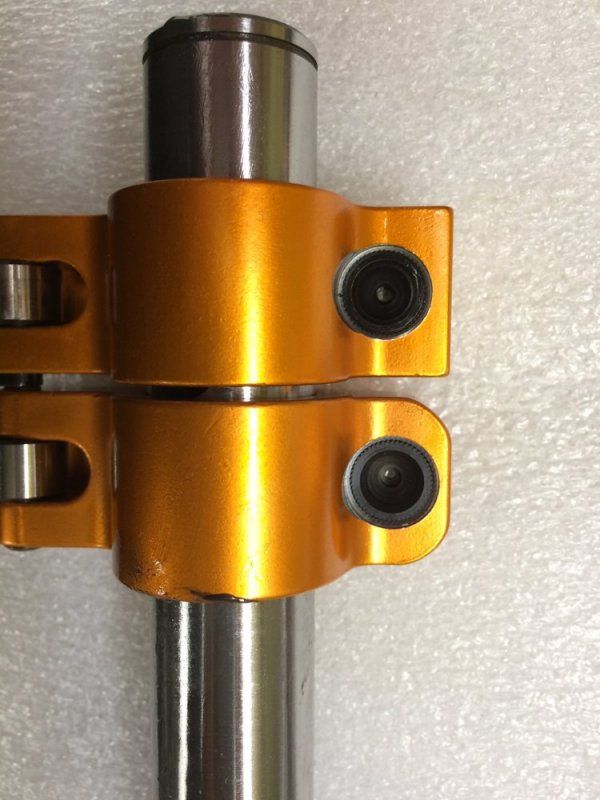

I remembered this morning that I had pictures from when I was working with Randy Becker Jr at Harland Sharp to get my defective rockers taken care of. I found some pictures from the first replacements he sent me. I had forgotten that he accidentally sent me 1.5 rockers instead of the 1.6 rockers the first go around and I noticed the difference. These are the pictures I sent him and you can clearly see the different location of the push rod cups. The original 1.6 ratio rocker has the square corners and the replacement 1.5 ratio rocker is the one with the rounded corners.
Right away he acknowledged that he sent 1.5s instead of 1.6s. Then he sent me the correct 1.6 rockers. This is the only picture I have of them, but you can make out that the cup is closer to the fulcrum. I know I inspected them closer than that at the time, this is just the only picture I have.
So in my case, I had both 1.5 and 1.6 rockers that both had the rounded profile. The square corner rockers are old - I think I was one of the first 5 customers that bought them through Leroy so I'm attributing the difference to that. I still appreciate you raising the red flag and keeping me honest though! I'm just glad I don't have to pop the valve covers back off - that Right Stuff is a PIA every. single. time.
