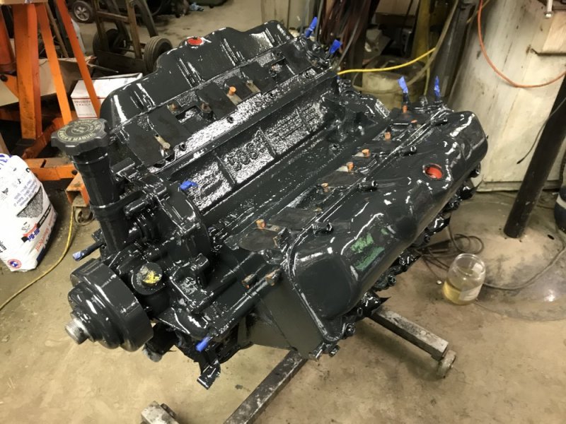

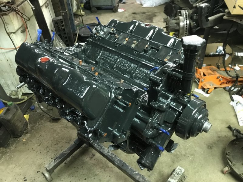

More house stuff this week, so just now getting back to the truck. I got the engine prepped and painted. I used KBS Motor Coater in a color they call Chevy Dark Charcoal. So far I’m liking the color.

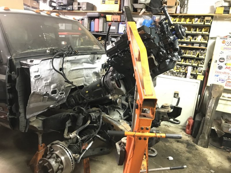

If all goes well tomorrow (which rarely seems to happy anymore), I may have the engine/transmission/transfer case sitting in the frame.

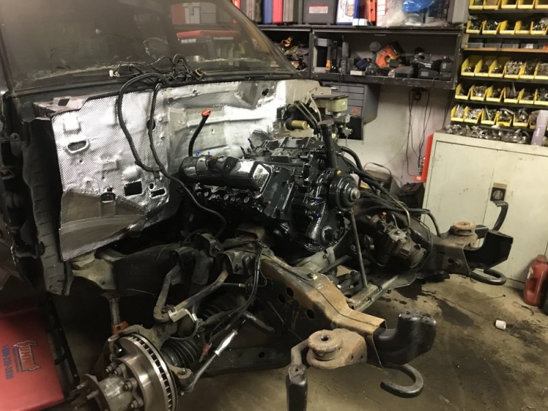

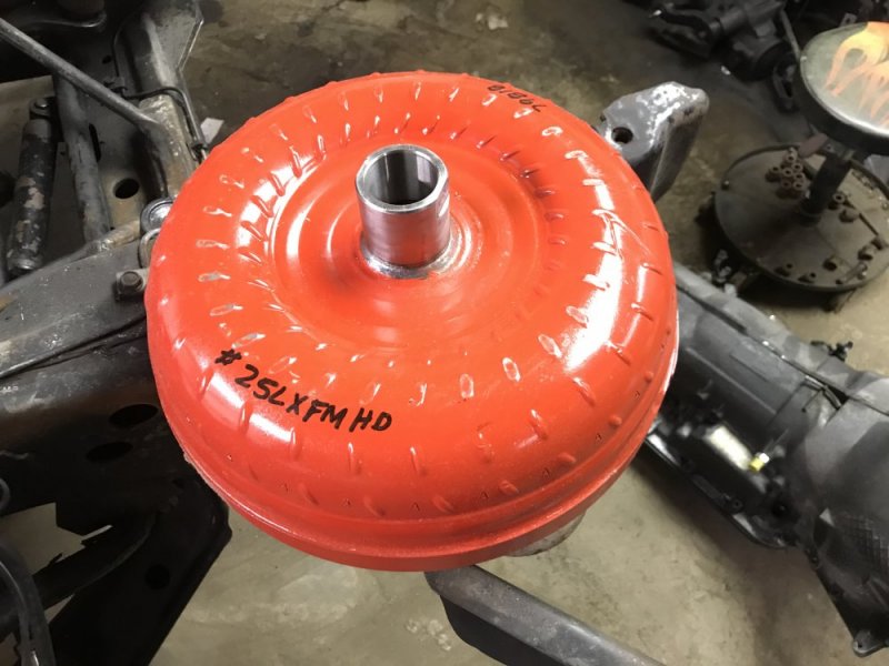

Holy balls, something actually worked out!! I was able to get everything done I hoped to. I put the poly motor mounts from the Tahoe on the frame. After that I swapped the old front axle actuator for the updated design since it was easier to access with the engine out. Then it was time to assemble everything. First thing I did was dig out the Hughes converter I bought a few weeks ago. I’m excited to see how much it improves with a quality converter in it
With that installed I bolted the trans to the engine and the transfer case to the trans. Just a few odds and ends and it was ready to install. The gap between the torque converter and flexplate was at the high end of the spec (supposed to be between 1/8“ - 3/16”) so I installed some .045 stainless washers. Then up it went.
Obligatory ‘it’s going in shot’:
And here it is finally sitting on its mounts.
Now I can finally move on to the next stuff.

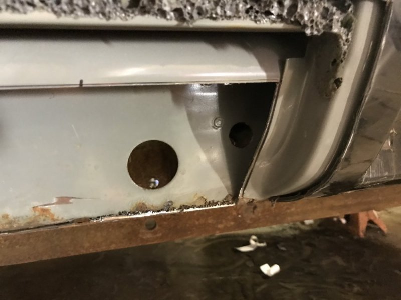

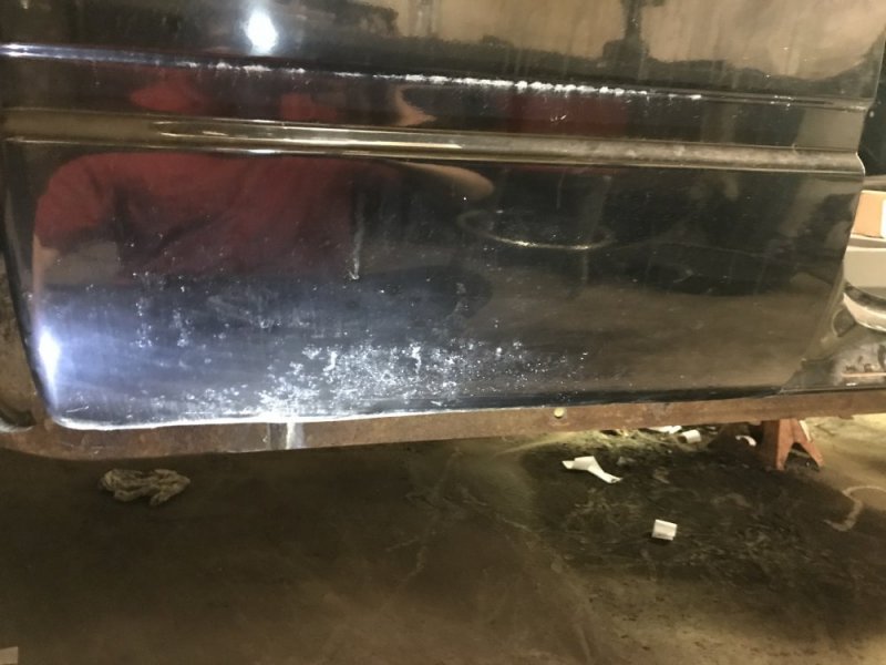

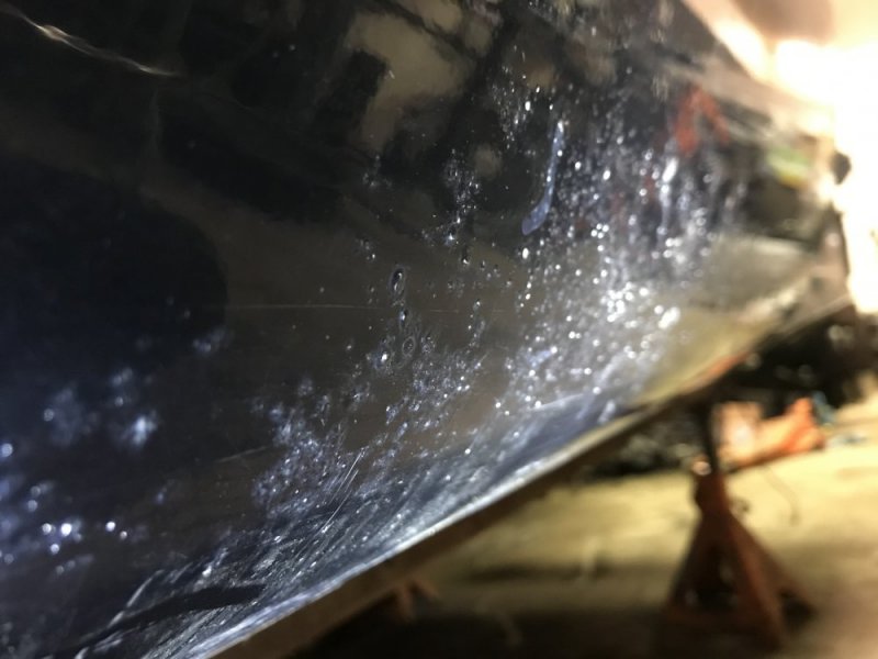

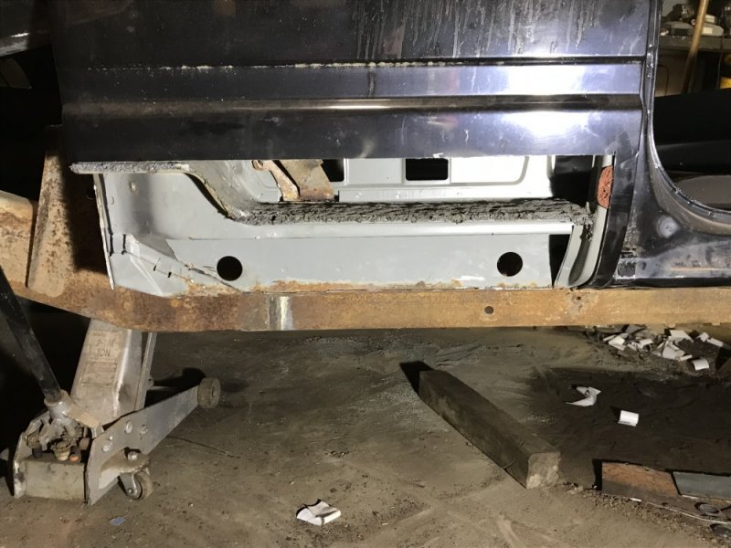

Next up: some rust repair. Overall this truck appeared pretty solid when I looked at it....I mean for a Michigan truck. The frame is a ton cleaner than Krovvy’s and should be much easier to restore later. When I looked at it I noticed the rusty floor; unfortunately that ended up being more extensive than originally thought. The other place that had rust was the passenger side of the extended cab even though the driver side was super solid (the hole in the floor must have allowed the wet feet to drain before it got to the extended cab). The pass side meanwhile felt like it was just paint holding it together. It’s hard to make out in the pics, but there’s some nastiness bubbling just below the surface.

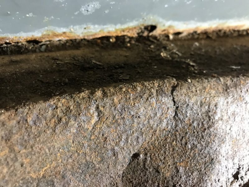

I was going to wait to fix this during the later restoration, but I figured since I had the whole interior out now this was the perfect time to make grinding and welding smoke in there. Plus once I’m done here all of the internal/structural work will be done on the cab so all I have to do in the future is degreasing the underside of the floor and any exterior bodyworkpainting I decide to do. So out came the grinder tonight. Lots of rust sheets down in there that have sloughed off the inside of the panel

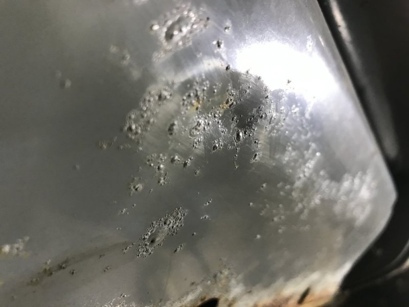

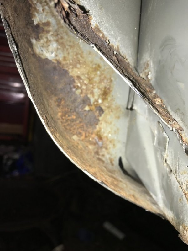

If you look close you can see how the panel cracked due to how thin it is....it’s like foil.
I got a big chunk removed so I could get a lot of the rust, but not go too far.....yet.

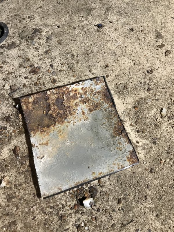

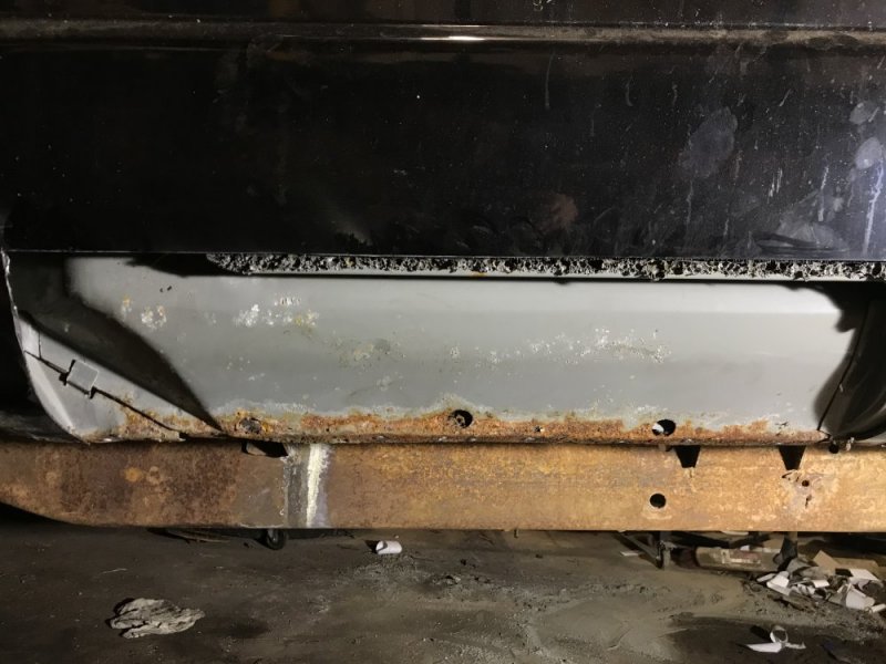

Then it was time to address the next layer. It was a lot like the outer skin - it LOOKED ok, but a quick inspection would show how thin it was.
I put a dent in it with light pressure from my finger 😳

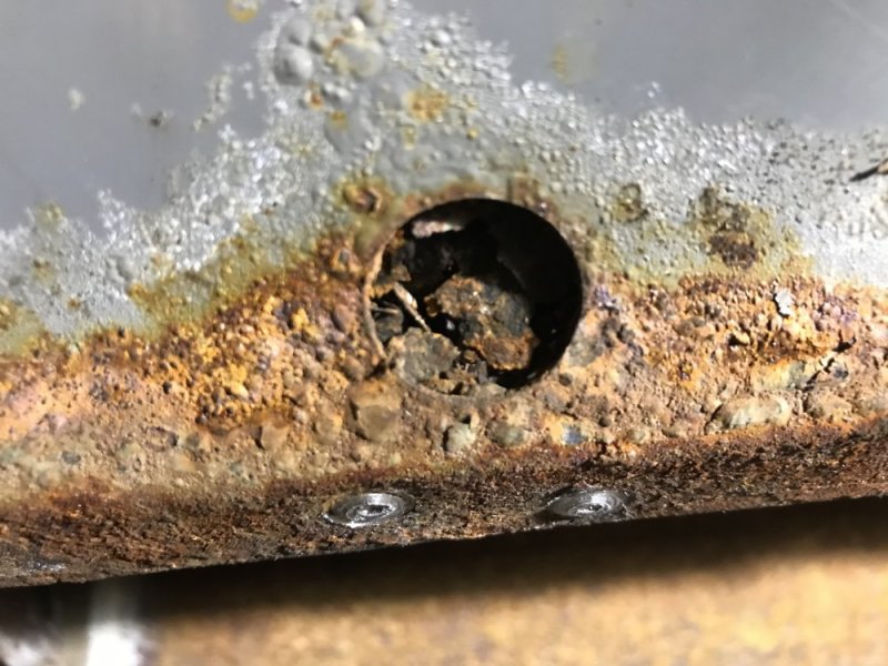

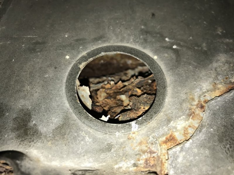

I could see a lot of loose rust in the drain and inspection holes

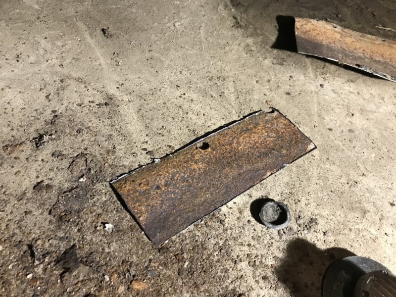

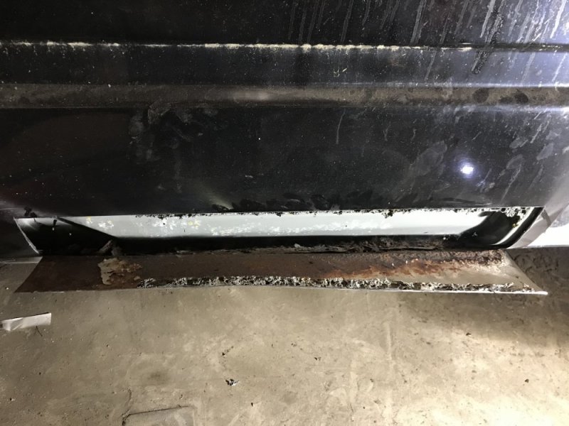

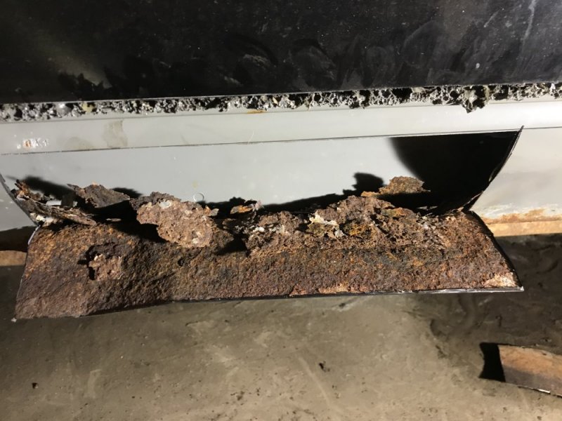

So out came that panel.
C0FB2D89-2B86-4513-861E-5D81D4BA2568.jpeg8C7F5277-B32E-4407-A20A-7E5A457B8F6A.jpeg3E8E14F4-10AC-4719-A9BA-F6DC165E60AA.jpeg

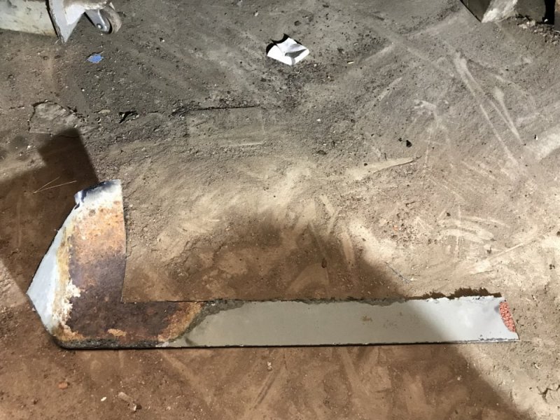

Luckily the inside of the inner rocker is still solid so I have a good foundation to work with. I decided to take a little more of the inner panel so I could be sure to get as much rust as possible. The back side of that chunk was getting cleaner so I’m reaching the end of it.
I think I’ve gotten most of what I want to remove cut out, but I still need to evaluate the cab corner more. I was hoping to save it, but I’m not sure if I can. If I get into the cab corner I’m probably going to have to slide the bed back so I can have good access for cutting and welding. Oh well, at this point it is what it is. #PureMichigan

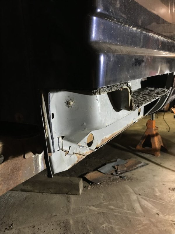

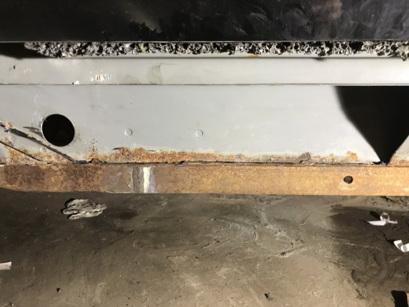

I didn’t like what I was seeing and feeling in the corner so I unbolted the bed and tilted it up. NO, the bed didn’t come OFF, just temporarily tilted. After that I scribed my lines and made more cuts. I need to figure out how I want to do the ends of the patch, but now I’m getting closer to having all the material removed that I need to. Hmmm, funny how all the rust is below that foam......thanks GM.
