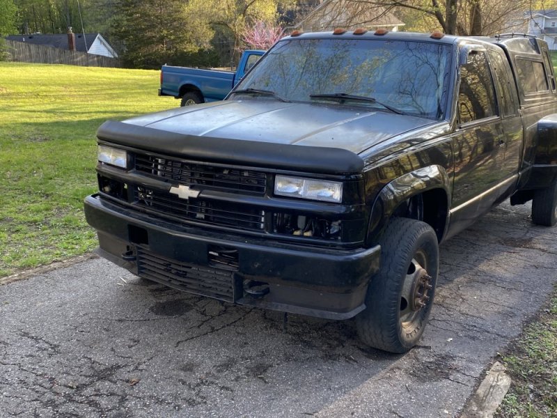

Fiddled around with the truck a little during my lunch. I realized that with the hood on and the inner fenders removed I had an excellent opportunity to check hood clearance for the intercooler. Looks good. I don’t know how I got anything done before cell phones.....it’s so handy having a camera on me basically all the time.
I know its functional, but that cap makes my eyes hurt. :dead:
Is that the front bumper off the Hoe?
Are you going to put some insulation in the bottom side of the hood? Looks like you have plenty of clearance for it.
What cap are you talking about?
Yep, the one from the Hoe. Since both trucks are black and I intended to run the WTA intercooler, I figured I may as well use it now. I’ll decide what to do to the Hoe when the time comes. Maybe ATA, maybe another WTA of another sort....don’t know yet.
Yeah, now that I see how much clearance I have, I’m thinking about adding some insulation under there.

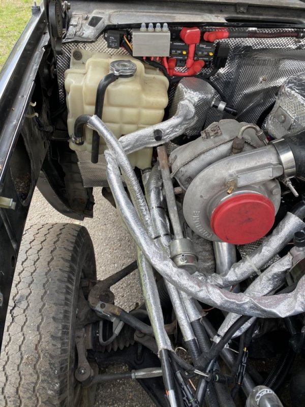

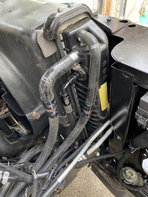

During lunch and after work I rerouted the 5/8” heater hose and the hose to the overflow container to make more room for the intake. I used more of those Gates heat shrink hose clamps to keep the installation clean. I also took the heater hose filter off and cleaned it out.

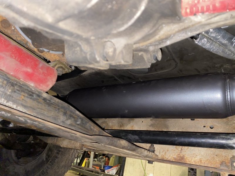

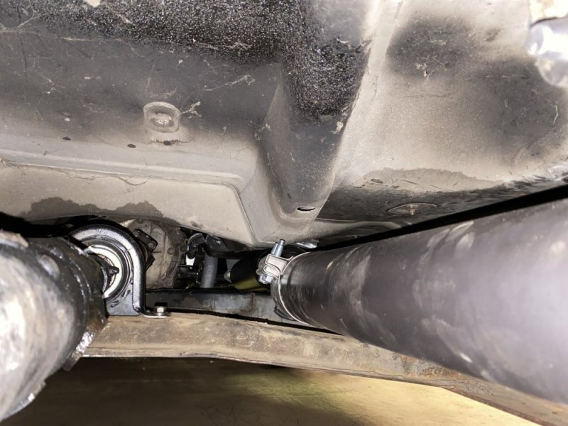

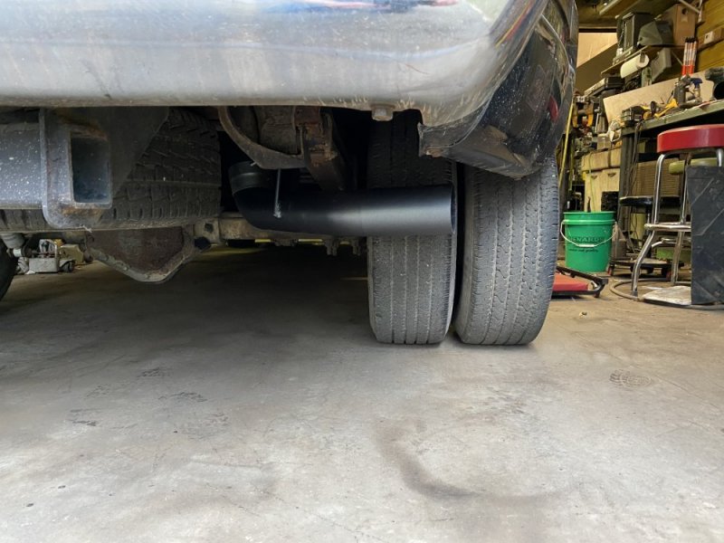

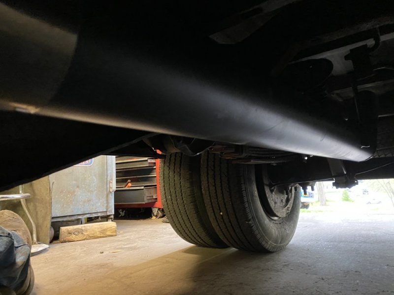

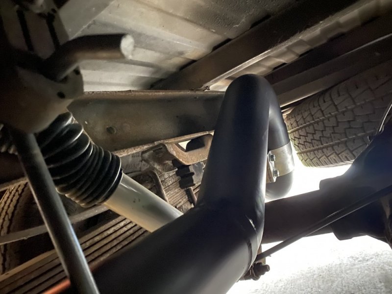

Once I got it pulled in the barn I got to the task of installing the exhaust. All done.

The bed cap.
Topper?
I don't know what they are called in Michigan.:D
Oh THAT cap. I thought you were talking about something under the hood. I don’t know why, but I kinda like it for some reason. I think it’s how the truck gets taller and wider as you get further back. I’ll take it off and see how I like it, but for now it will stay on for a while. Your eyes be damned!! 😵

That appears to be the Diamond Eye exhaust? Looks about the same as mine. I noticed that the outlet seems to be a bit short of clearing the bed side. Since I got to drive my truck with the bed on it the other day I noticed how much more I could hear the exhaust. Almost a little too much. I am considering extending the tip another 6 inches to get the noise out from under the bed.
I would assume you haven't drove it down the road yet to notice the exhaust tone. I can tell you that she growls quiet a bit in the cabin under load. I was good with how quiet my exhaust was until I had the bed on. :woot:
I will say that you are a humble man, my friend. To include the fact that you forgot something to prevent your truck from starting. Not one person here reading has not made such a simple goof. There is nothing Dumb about any of it. It happens. Your skills around your truck have far impressed many of us here.
It’s the Diamond Eye from the Hoe, modified to fit this truck. It also has the 4” x 30” FTE resonator/muffler on it just after the downpipe. The R/M really kept the drone down on the Hoe. Good info about the length of the tip and the sound inside. I was thinking I may add a tip to it. I guess I’ll see how it sounds. Maybe that cap will keep the noise out of the cab more and I’ll be swell!! 🤣
View attachment 64822View attachment 64828
View attachment 64823View attachment 64824View attachment 64825View attachment 64826View attachment 64827

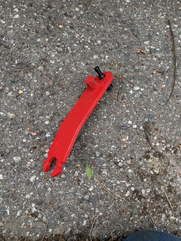

I got a neat tool yesterday and tried it out......

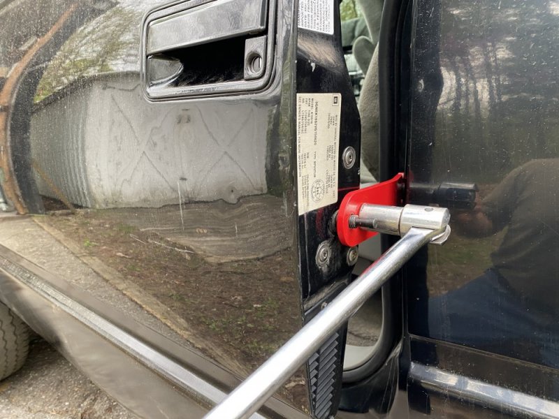

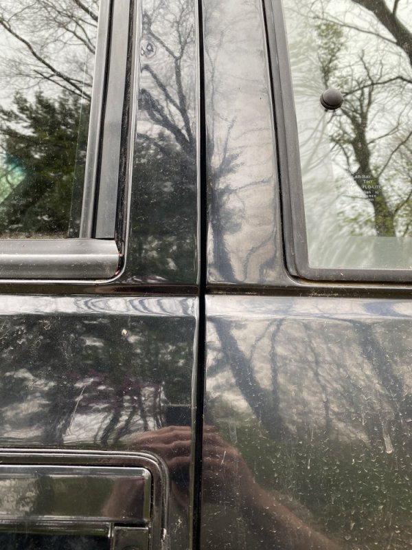

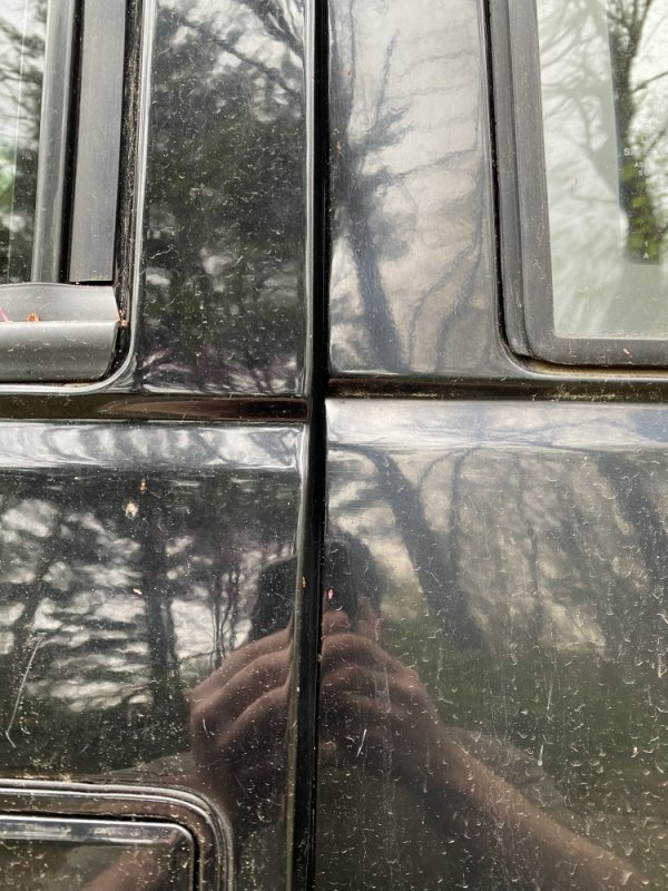

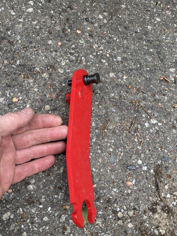

Once the truck was out of the barn and I got in and out of the driver’s door a few times, it became very apparent that the door was out of alignment. I didn’t really want to do the 2x4 trick with the fresh sheet metal so I went looking for an alignment tool. This one was a good price and had good reviews so I bought it.
Steck Manufacturing 21845 E-Z Store Door Alignment Bar https://www.amazon.com/dp/B000JFL8S...abc_0BFSVXPPG9S5WE3WAAM8?_encoding=UTF8&psc=1
It worked great! FYI, the before and after pics of the door were taken with the door unlatched.

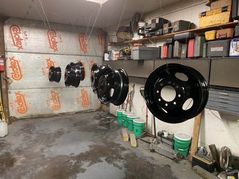

Then I spent the rest of the night prepping the wheels for paint.
View attachment 64832View attachment 64833View attachment 64834View attachment 64836View attachment 64835
I have the one with the handle attached....
Oh, I didn't see a version with a handle attached, but I do like the compactness of this one, it's easy to put in a toolbox drawer.
You need a BIG A__ SNAP ON box for it to fit so I just hang it off the shelving...
The doors sag from putting weight on them when getting in/out of vehicle...I did install a pull handle on the roof of d/s on Burb it helps getting in/out w/o leaning on the door.

I also got the wheels painted tonight. I just painted them with Rustoleum, because I just needed some paint on them. It will also be a good experiment to see how well it holds up. Eventually I’d like to blast them and get them powdercoated at work like I did with the Ford, but with Covid and cost saving measures in place, I didn’t figure now was the right time to ask.
I always thought sagging doors was caused by worn out hinge bushings? I know mine have a little wear in them and I was planning to replace them.
I used Rustoleum on an open car trailer and its still holding up fairly well. Its far from perfect, but it still looks ok. I think it was 15 years ago. Is that a spare set of wheels you have on hand? GMT400 Warehouse, Kalamazoo branch.
Both bushings and weight of folks hanging on them
