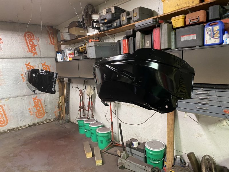

I also painted the inner fenders. This is just a quick degrease and spray bomb job - I just didn’t want crusty inner fenders detracting from the rest of the engine compartment.

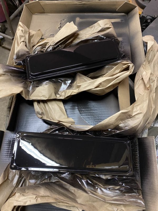

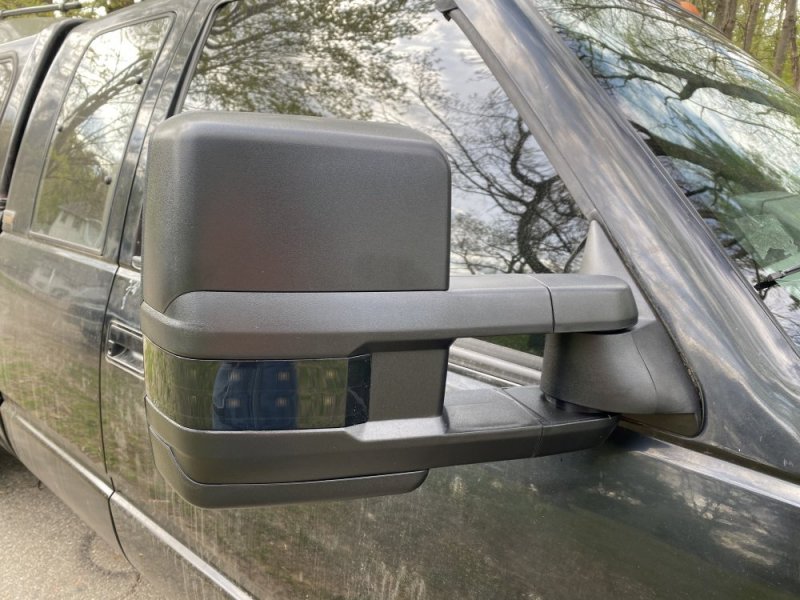

I also tinted the turn signals with some tint spray.

I'd like to see how well the running lights and turn signal show through that tint. Is that the Night Shades stuff? Never seen it quite that dark.

It’s Rustoleum brand. I’m not sure how it will look once installed. That was probably darker than I wanted it, but I couldn’t get an even coating when it was lighter. Hopefully I didn’t ruin them. I suppose I can sand some off and then clear coat them.

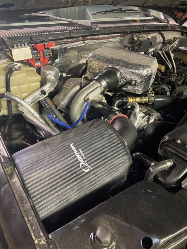

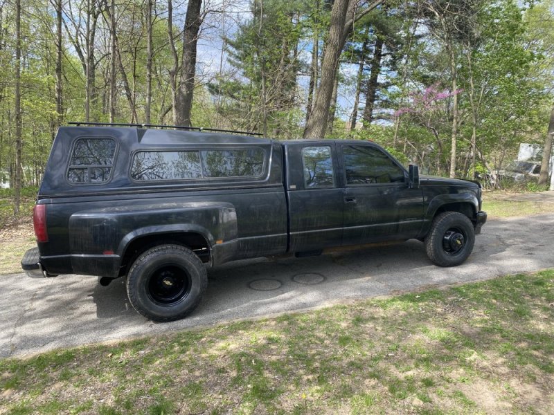

It was a successful weekend. Yesterday I mounted and balanced the tires. Today I did the rest of the things I needed to do so it could be driven to the shop for the alignment. After getting the inner fenders installed I finally installed the air cleaner and intake tube so I no longer need to put the stupid red cap on anymore (I tried starting it with it on again yesterday!). That’s an AFE filter under the Outerwears pre-filter.

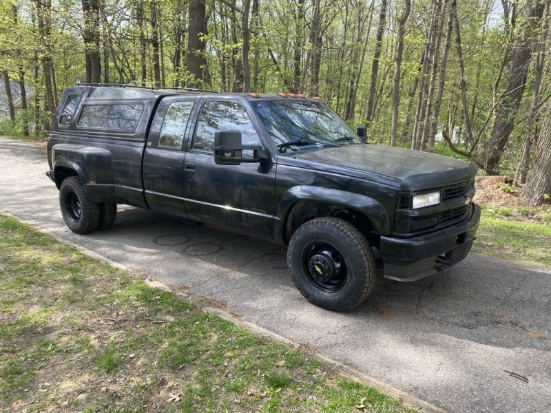

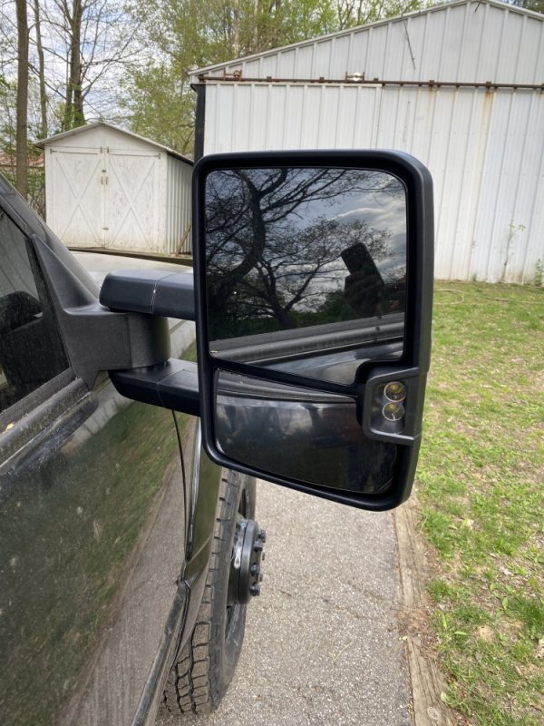

I installed these sweet tow mirrors from Boost Auto Parts. I don’t have them wired yet, I just needed to get them installed so I could drive. They have tinted turn signals on the front and built-in, rear-facing spot lights. I’m going to wire the spot lights to the cargo lamp switch because I think they’d be a bit too intense to come on any time it was put in reverse.

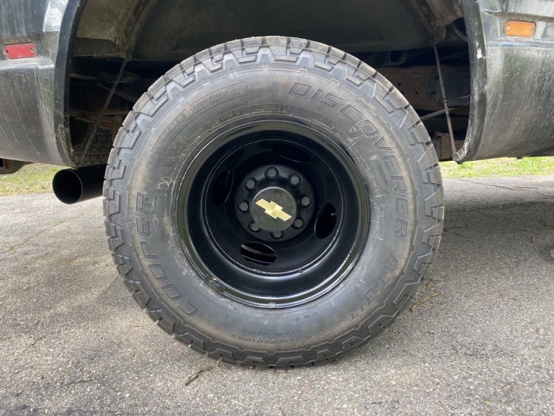

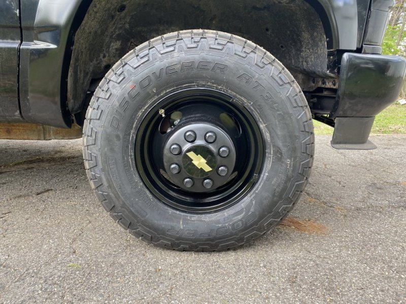

Then I greased the front end and installed the wheels. I got some center caps off eBay that I really like. It needs a bath really bad, but I think it looks pretty tough regardless (and yes, I like it even with the cap 😁).
DAE4AC46-4FBF-40A4-8E34-28950179D38F.jpeg0466540B-4070-42E8-A22D-63AB4CDECEE3.jpegEB6552B7-22FC-4D79-ACED-9B6F3D54C7C3.jpegE13C2C3E-CE3B-42B1-B99D-C2164DE09A57.jpeg1B293A70-45B0-4E5A-B967-3E9061303B1B.jpeg
I need to do some tinkering on it still before it’s a “driver”, but at least now it’s drivable. The dash indicators came in handy because when I started it up after fueling up I saw the radiator fan came on with the coolant temp only reading 170 in the passenger head (though I would have heard it without the light). And the trans fan also came on by the end of the drive to the shop. My EGTs are also running high so I need to look into that. Our first camping trip is booked for June 28, so I have a little time still to get the rest sorted out before towing.

She would be shining like a diamond with some soap and water. Looks great otherwise!
Those tires make 16" wheels look tiny. I have the same tires on my Jeep. They get a little noisy as they wear.
That cap...:stop:
:D
Yep, definitely needs some cleaning. I don't know if it will be shining like a diamond, as the paint has some issues overall, but I think it will be acceptable for the time being.
These are the same tires I had on my Ford (same size, too). I didn't remember them making noise on the Ford, but I did notice the other day while driving that they were making a little road noise. The Ford was probably just too noisy overall for me to hear the tires. I think this truck is going to prove to be a suitable replacement for the Ford - more comfort, more power, looks just as tough and has a cap to keep things sheltered in the bed 😁
I haven't done anything else to the truck this week as I've been busy on something else, but I'm pretty sure I've figured out the high EGT issue I had on the first drive. It was mid-80s when I drove it that first day to the alignment shop. It was 10 miles of stop-n-go traffic. I haven't installed the housing for the intake yet, so it was sucking hot air from the engine compartment and everything was a bit heat-soaked. When I drove it home the next day, it was upper 60s and traffic moved much better. My EGTs were more what I expected to see. Once I get the intake finished so it's only sucking outside air, I should be fine. And then when I get the intercooler's radiator installed I'll be even better.

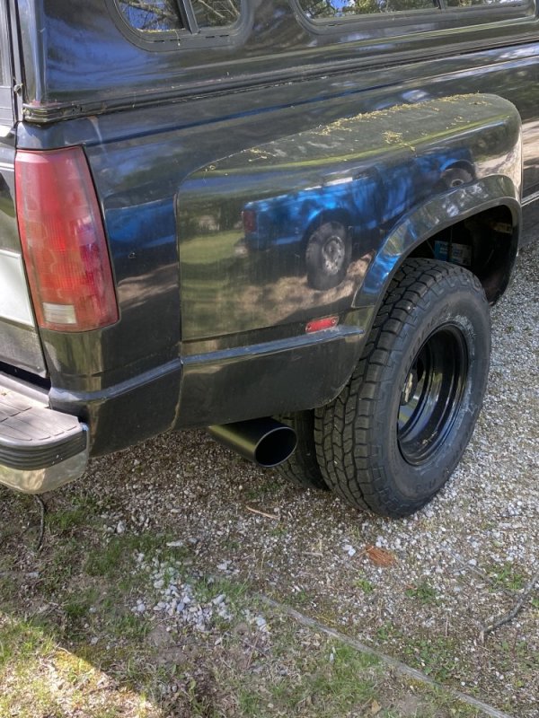

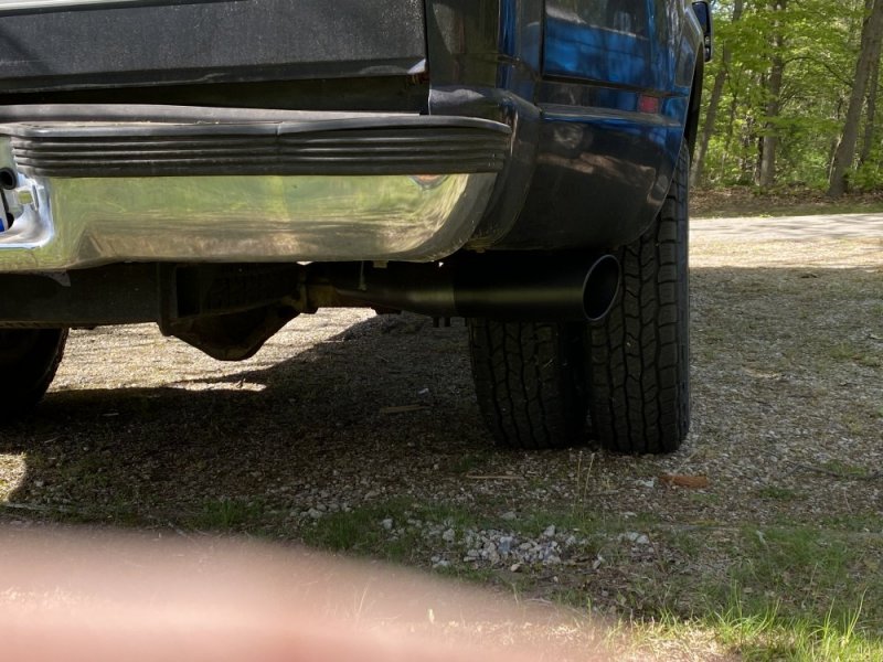

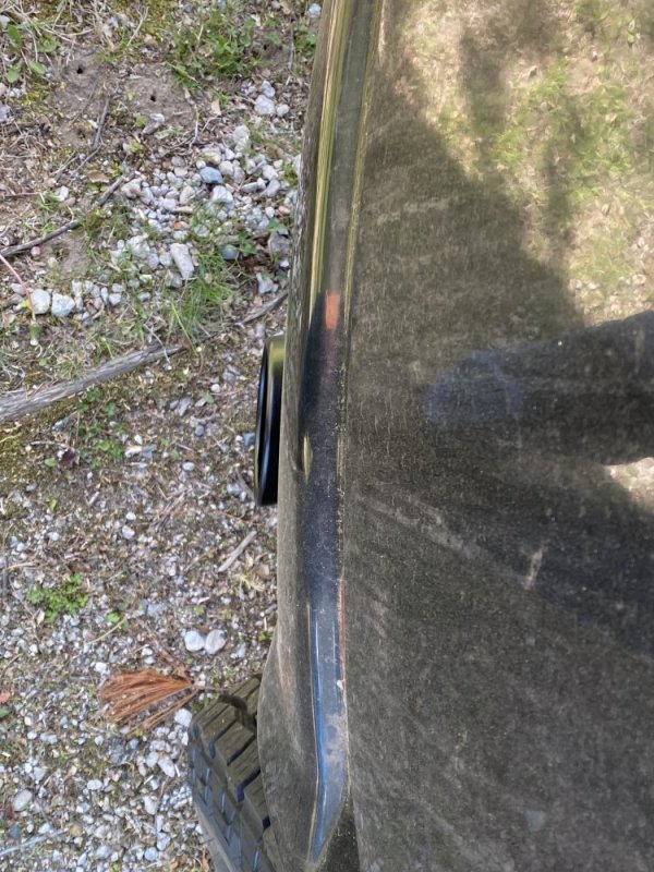

I’ve been working on some other projects for the past week and a half, so not much new to report. Tonight was mostly some cleanup so I can get back to work, but I did take a sec to install this exhaust tip I got off Amazon. Just something cheap to get me going. The exhaust did make more noise inside than I wanted so I’m hoping this tip getting it outside of the fender tones it down a little.
