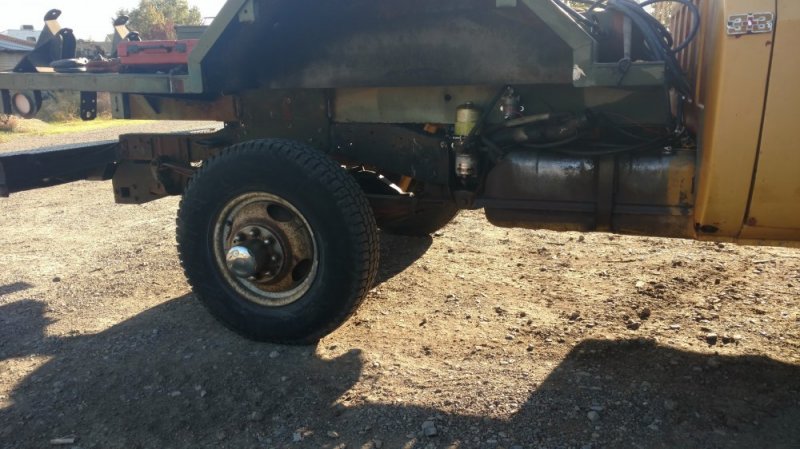

Is that fuel filter mounted upside down ?
Can't see it in the picture but at the bottom of the metal section there is a drain for the water separator on the housing, it's right side up. Wondered the same thing when I first saw it on the truck haha.

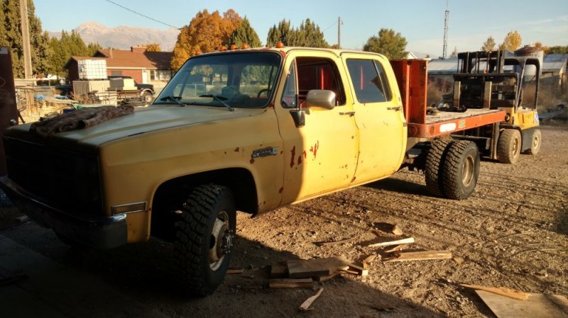

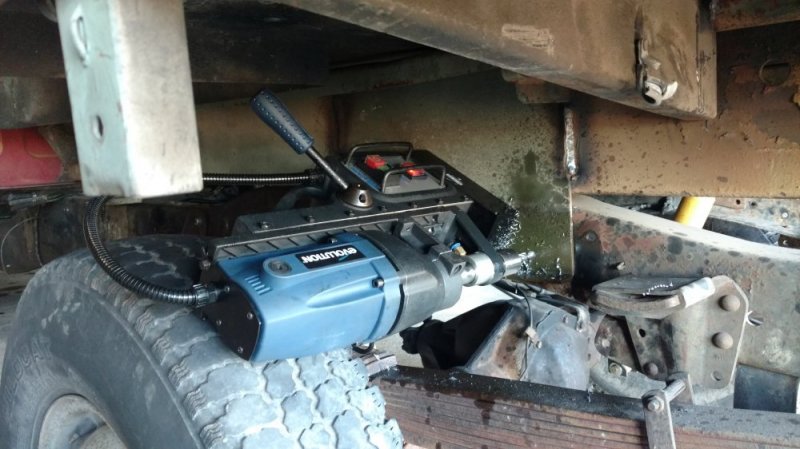

Was delayed with having to run errands today so didn't get as much completed as planned. But the entire deck of the flatbed is now attached to the subframe and the center mounts/frame reinforcement brackets are attached. Welded the mount to the flatbed subframe and used the mag drill to create the holes for bolting it to the truck frame. The welded section of the truck frame is in the middle of the plate (roughly).
Also, really wish I'd gotten a mag drill before. The little bastard is amazing!
Dude you ain't kidding. Mag drills are amazing. With the magnet you can mount that sucker anyway you want to. It works good with a drill bit or hole saw. I have one on my work truck and use it all the time on mill-right jobs. I wish we would have had one years ago. It makes a job much easier.
Good job on the truck. What you are doing with the bed is going to look tuff.
Had a mag drill at the shop where I worked. That thing was a real labor saver for sure.
It did not have a standard drill chuck, it used the rota broach bits. Talk about perfect holes. LOL
This one has the carbide cutters or can install a adapter for a standard drill chuck. Using the cutters, have sizes from 7/16-1". This model weighs about 18 pounds so it handles pretty well.

Installed new 60G glow plugs with amazingly no problems, none of the old plugs were swollen. Only current problem left with the glowplug system is that it kicks the plugs on again after the truck starts for the first time in the mornings. Thinking of going to a manual setup anyways since the 60G's are self limiting.
The old mechanical lift pump was certainly dead. Truck fired up alot easier after the FRB-5 lift pump install (before the new plugs). Has noticeably more power when driving now as well. Ended up plumbing the fuel filter assembly after the pump because it wouldn't suction through it. Could use a rock guard for protection. I like how easily visible the filter is, simple to check when it's dirty or if there's another problem.

Wiring is only temporary. Want to keep it organized/sealed well so adding a second fuse block and a electrical bulkhead fitting to run wires into the cab, instead of the usual grommet setup.
Glows should keep cycling after start for a time . This is called " after glow " . Now if they keep cycling or don't shut off , that is a problem .

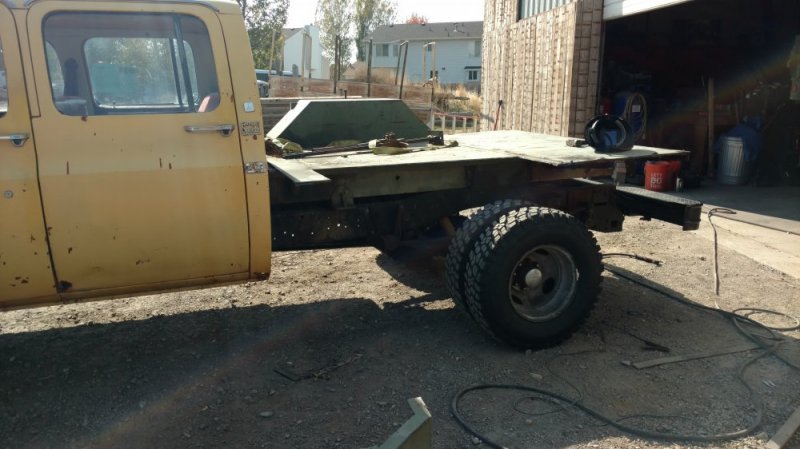

Got some replacement 235/85/16"s installed and had to widen the bed in order to cover the wheels. So those huge wheel wells finally got chopped off. Used some of the frame from the m51 dump truck as the outside edges of the bed. Need to buy some plate to fill in the holes from where the wheel wells were and finish assembling the main parts of the flatbed.

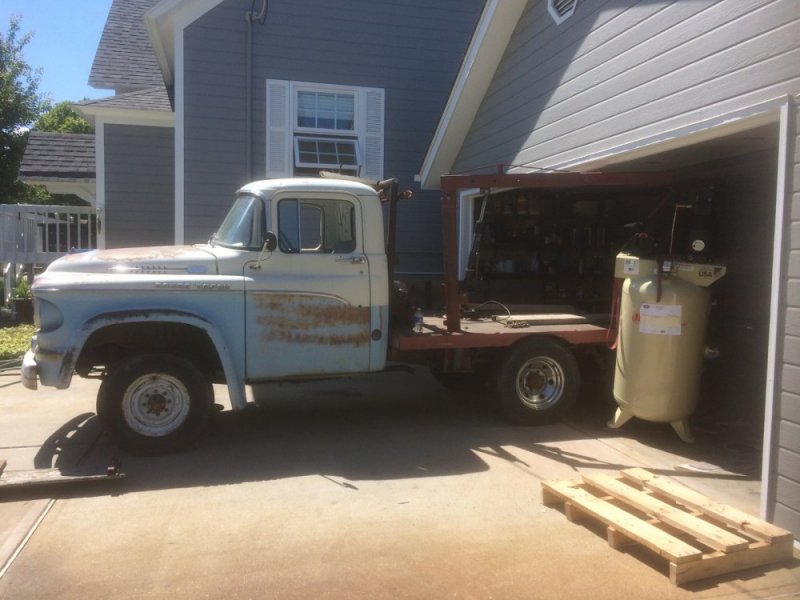

I did not put wheel wells on My 59 Dodge W100, instead I had a set of overload springs I installed.
When I installed a little wider one piece wheels I had to cut the beds edge rail to make room for the wider tires.
I now tink if I had installed a frame rail for more clearance it would have been a lot better. It works okay as it is though.
There is a pretty good load hanging from the side, other wise there would be quite a bit more clearance. The truck is a 1/2 ton, came with one ton axles from the factory but only 1/2 ton springs.

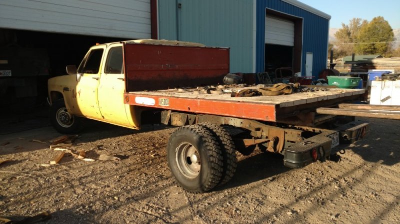

Well flatbed plans changed a bit. Was searching the local classifieds and found a guy selling a 1970's F350 with a 12 ft flatbed for cheap, and managed to buy just the flatbed for $250.
So chopped it down to 8ft long and have some of the mounts built for it. Will build the middle mounts/frame reinforcement plates tomorrow. Looks better in my opinion and saves alot of labor. The head board will be built differently later. Same with the rear section and the bumper will be deleted at that point.
