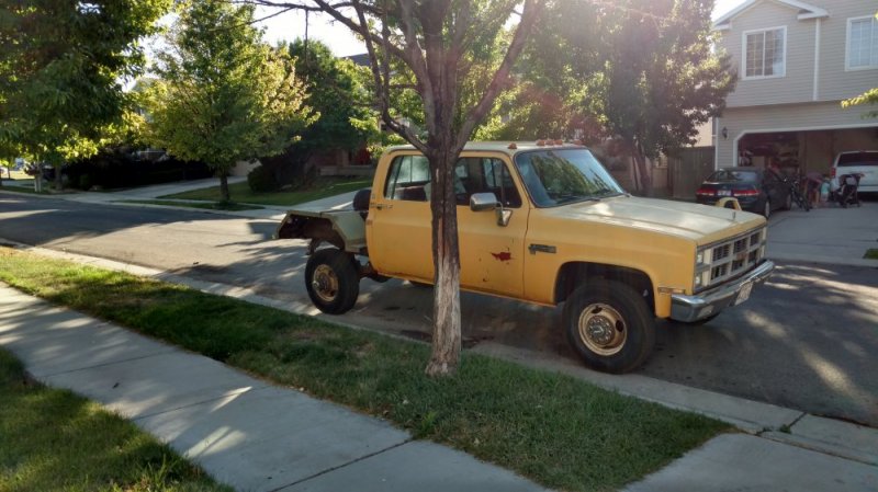

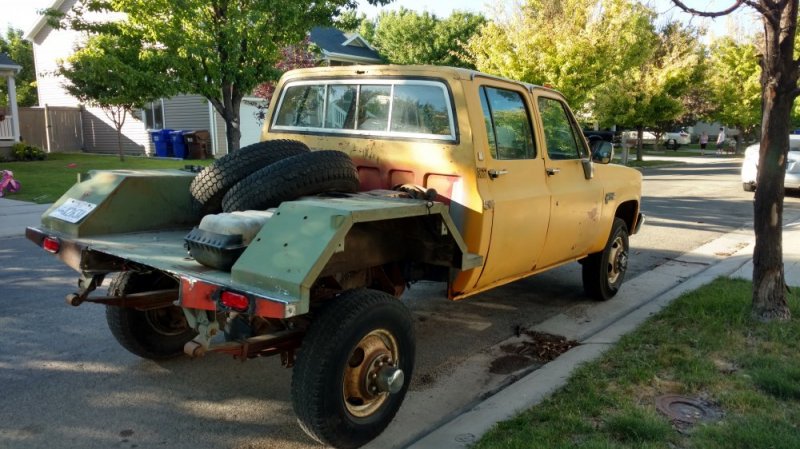

Pic since photobucket has changed their policy. Added reverse lights and a license plate light since these pics.
Thankfully, the project was not completed yet and hasn't cost me much $$$. 2 weeks worth of work to get it cut and driving, about half of that being rivet removal and old wiring that had been hacked up pretty badly. To put the truck back to full length only costs me time, about 1 week to get it back with most of that being bed work. Going back to a longbed saves the cost of driveshaft work, fuel tank, material for shock crossmember, parking brake cable. Gain a usable bed size again and I'm used to driving long trucks on and offroad.

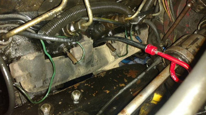

Also finally got around to fixing the CDR plumbing. Previous owner had installed a PCV valve into the valve cover, tied into the hose leading from the bottom of the CDR (no clue why). Which helped on 2 things.
1. Engine is no longer leaking from the oil pan gasket or the oil fill tube on the timing cover (only leak now is the dipstick tube).
2. Turns out the oil pressure gauge does work. Was always pegged at 80 with the engine running before so figured it was a wiring issue. Nupe, it's moving now.

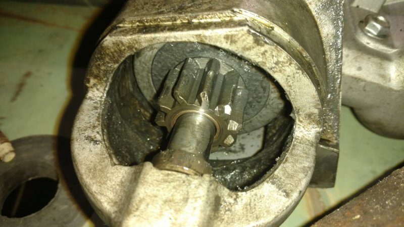

Pretty sure the starter decided to shred some teeth, hopefully not the flex plate. Starter is still bolted to the block and has it's brace.
So good and bad news. Pulled the starter tonight and it's teeth are screwed up, but the flexplate teeth look ok.

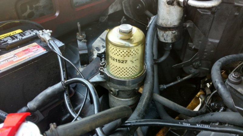

This truck doesn't have the stock fuel filter assembly, it's a different unit from Detroit Diesel.
Looks like I spoke too soon. Went to start the truck a few minutes ago and it's grinding again. Flexplate is gonna have to come off, damnit.
Picture of the fuel filter assembly.

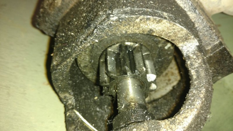

Couple pics of the damaged starter compared to the spare unit from the cheap donor 6.2.

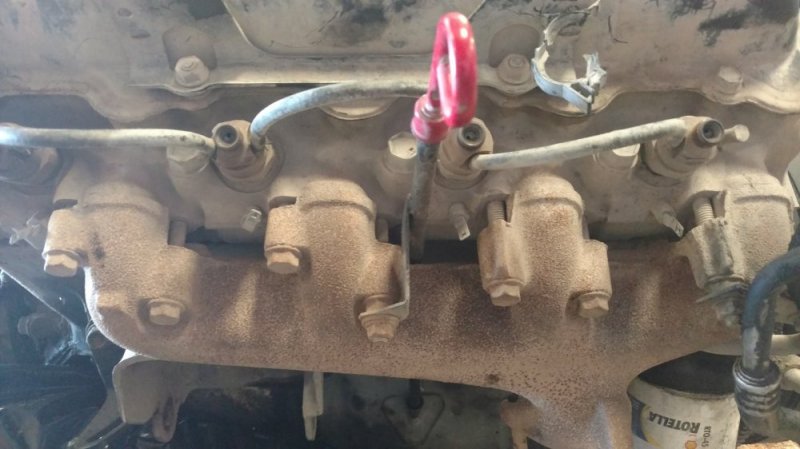

Wanted to do a quick swap of the dipstick and noticed that it won't be a quick swap. The engine in the truck has the wrong exhaust bolt there to hold down the dipstick tube. Hooray.....

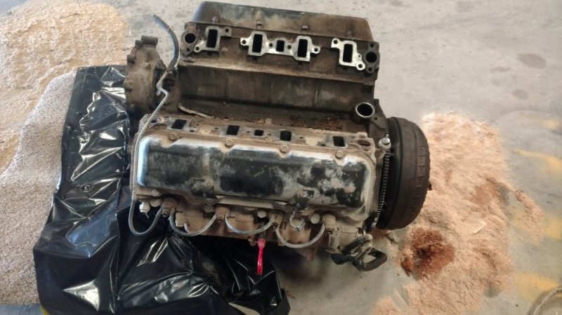

The partially disassembled donor engine. Debating on opening it up to fix the problem and have a spare engine on standby.

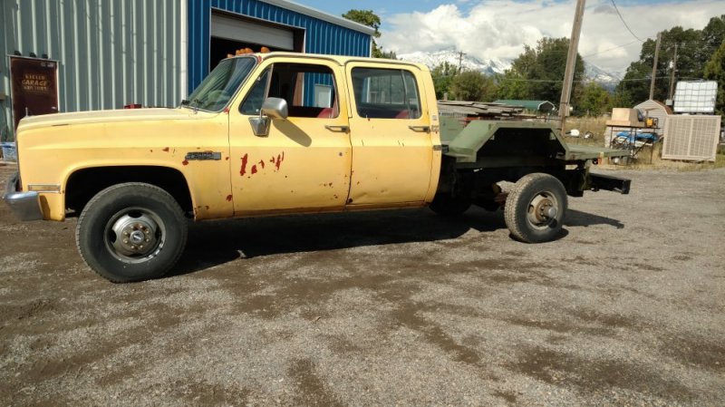

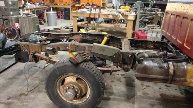

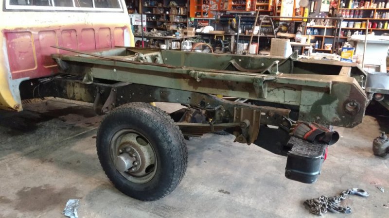

Over the last 3 days have been pretty busy working to put the truck back to full length. Frame is reattached, shocks, brake lines, parking brake, axle moved, suspension back to stock, passenger side fuel tank mounted/plumbed/wired, lights moved (into the rear bumper until the flatbed is finished). All that's left is the rear driveshaft needs a new ujoint before it goes in, and the flatbed needs to be assembled.
The frame reinforcement bracket is just sitting on the frame in this pic.
Spent alot more time than I planned trying to figure out how to setup the flatbed. Still planning to use most of the bed from the m103 trailer I cut up but the problem is it has no underside reinforcements and sits flat on the frame. So when the axle moves up it would come in contact with the bed on even the 235/85/16"s. Then remembered one large piece of metal I had in the scrap pile, the sub frame from a old military 5 ton dump truck bed. It's 7" tall so I'm thinking of notching out the bottom of it to follow the truck frame along it's 2" curve, bringing it down to a 5" rise for the bed.
