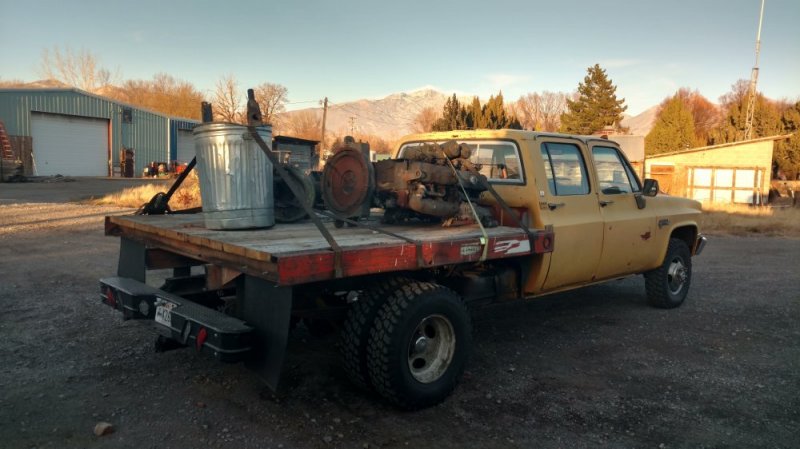

Been making multiple scrap runs with the pickup. Each load so far has been right around 2000 pounds with the only problem being the worn out/and a few broken rear springs. Going off the scale at the scrap yard the truck weighs 6760, and has a max weight rating of 10,000, so technically a 3240 lb payload capability.
That locked up engine is a multifuel from my old m35a2.

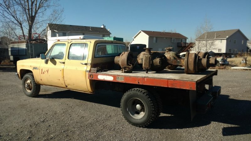

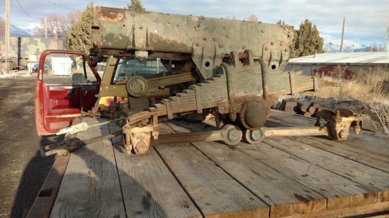

Took another load of scrap today, 2380 pounds between 2 axles with no shafts. For the rear leaf springs being done (worn out driver side, 3 broken on passenger) it's holding the weight well. Need to be replaced though. 1 more load of scrap to go.

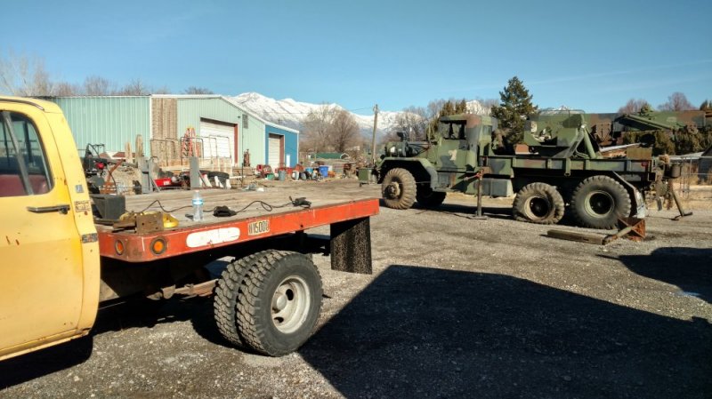

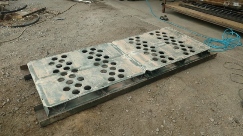

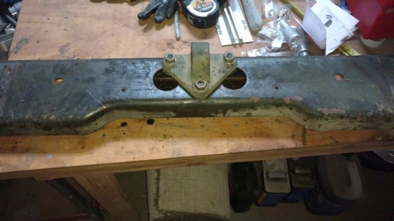

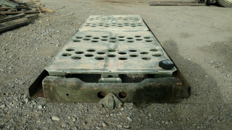

Quick project built today, the cargo skid. Once the roller is added to the end of the bed I'll be able to secure items to the skid, then use the bed winch to load/unload the skid onto the truck. The skid is going to live kind of a rough life so no plans to make it fancy.
Used 2 8ft sections of frame rail from the old military dump truck to serve as the bottom supports, and a crossmember to be the front lift point that the winch will attach to. The 2 steel pallets are there to provide a platform to easily lay whatever cargo onto it. Those pallets are tack welded onto the frame rails. Going to add some tie down points along the outside edges of the frame rails.

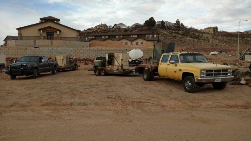

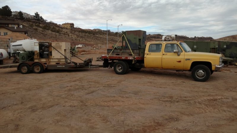

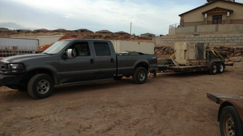

Just got back from a trip to St George, Utah again. Loaded up some 60kw generators that were sold and 1 10kw gen as well. Complete 60kw is about 4300 lbs, the 10kw is a little over 1000 lbs. Both trucks were around 17-19k.
The 60kw remains that are on the bed are missing the engine but the actual generator is inside the box, so 2-3k pounds.

Couple hundred pounds worth of oddly shaped scrap loaded up today. Pulled off everything that is useful to me (the suspension bushings are shot)
